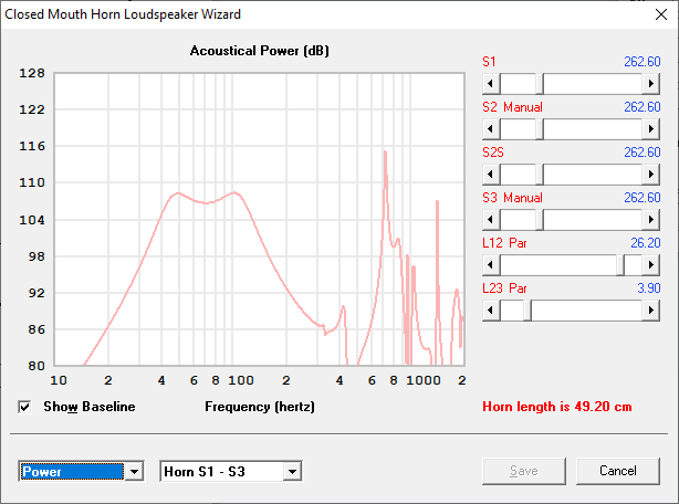

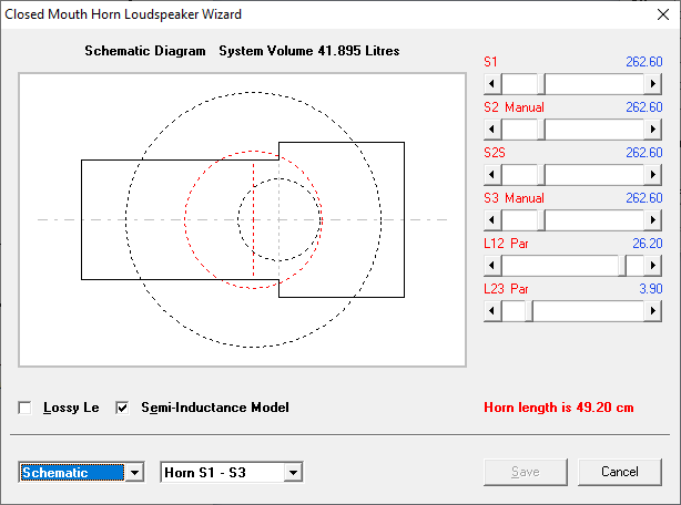

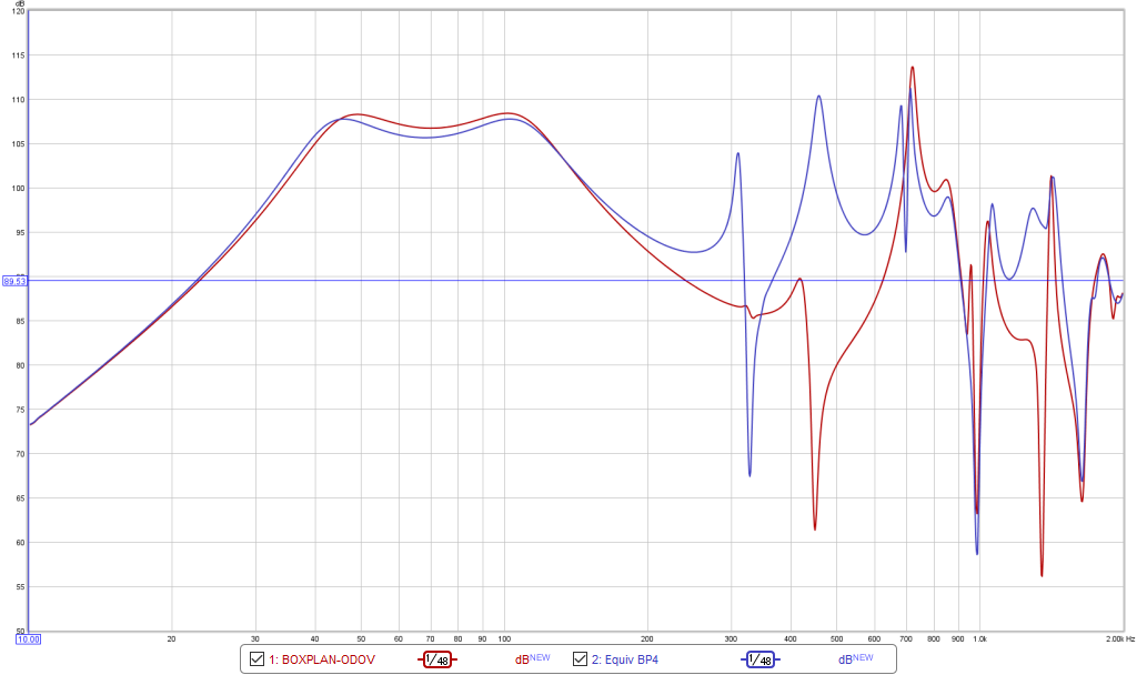

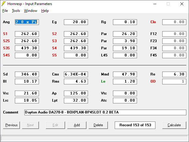

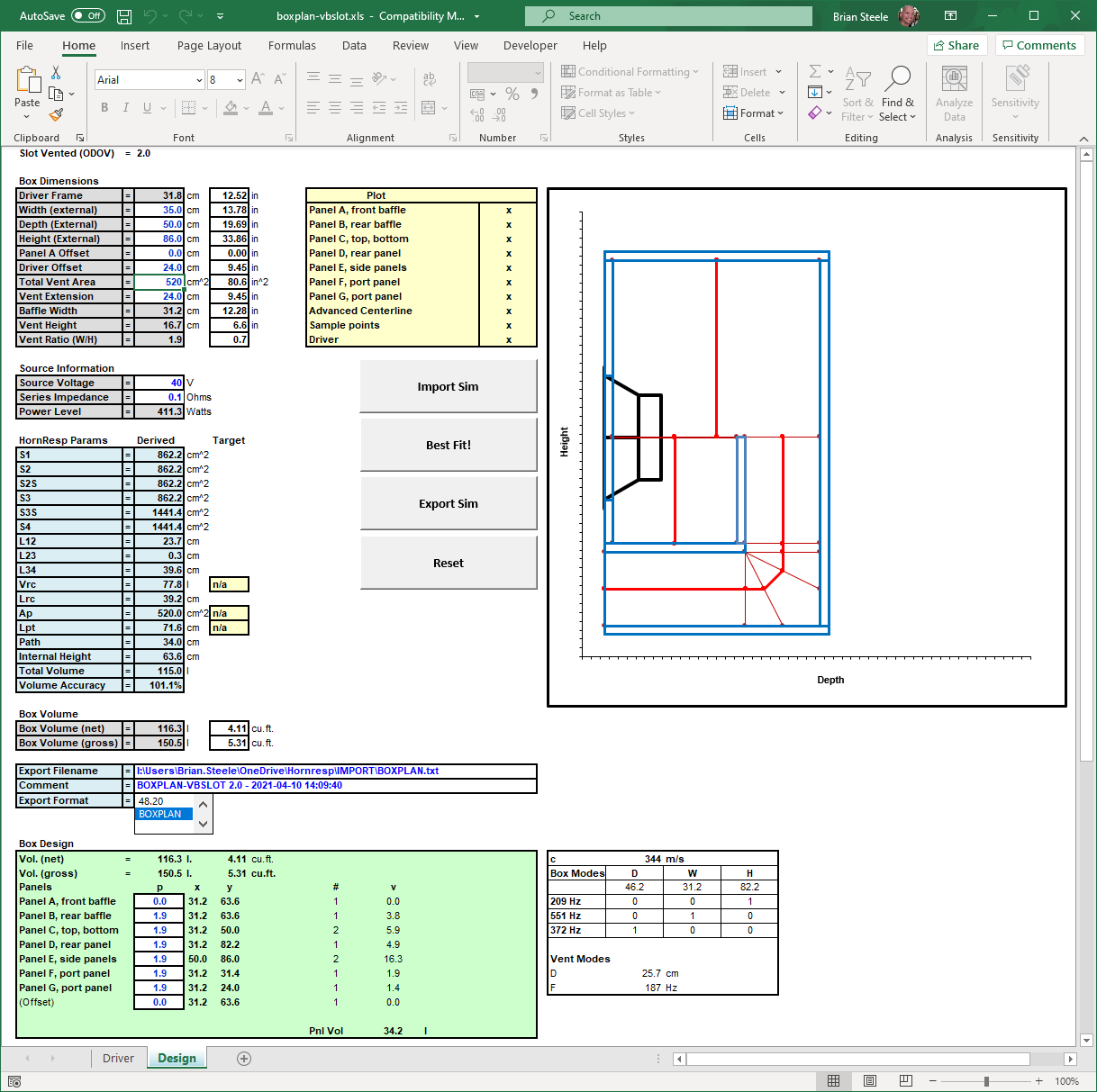

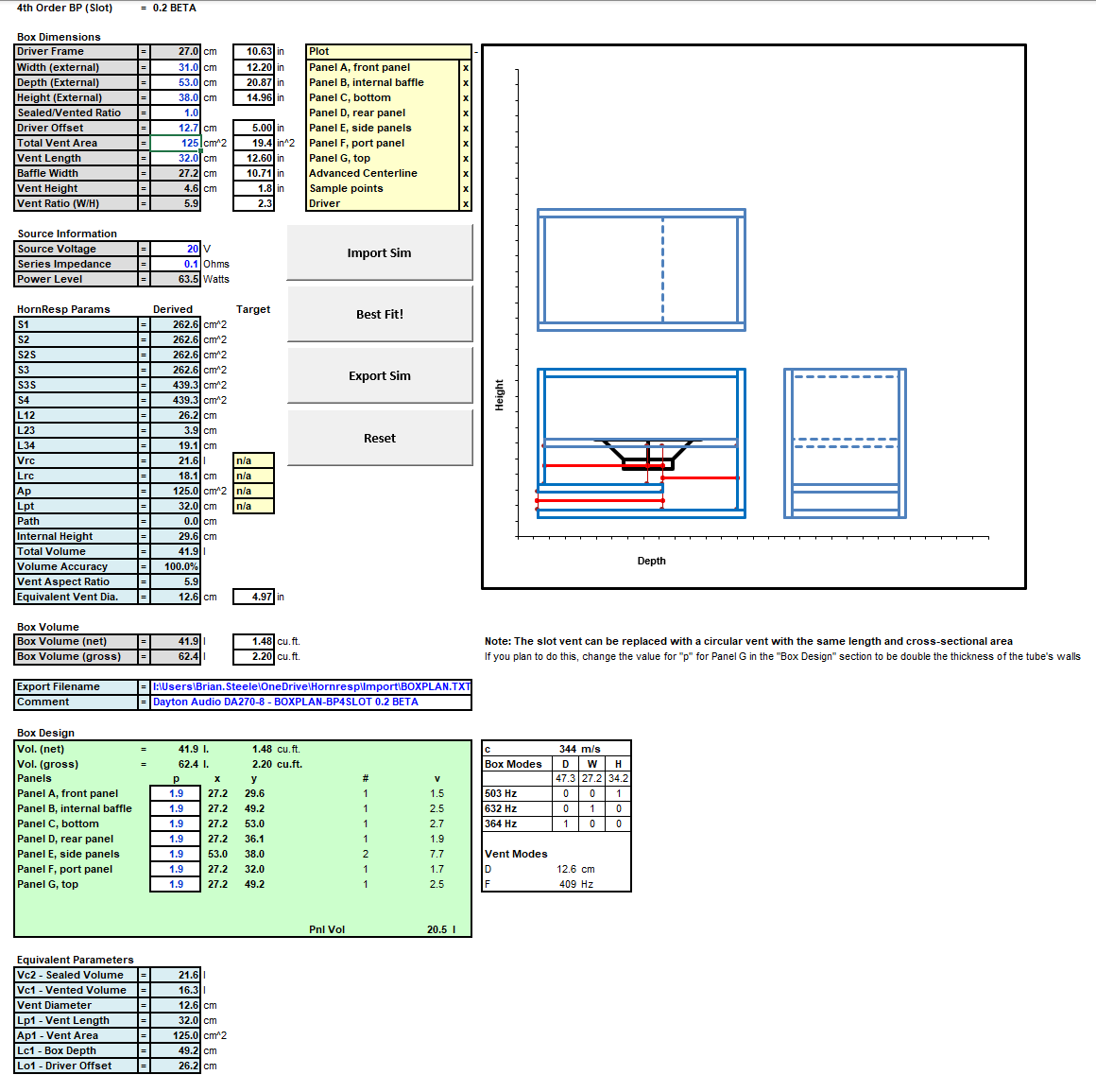

Introducing BOXPLAN-BP4SLOT, a workbook that can be used to sim slot-loaded 4th order BP enclosures, using Hornresp's "offset-driver, offset-vent" model. This should produce a sim that's a bit more accurate than the BP4 model as the volume displaced by the vent and its location in the vented section of the box is taken into consideration.

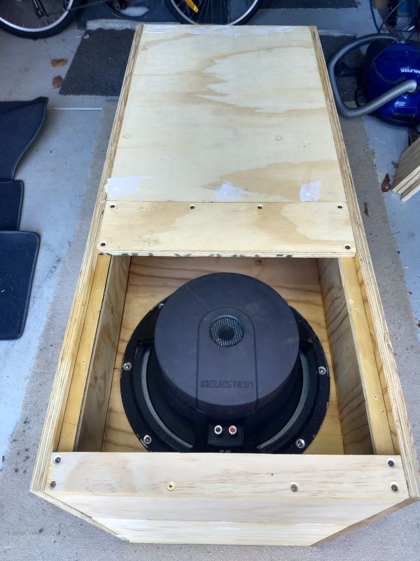

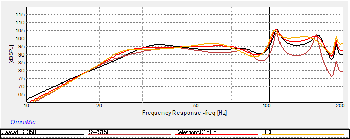

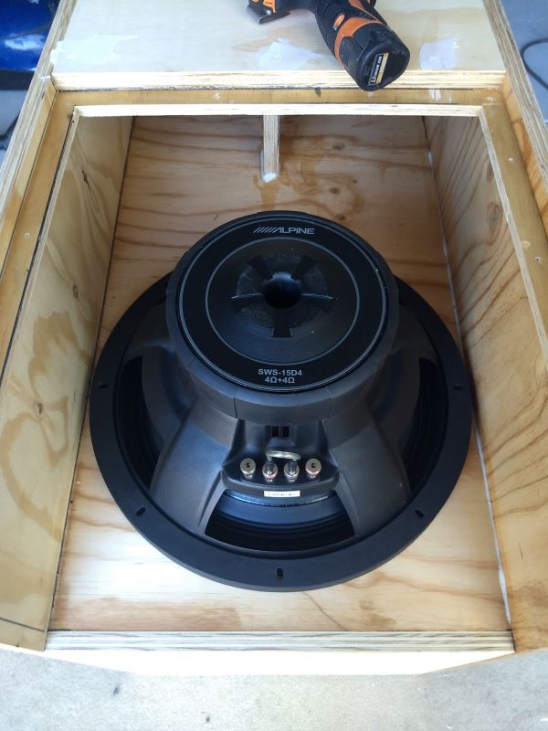

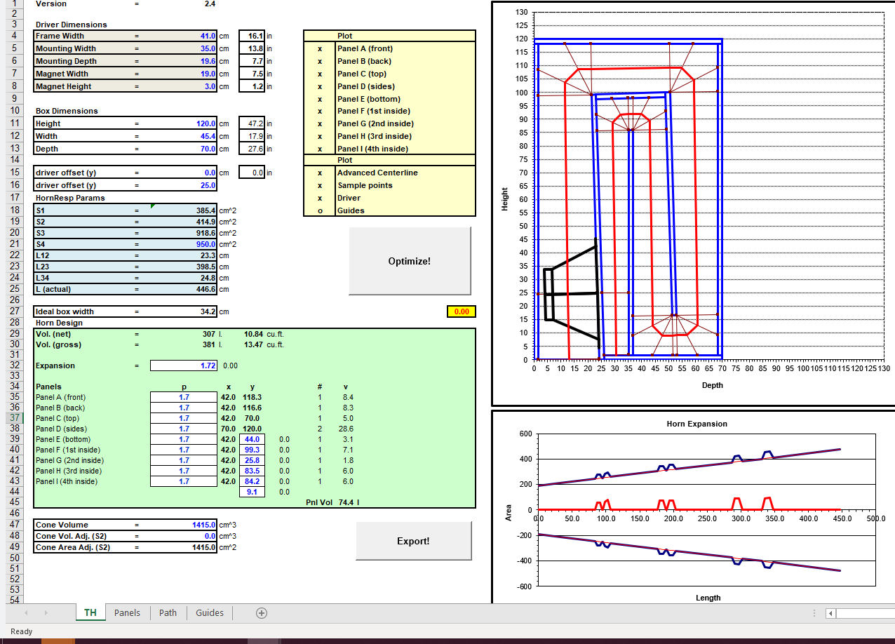

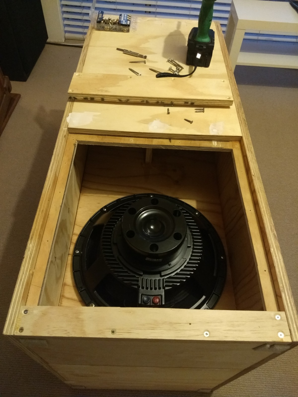

Some time back I went through all the box plan workbooks to see which path design yielded the greatest low end extension (path length) from the fixed floorspace I had in the corner of my lounge room to build a home theatre orientated sub for a 15" driver.
That turned out to be the Boxplan-MTH.
I was inspired by and aimed to create a passband similar to a well regarded tapped horn based on a 15" driver . These are more than $10k in Aus. I did this by estimating the path length and adjusting the height of my MTH till I had the passband I was aiming for.
This resulted in a box with a volume of 266 litres and a path length of about 450cm.
As an aside I tried 4 different drivers in my MTH:
  1. Alpine SWS15D2
  2. Celestion AD15H
  3. RCF LF15N451 and
  4. Jaycar Response Precision CS2350
All have very different specs, all worked (IMHO) really well, i.e. you can see the Hornresp modelled and ground plane measured differences, but in room, they all sound (to me) indistinguishable.
Perhaps the uber expensive RCF has the best "punch" - it is optimised for a horn application, but plays no louder than the Alpine that I picked up second hand for $90. That's the value of more Xmax, as I understand these things.
Tapped horn fun - which for me would not have been possible without Brian's fab Boxplot workbooks.

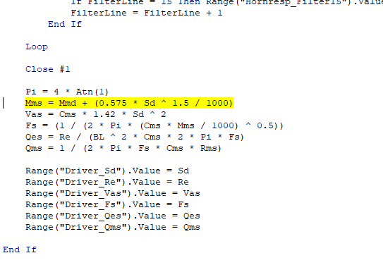

Hey

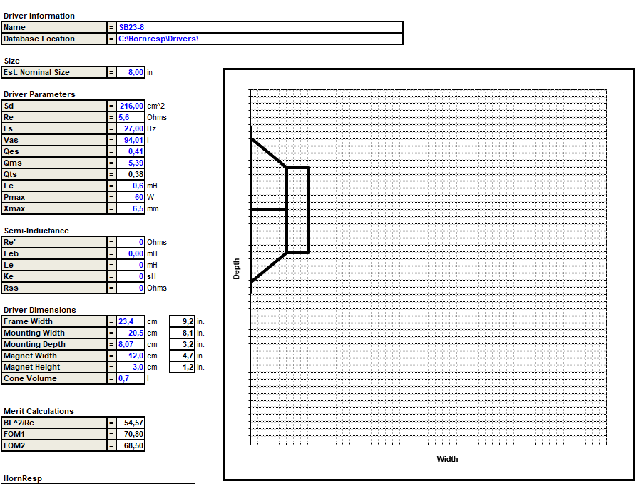

I bought a SB23NRXS45-8 and I'm interested in building a TL sub out of it.

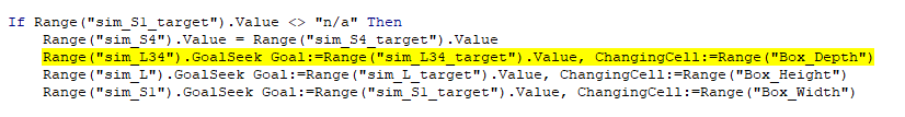

I have tried filling boxplan-mltl manually and from a hornresp driver but i get an error saying there is no mms and when i go to design tab and click "best fit" i get a runtime error.
Any ideas what am I doing wrong?

I filled all the size, driver parameters and driver dimensions by hand and also tried by importing driver from hornresp. still got the same result when trying to import on design page.
