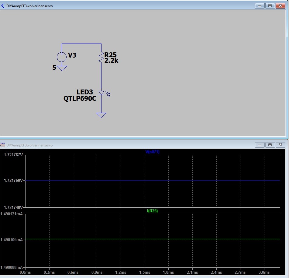

how do i make sure the red leds are at the correct spec?

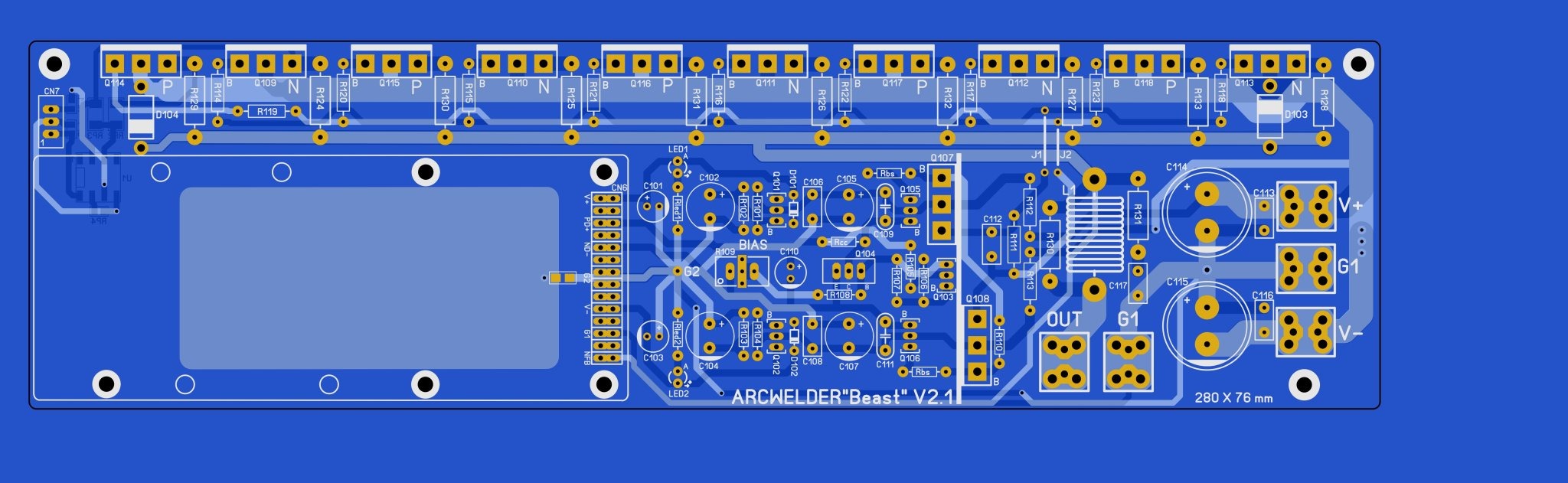

.how many ounces of copper should be specified in both IPS,OPS boards?
DMM with hfe tester is close.
LED's? (below 1) , just power up with 5V + a 2K2 resistor . Anode of LED should be at 1.7 -1.9V.
I included 3 SMD values in both the Spook and hellraiser for their CCS Re's.
2 oz. is standard.

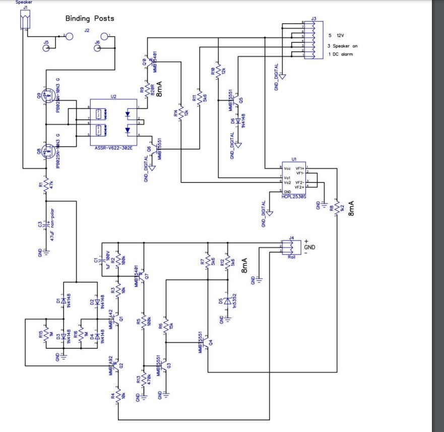

Looking at JWilhelm's DC protect V4.3 (below) , it could be run independently (without the MCU).
Just add a 12V regulator to run it off a rail and trigger "speaker on" with a simple 5 second timer.
The overcurrent opto output on my OPS's could even be routed to "speaker on". Fully analog current/DC protection !
Of course , add jumpers to undo this for full MCU operation.

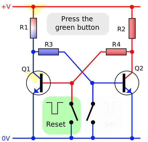

Some weeks back I had a look at above circuit, and was under the impression that only the mute is run by the MCU, while the DC-protect is already autonomous.
But , I would want it to be re-enabled (made original) if and when I wanted to go full MCU. Yes , 2 bjt flip- flop for the reset.It can run standalone but it needs a latch to keep it off in case of DC. No use having a faulty amp reconnect itself to the speaker for another chance at frying it.
If it were to be fully powered from the amp's supply the HCPL2530 wouldn't be needed
The detection circuit is pretty standard. The speaker relay is nothing new either. It might be neat to make this a full standalone protection system.
Timing is easier for me to do in the digital domain. Adjusting time is much faster adjusting microseconds than recalculating RC circuits and swapping parts but this could easily run on it's own.
It's not that I don't like the MCU. 5 second timer is a simple RC circuit. Could even simulate it....
Q103 and Q104 are not listed in the BOM

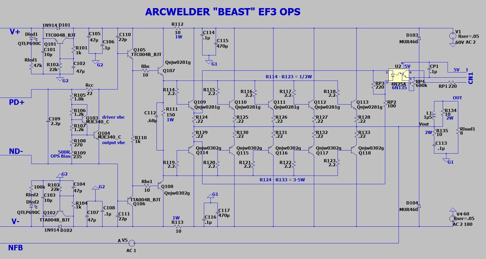

Yeah , I don't want to go back later to find I should of done something differently. Like the "Beast" EF3 (below) , added base-stoppers for the bigger
drivers , and definitely added the opto for protection.
So , the "Ducks" are in line to integrate anything with anything else.
To get the "ecosystem" standardized will make future additions easy.

Analog is all 4 IPS's (spook , hellraiser , infidel , and symasui). Infidel is based on the Wolverine , symasui is based on the old slewmaster symasui.
99.9% chance they will work perfect.
And the 2 output stages (arcwelder mini and beast).
