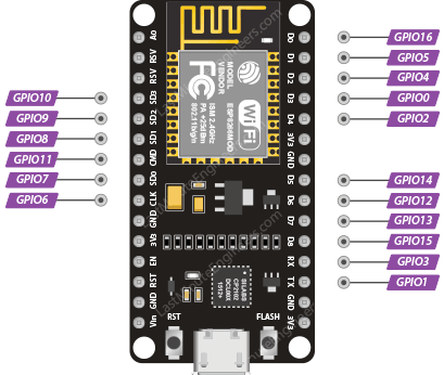

Just jumping ahead , besides (the onboard thermal ... I want to keep an external I2C port for the cool display. I see many a library that will let you
"tag" an interrupt (or address) with your choice of text.
Eventually , mate the protection and even a preamp using a ESP8266 (below) - these are getting $5'ish cheap .
OS

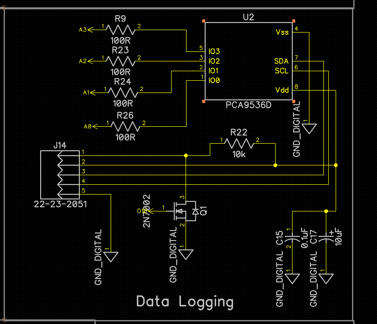

There are spare pins available on the board but you would need to tack wires onto the pins on the microcontroller. These pins connect to a PCA9536D port expander that is powered by the front panel display. These expanders do level shifting for you so the display controller can run at a different voltage than the control board (ESP32 or whatever)

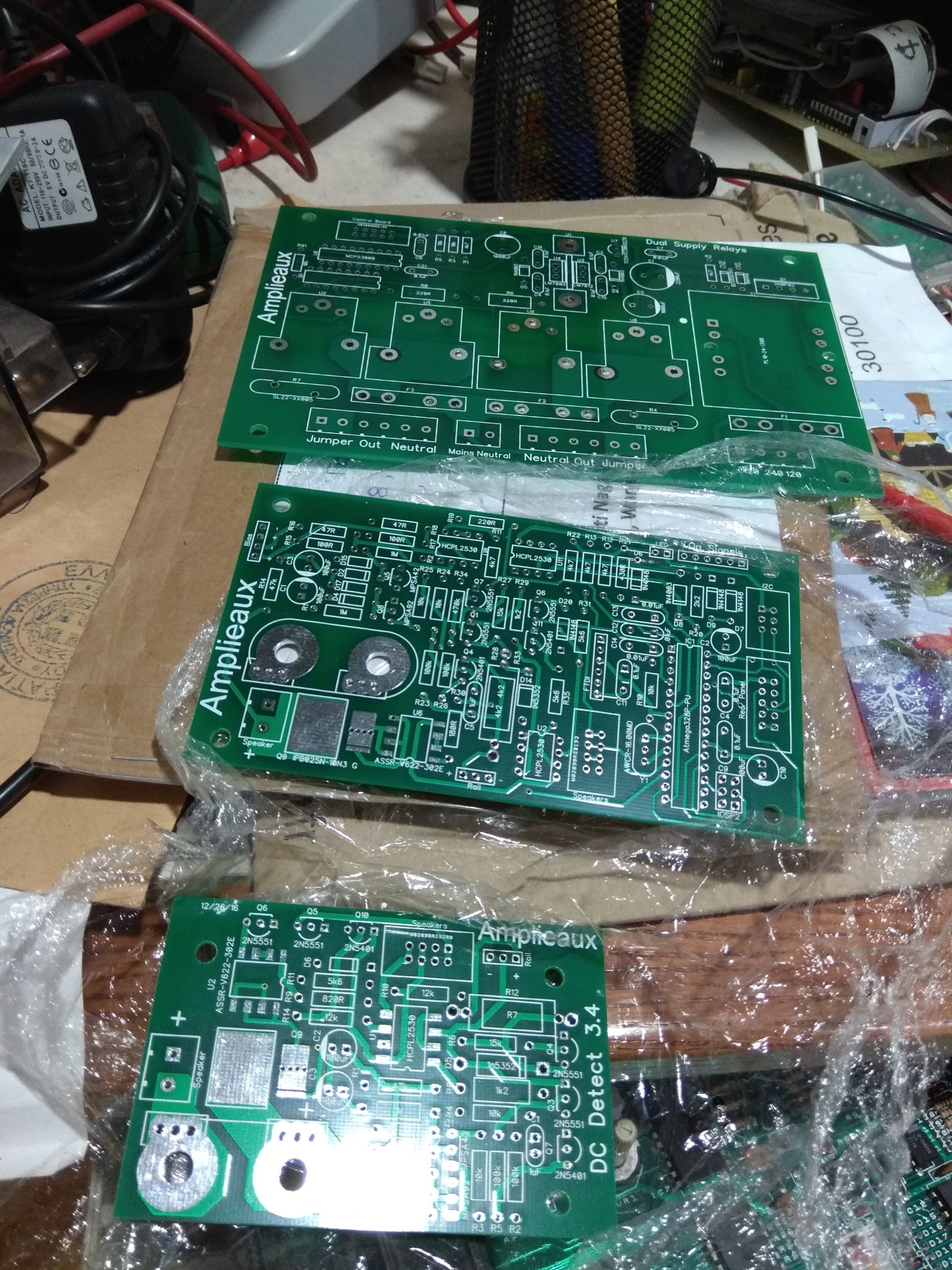

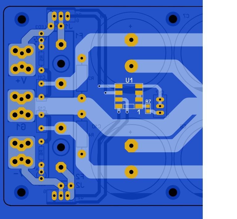

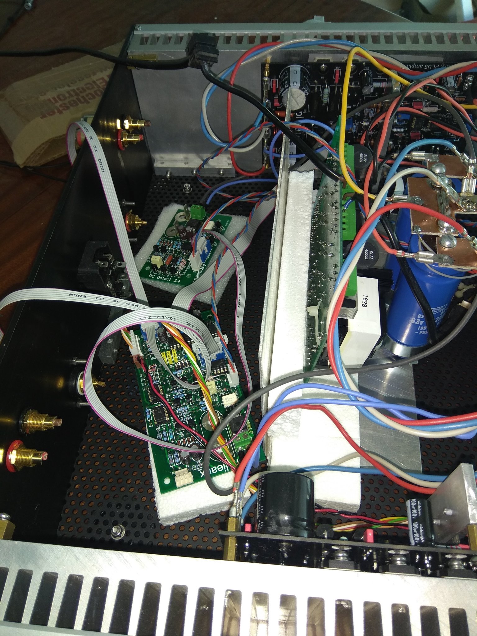

I'm going to complete this ... power-board with MOSFET shutdown is packaged "arcwelder_power_package.zip" (with BOM).
"mini" EF3 is almost there , just need to shop the big semi's. OPTO is integrated on both with 3-pin (gnd/5V/control pinout).
Both SMD addons to these boards are optional on boards and the BOMS.
I might as well make a separate softstart module with the relays, resistors. Same basic opto control with 3 pin connector.
Control board will have MCU with as many digital outputs as I can (use) , I2C port expander and raw I2C port for expansion.
Pack the regulators under the nano's dual SIP connectors and power with small SMD bridge and filter caps. No trafo , one of my
trafo's has a nice auxiliary 1A 15-0-15V secondary,
OS
Output protection mosfet outside of the amplifier board?
I see opto isolator only🤔
Yes , right at the output terminals. That opto is just to trigger overcurrent and not have output Re signals run all the way to the control board.
Just a single 5V/grnd./and output. Same with the power board and soft-start (5V/0V/I/0 +ac sense opto). No clocked digital IC's on any analog board. Only
dumb analog $hit on a analog board.
Digital board - all digital. Arduino works nice on ESP32 , loads right through the network ! Plus , port expander and I2C port. Trafo will be offboard.
ESP has many extra I/0's , run them all out to connectors (with a pullup) to make for much "tinkering" !

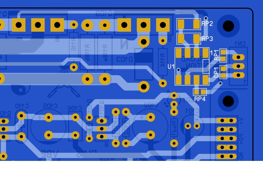

I'm real close on the mini-ops. There are changes in the layout , as well. Added the SMD (option) for protection and I am really getting "picky"
on the research for the semi's. Mini should be done today.
I am also re-doing the big "arcwelder" , larger 1K+ uf caps and 6 pairs output. I will fine tune it for either sub use or just a monster 500W precision
output stage.

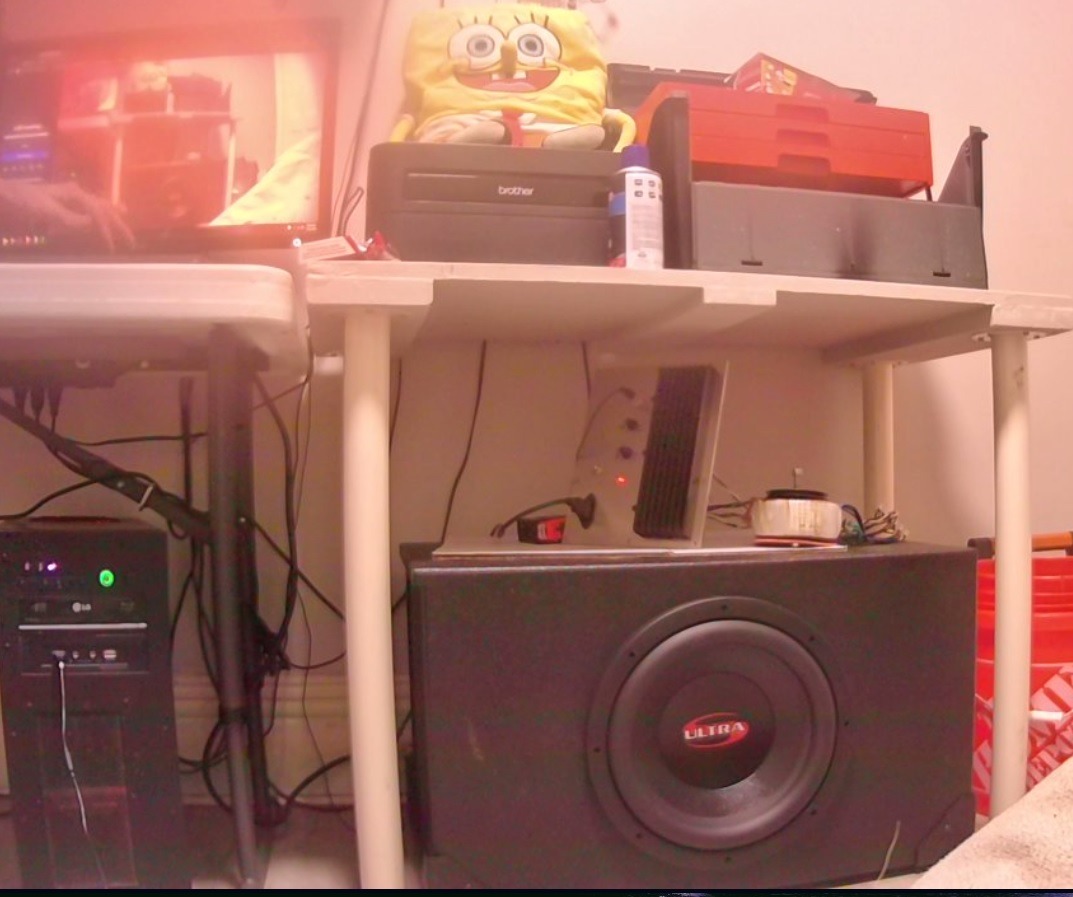

PS - I need to power this 1KW sub , oooh it sounds lovely !!!

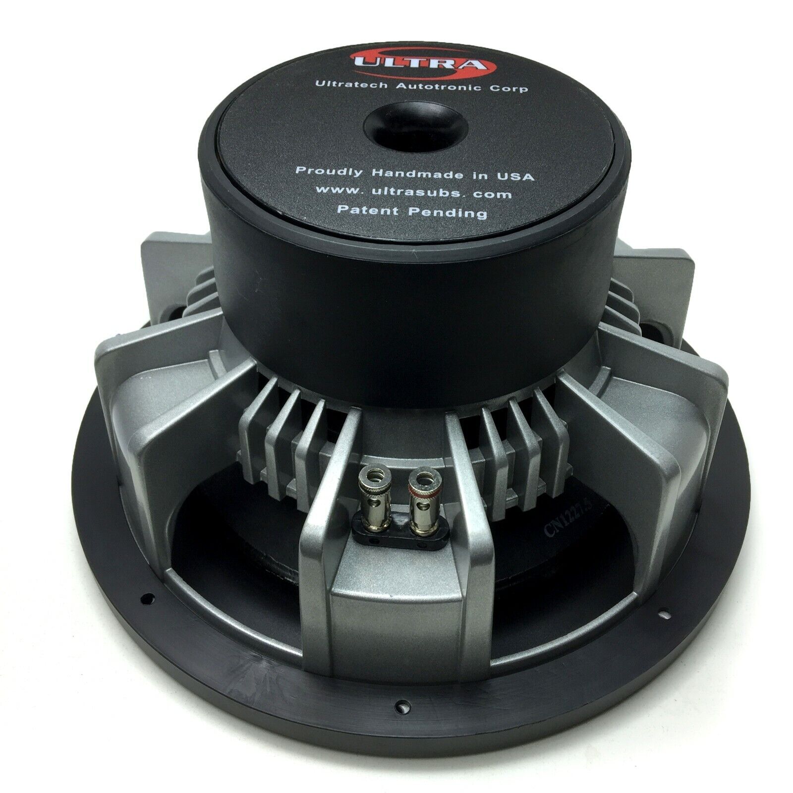

That's what I thought about the above driver (boom ,boom). It actually has 90db SPL and a very high SQ for a car sub. I tried quite
a few subs (car subs) , most sound like plastic chinese pistons with low spl (82-84). This one will do a VERY low THD 20mm p-p with
my present 200W Spooky. But , I only have room for 1 sub .... I want the best with the 30+mm Xmax.
This one sounds so good , I have been relistening to my FLAC collection , really amazed at how much better this is compared to a
typical OEM !! With TV or average music use ... the bass is sooooo smooth and deep - tuned the box to 24hz , perfect !! It is sounding
even better as it breaks in. Not as stiff (higher VAS) as many other (boom-boom) drivers.
PS - a nice 300W+ AB amp should really make for a perfect setup. I got 132DB SPL at 200W !

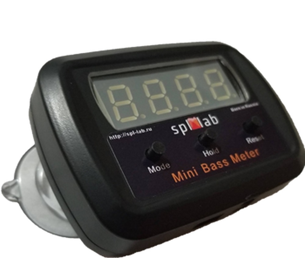

I like bass too but in proportion to the rest of the music. I have some 15” woofers in a 3 cu ft sealed box, I like the response of them, make the kick drum sound more real than other speakers I have that are tuned ports.
What’s the alignment for your sub?
I do wonder about claims or requirements of low THD for a sub, how does one determine the THD? Or even the spl for that matter?
Lots of things I wonder about 🙂 like why one needs hi res audio for a sub?
Rubber surrounds and a more flexible spider make for a lower THD sub , there are many spl meters that have timers/spl/thd - www.sonicelectronix.com/item-195485-SPL-LAB-MINI-BASS-METER-V2.html
I also did not think it made a difference till I tried this sub , I was wrong....
The Xover and phase is also crucial for good SQ , my sub xovers at 75hz and I shift phase -30 degrees.
