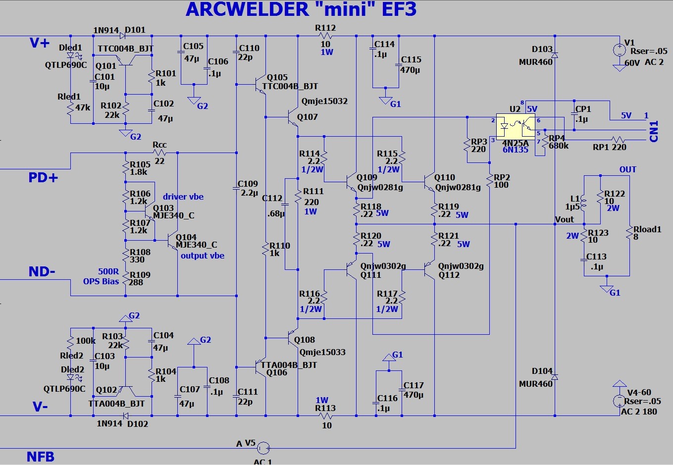

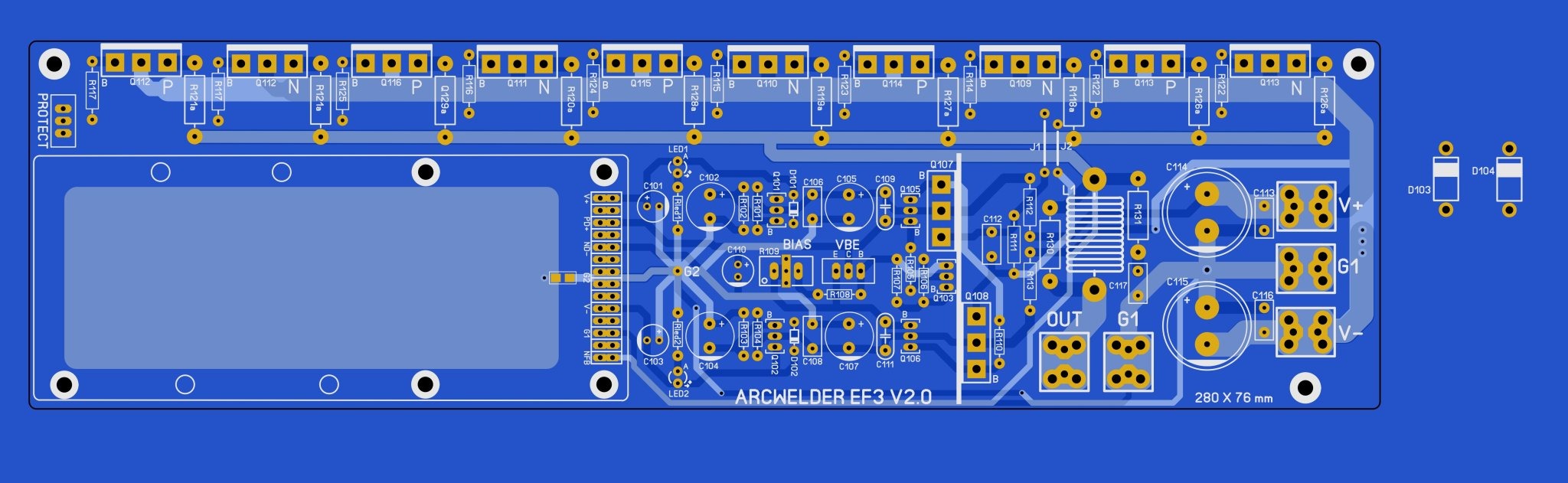

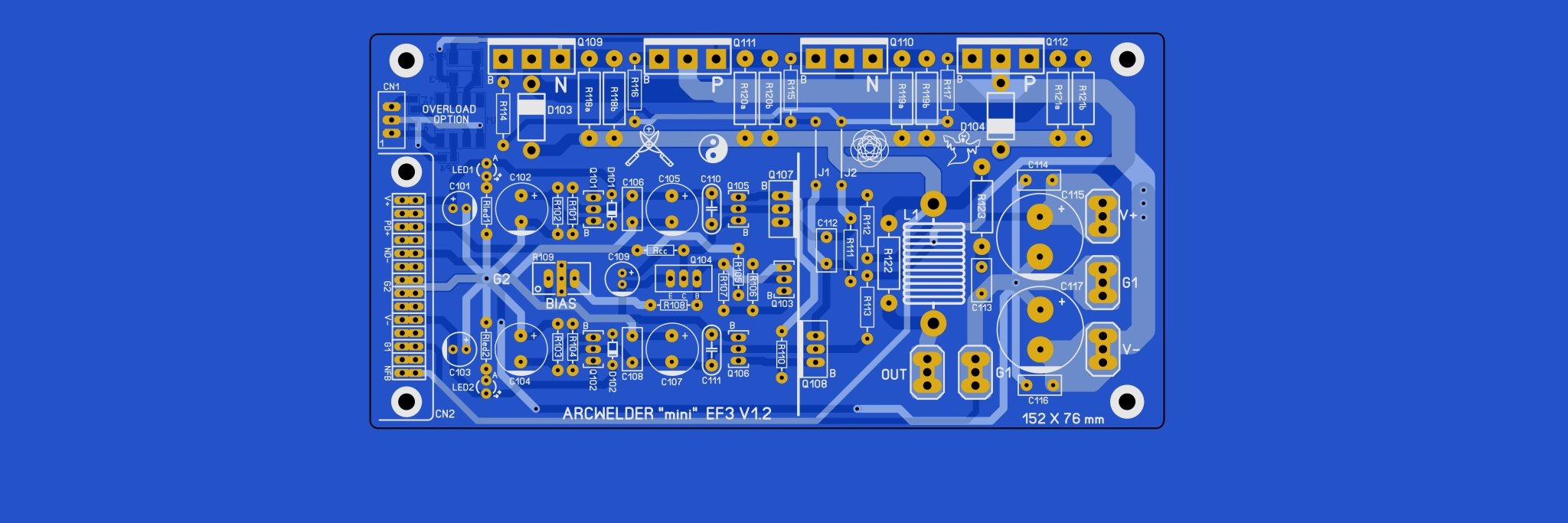

"Arcwelder mini EF3" is fully done with BOM.
1. Added "Rcc" - the Vbe smoothing resistor (below). Really fine-tuned the layout.
2. The Opto addition is permanent , protection is important.
3. No small holes , I saved money by not using the "preci-dip" 6$ 2X14 female. The Wurth 3$ one is better. But , the hole is 1mm.

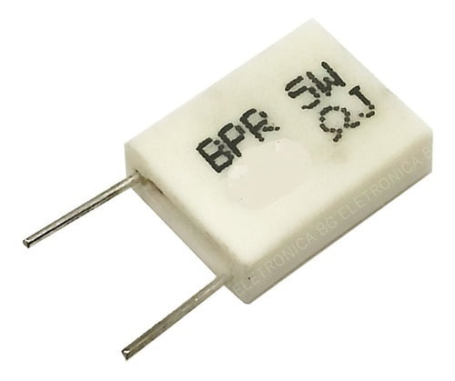

Here is the big amp. Think (5 pair) Toshiba TTA1943/TTC5200 will run a 500W-4R sub ?
Those Toshiba's are 20.5mm wide , just 3mm between devices is left. Emitter resistors can be those
"classic" 3-5W ebay ceramic devices (below). I've seen those as cheap as $.50 each.
They do make 12.5mm LS ceramic (non-inductive) but charge "audiophile" prices for them ?
At least Digikey/Mouser have those cheap outputs - ($2.70) , I noticed a shortage of ONsemi (NJW/MJE).

All of it , I am personally using this design for my sub. The "Wolverine" only uses TO-220 as drivers. I might want toNow that is the beast I was hoping for, thank you. Are you posting Gerbers and asc?
run a 2R load.
PS - I'm going to add base-stopper pads for the drivers and a few super fat traces to make this "sub friendly".
mouser will have the NJWs OPTs next month, would you still specify the toshibas if the NJWs were available since you originally specified then in the schematic?
Spec wise -mouser will have the NJWs OPTs next month, would you still specify the toshibas if the NJWs were available since you originally specified then in the schematic?
Toshiba -
-larger surface area (TO-264)
-lower Cob (200/320pF)
-cheaper
-About the same SOA (current).
- "O" grade is typically >100Hfe , typical 80 @ 6A ... not sure what 60V would be (never used them).
ON semi (NJW) -
-smaller package
-higher Cob (400pF+)
-pricy and OUT OF STOCK !!
-No specs about Hfe (at 60V) , most were 50.
Never built anything with the Toshiba's , they should perform exactly like the ON NJW's.
I'm not sure what grading quality Toshiba has , ON (NJW) was not great with my slewmasters.
I would always need to go through a pile to get anything close with some left over.
For some reason Toshiba describes the 5200/1942 pair as "Recommended for 100-W high-fidelity audio frequency amplifier" ?
The NJW's , I would not rate a single pair EF stage for >60W. My HK has 2 pair and it is rated @ 105W/8R.
They should be the same if you interpret the whole spec sheet , one would sub the other (besides package style).
I'm cheap , 37$ for 15 devices ... why not ?
Edit - lower Cob would equal a .47uF C112 (suckout cap). Otherwise, no difference.

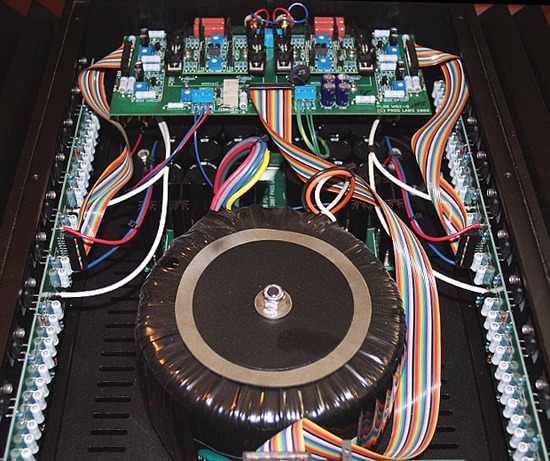

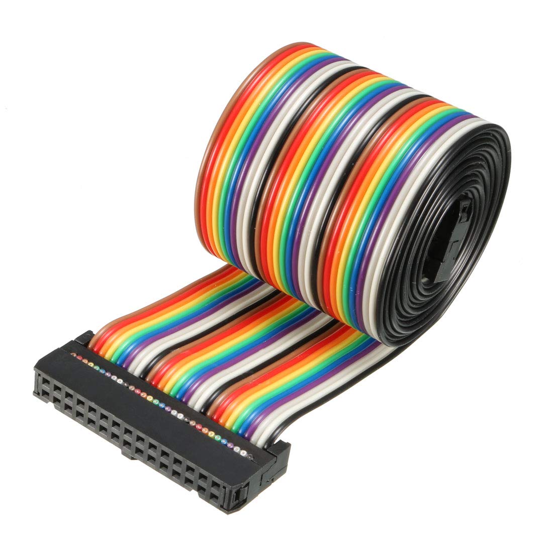

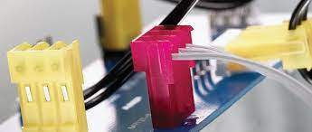

BTW , here is how this whole "ecosystem" will connect -
1. = Vbe and any protection connection - overcurrent/power board control (below 1)
MTA 100 locking 3 pin
2. = OPS to IPS can either be a fixed right angle or straight 28 pin. A neat option is a ribbon cable connector (below 2).
you will be able to mount the IPS right at the back panel if you wish.
(PD+/ND-) are relative low impedance , V+/V- ...the same
PASS labs can do it (below 3) , so can I.
PASS and Parasound were the original inspiration(s) for my Slewmaster projects. I like how the center ribbon cable
is the digital volume and protection circuitry , ALL low level analog is right at the back panel - everything is away from that massive toroid.
And ... we don't have to pay $11,000 USD for it !

ok thanks for the analysis, i agree, why not Toshiba. I'll probably install 1 pair per board since each board will be driving only a single driver each in an active set up. Maybe 75 watts 8ohms. and with 1 pair no matching required.do you recommend matching the other transistors or other components? you mentioned something about protection. What are we doing with that?
I'm adding the Opto's to the power board and both OPS's , so we won't be up $hit creek later. These boards can run "raw" (no protection) , or
fully embellished.
I fully intend to run all 3 of my amps without protection initially , the fuses will suffice.
You might as well fully populate the mini with it's 4 devices - they are cheap. 4 devices will deliver much lower THD , especially if your speaker
dips low (impedance).
As far as matching .... you will notice it does matter more with 4 than 2 (outputs). But , this design minimizes this by being (P/N/P/N).
The servo will compensate for any mismatch (offset) , but you will gain performance the closer you get. N to N and P to P will be nearly
"SMD perfect" in the IPS's.
For both the Spook and hellraiser , RED led Vf (1.8V) will be critical to set currents to spec. Otherwise , these circuits are pretty "idiotproof".
