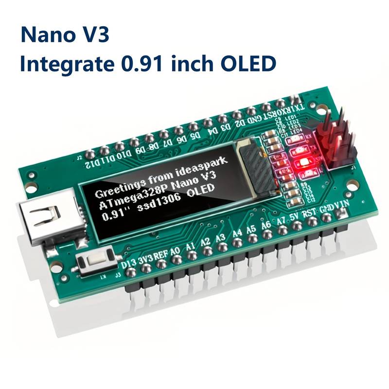

I was just wondering whether the I2C bus could handle the multitasking of thermal/soft-start ?The temp sensors just run on the I2C bus so the port expander doesn't make any difference for them. You read the temperature from the sender in Celsius, then you compare it to a set point you select for the alarm temperature. The reading rolls over below 0C so it should be constrained to stop strange stuff from happening in the cold.
Also , with the I2C bus connected to a small OLED .... could we read states or error codes as text (on the display) - that would be neato !!
For 10$ , they even have a NANO with a oled (below)- besides having to install the display's library , the display uses minimum resources.
I would add a connector (I2C) and use a better display.
OS
I2C displays really slow the loop down. It takes a while to write to a display over I2C. A display should have it's own microcontroller. That's why I did the error reporting code thing to communicate between two microcontrollers. The protection controller writes binary codes to a small port expander. The display microcontroller reads the port expander and displays the messages on the screen.
As for controlling the softstart, ect, no problem. The only issue with remote connection to MCP23008 is if you lose connection you need to reboot the microcontroller to re-establish communication, but I've done it many times myself with no issue. Dumb expanders like PCF8574 don't have this issue.
Most do , small ones use https://www.orientdisplay.com/pdf/AC780S.pdf something like that .... 3 blocks of internal RAM , the display reads fromI2C displays really slow the loop down. It takes a while to write to a display over I2C. A display should have it's own microcontroller.
the controllers RAM , not the Nano's. Just simple text.
I was not talking about a scanned full color TFT. those need some "grunt" (ESPxxx).

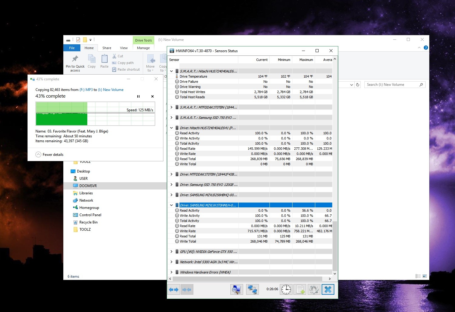

Getting all ready for some real Hi-fi on the SOURCE end -
94% life 1TB Samsung NVME's are just 28$ these days. Bought two , one for FLAC and one for MP3.
So crazy to see the mechanical HHD go for 5 seconds , and then just a burst on the NVME for <.5 sec.
"Need for speed" is justified with 82K songs to search....

WOW ! The 82K library took 2 min. to build vs. 20 minutes on a mechanical.
Search is nearly instant on the NVME.

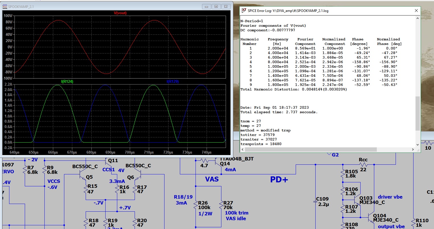

Oh yeah , FZT857 and 957 are the 300V'ers. A little higher Cob - https://www.mouser.com/datasheet/2/115/DIOD_S_A0002833707_1-2541998.pdf
Arcwelder beast is good to go for even a full 85-90V supply.
At that obscene level this OPS could pass 11A AC out to a speaker , which would be 1.5KW. Since it does not use MT-200's ...
that would be a peak (or 2 ). Still , you would have quite the headroom.
The best outputs would be 15A (ON3281/1302) , "better" more aggressive SOA @ 80V. Drivers on this creation are outputs -
Sanken 3263/1294 is quite different than most outputs (60Mhz Ft and 250p Cob) It's just a big driver.
I think I did use these (as drivers) when I had my "slewmaster". THD is 40ppm .... oh, well - this will be my sub amp.
