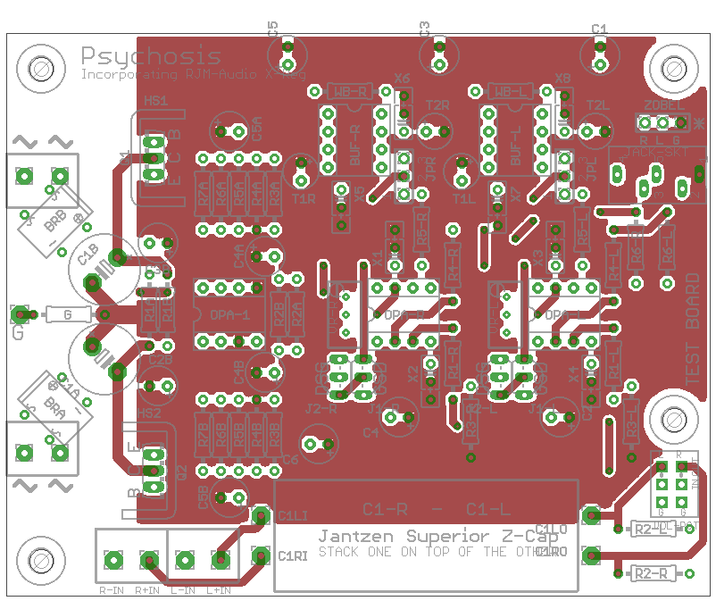

the regulation (well actually stabiliser (RJM's x-reg) feeds the whole circuit with power via +/- power planes. the regulation is grounded via the rectification smoothing caps. you could say that the regulation is part of the main circuit to 'smooth out' the DC.
thanks Mark, i'm not up to speed with sims yet but i'm guessing i'm looking at oscillation.
that layout also has the input cold going to the same as the feedback resistor network ground. which would technically put it on the same ground plain. yes? also i dont see an output ground in that layout so sticking a resistor in line to act as a load does not fully represent a speaker.. or am i wrong?
I would say you are wrong on all points.
Local decoupling capacitors must have charging routes that do not impinge on routes for signal. That is much more difficult on the two layer board.
First time I have ever heard of this please enlighten me, as I have never ever seen this done. One ground to rule them all is my motto, the local decouplers are part of the signal loop same ground plane...
thanks Andrew, my main concern now is SGK's thread about these small bridge rectifiers and i'm wondering if they have enough 'juice'. http://www.diyaudio.com/forums/powe...rations-fairchild-sdip-bridge-rectifiers.html
the bridge rectifiers are placed on the underside of the board. i will if needed be making alloy spacers as heat shunts to connect to the base of the case.
well spotted on the volume pot thats going to be nippy routing that...
there is no input cold to the opamp, the opamp - is a feedback loop. the resistor going to ground on the feedback is part of the circuit for the feedback to control the gain of the feedback, it has nothing to do with input cold as far as i'm aware. once the hot signal leaves the volume pot it leaves the input cold signal behind, this cold signal as stated before is part of the input from a source and stays part of the source so as not to create trouble in the output signal. the hot signal then goes onto the output amplification which then adds the output cold at the headphone socket. or have i got confusion on this.
yes i really would love a solid ground plain but i really dont know how i'm going to manage to get a full layer pour without opting to use a 3-4 layer board, 3-4 layers is also going to push up the price of boards to get made. to get more layers is going to either cost me money e.g.for a more advanced Eagle editor or find another free editor (pcbexpress?) with the same library as Eagle.
with the amount of traces already on this board a star grounding scheme is out the question. besides why use a star ground when i have a ground plain. i was under the impression that a star grounding scheme only really applies to internal wiring of components to create one fixed ground so not to create a loop.
if i try to reduce the amount of top layer traces to the bottom it's cutting off the negative supply to components. i also thought that having a lot of vias was a bad idea unless you were using smd components to which you can stick them right next to the pad. (note: the design is based very roughly on RJM's Sapphire and if you look at his boards (dual mono) the ground plain is cut up with traces on the top and it manages to sound pretty darn good). from what i can see on my board the biggest problem area for the ground scheme is OPA-1 x-over's causing a restriction.
the board is only 8x10cm and is all through hole components so i think i'm doing well stuffing so much onto one board. if i used smd components then i could place a lot of the components on the underside negating the need for top traces. maybe once i have 'full working' design then yes the use of smd would be superb.

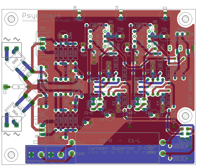

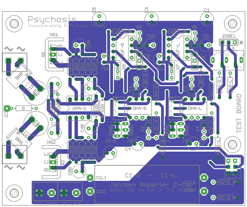

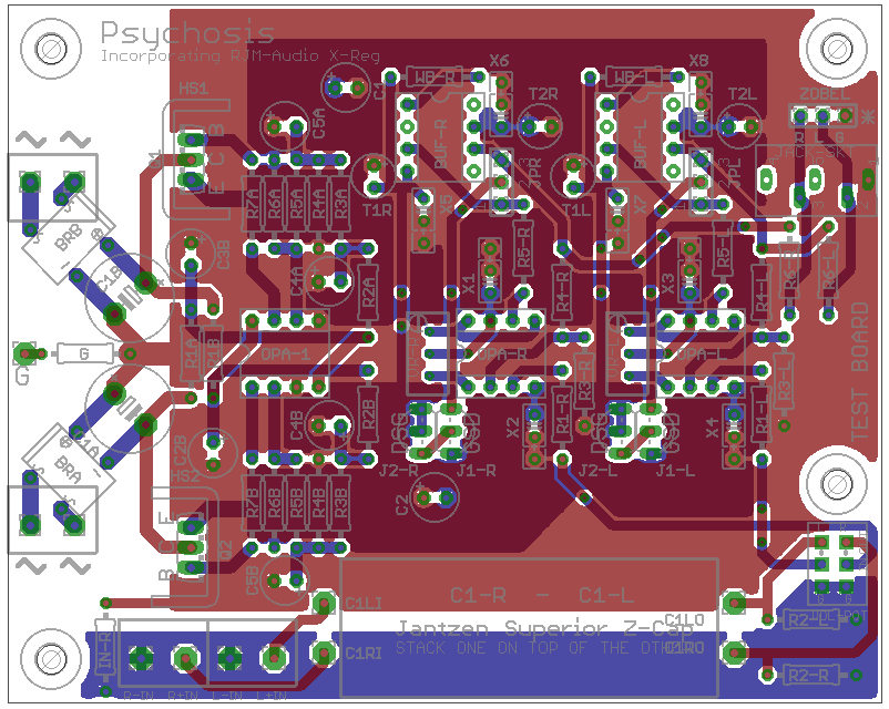

i could not resits tinkering as i had an idea... i have now coupled the input ground plain to the main ground plain via the feedback bias resistors R3-R/L ground pin.
added a lot of vias to clean up the top layer (ground).
now i have a little confusion about the placement of the volume pot. i have placed it after the input coupling capacitors that also act as high pass filters, now i dont know if i have got this right but would this not then act as a variable high pass filter or is having the resistors before cancelling that effect out?
top layer
bottom layer
full layers
top layer
bottom layer
full layers

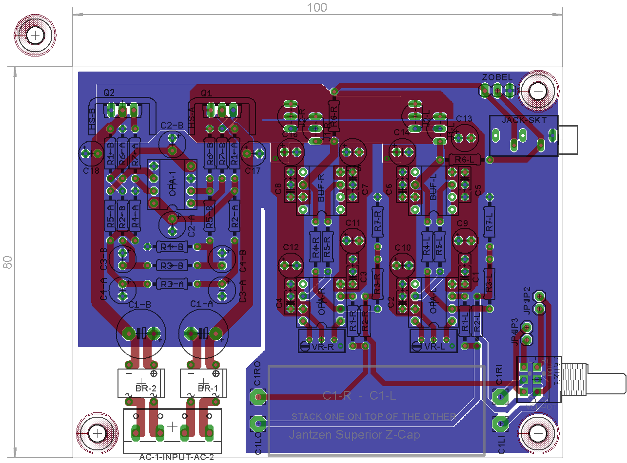

i have been giving the design less attention at the moment to give my noggin a rest. lol
i have come to the conclusion that 4 layers are going to be the way to go.
using the 4 layers also allows me to remove some of the bugbear traces that i had which has led to all the traces now on the top layer.
going over the data sheets and components i have found a few inconsistency's regarding the pinout, pad placement and sizes on a few components, mainly pots and jacks. this has forced me to learn how to make/change components in library's. all good as its taught me something else.
