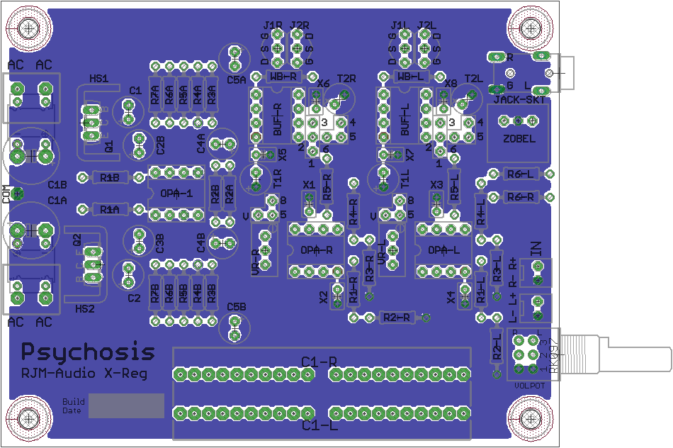

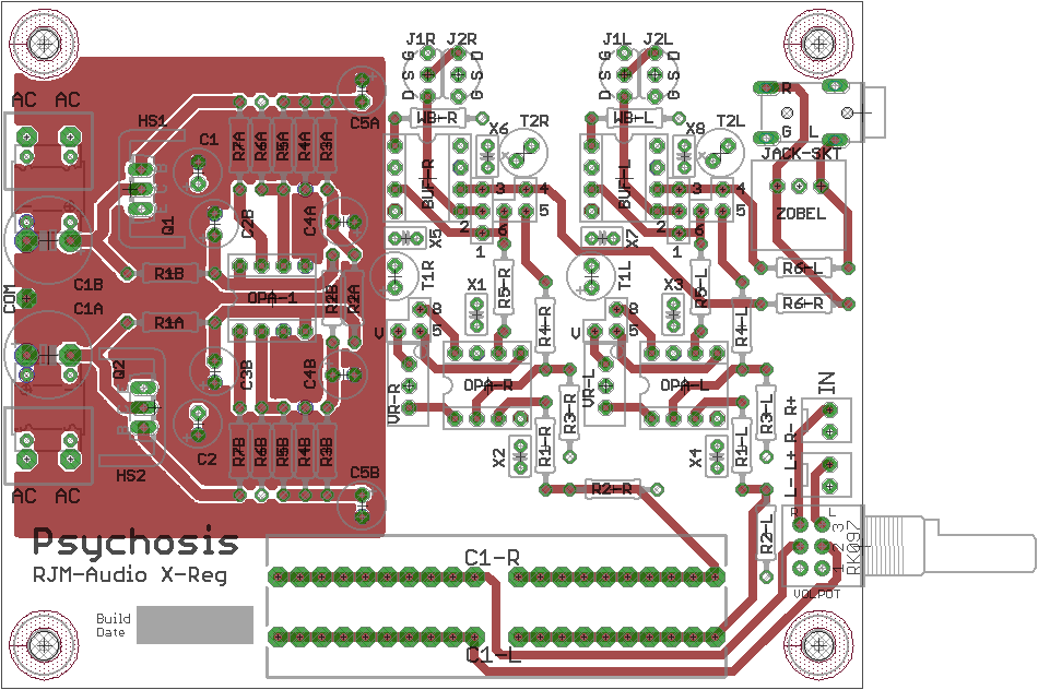

well after some messing around i think i have found a nifty solution, i dont know if it will interfere with the audio signal traces but here goes.
i created a GNDV plane for the DC+/- on the top 'signal' layer. this leaves layer2 for audio GND. the GNDV will be tied to the GND using a via at the input rectification capacitors.
i tried it the other way round but the traces were blocking the path for audio signal GND to create a complete pour.
had to mess about a bit due to not being able to join the GNDV and GND planes so i made them both GND and manually restricted what was necessary.
i now have:
L1 = signal traces and DC GND plain, the DC GND is connected to the rectification capacitors (COM).
L2 = signal GND plain and is connected to rectification capacitors (COM).
L3 = V- power plain.
L4 = V+ power plain and a few traces that i could not fit on the L1
i now have:

so if i have the gist of this what i need to do is create a 'busbar' between the +/- of the rectification caps then connect this to the main GND. remove the GNDV and just let one GND rule them all.
i have tried searching the internet for answers but in every instance that i can find they are talking about how to deal with analogue and digital signals and their grounds and power being a separate entity (off board).
i think the penny has just dropped.. make the power section a separate entity with its own ground as if it were off board then connect the audio section ground to that.
If my reading of H.Ott is correct, then the better way to achieve that is to have a signal ground plane next to the signal plane and a separate power ground plane next to the power plane/s...............i think the penny has just dropped.. make the power section a separate entity with its own ground as if it were off board then connect the audio section ground to that.
That gets you to 4 layers as your minimum.
The signal plane is separated from the power plane by two ground planes and these get interconnected at some appropriate location.

this is what i'm thinking about now for grounds.
L1, this is the top layer with the power section, the power section has its own ground plane which connects to L2 via the COM through hole.
L2 is the main ground for decoupling caps and audio signal which is connected to the power section ground via the COM through hole.
the other two layers will be for the DC +/- power planes.
Why ? The place where they join should be the output of your regulators. Which means the ground pins of the caps at the output of your regulators, btw. Which caps seem oddly missing ?
The groundplane in L1 and L2 should barely overlap if you lay out things properly.
i'm not using regulators in the normal sense. i'm using RJM's X-Reg. the X-Reg uses NPN/PNP transistors as its output for the +/- voltages so no caps after that unless smoothing caps. to feed the X-Reg i'm using split supply from bridge rectifiers which are connected to smoothing caps, these smoothing caps create the ground via their alternate +/- like creating a virtual ground on battery's. the smoothed voltage is then fed to the X-Reg circuit.
