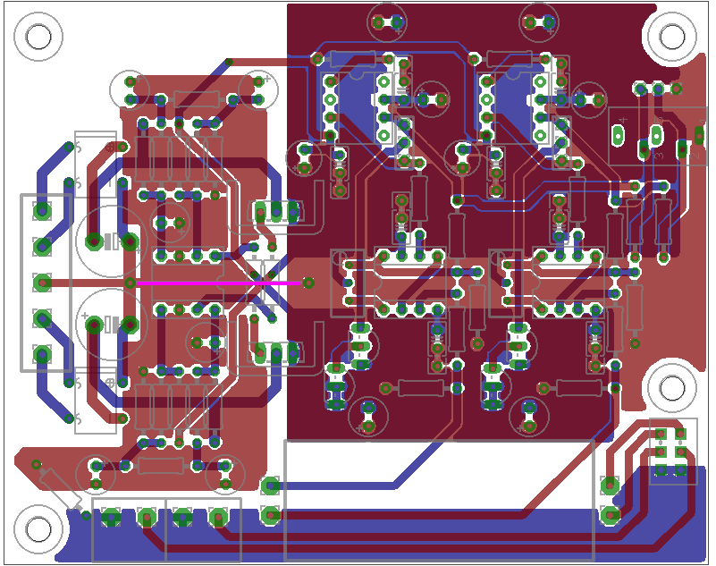

splitting ground planes
i have tried every combination i can think of to create a trace (stub) from between the caps to the audio ground and it cant be done. to create the trace (stub) i have to reduce the size of the GNDA to isolate the trace (stub) and when i do the outer reg caps wont connect. even changing the name of the GNDA to GND does not help. there is just not enough room on the board. if i had tree layers to play with then yes no problem but i'm using the free version of Eagle.
the only option i can think of is to use two wire pads and take a piece of insulated wire between them. Eagle will throw a wobbly but i will know what to do when the times comes to solder the boards up. messy but it will work.
lots of coffee later and i have this... the pink line is a wire jumper that will be solid core with jacket.
A real gound plane is actually a return route for currents flowing in another layer.
The return route at DC is via the shortest low resistance piece of plane irrespective of the Flow route of the trace.
But as frequecy has become AC then impedance rules. The return route will take the lowest impedance part of the plane. As frequencies get higher the lowest impedance becomes dominated by the inductance between the flow and return routes. The lowest impedance is when the return route is very close coupled to the flow route of the trace, i.e. the return route follows the trace in the other plane.
For this reason AC flow currents must NEVER pass across a gap/break in a return plane. That gap forces the current to find a different route than under/over the Flow trace. That different route will have a higher inductance and will also have become an EMI problem. It emits radiation and receives radiation that is minimised when the upper and lower traces are only separated by 8thou of insualtion.

Andrew, i think i get what you mean. the cold audio signal will try and migrate to the hot via the pads as trace pads even though isolated will migrate. how does this work with off board power/regulation supplies as my brain is saying that what i have done is exactly the same as an off board reg/rec supply its just that its on the same substrate.
all this mixing of AC/DC really confuses me especially how connecting the +/- of the spare rectifier terminals together creates a GND. i'm used to working with vehicle electrics where everything is live (when needed) apart from when it gets back to the negative terminal due to it being flow and return just like switching on a light bulb. its the ground in electronics that i have a hard time understanding as my brain says that its not a ground its a return/com.
rayma, if i connect both reg and audio ground planes then i wont need a wire and use a stub from the middle of the cap T?

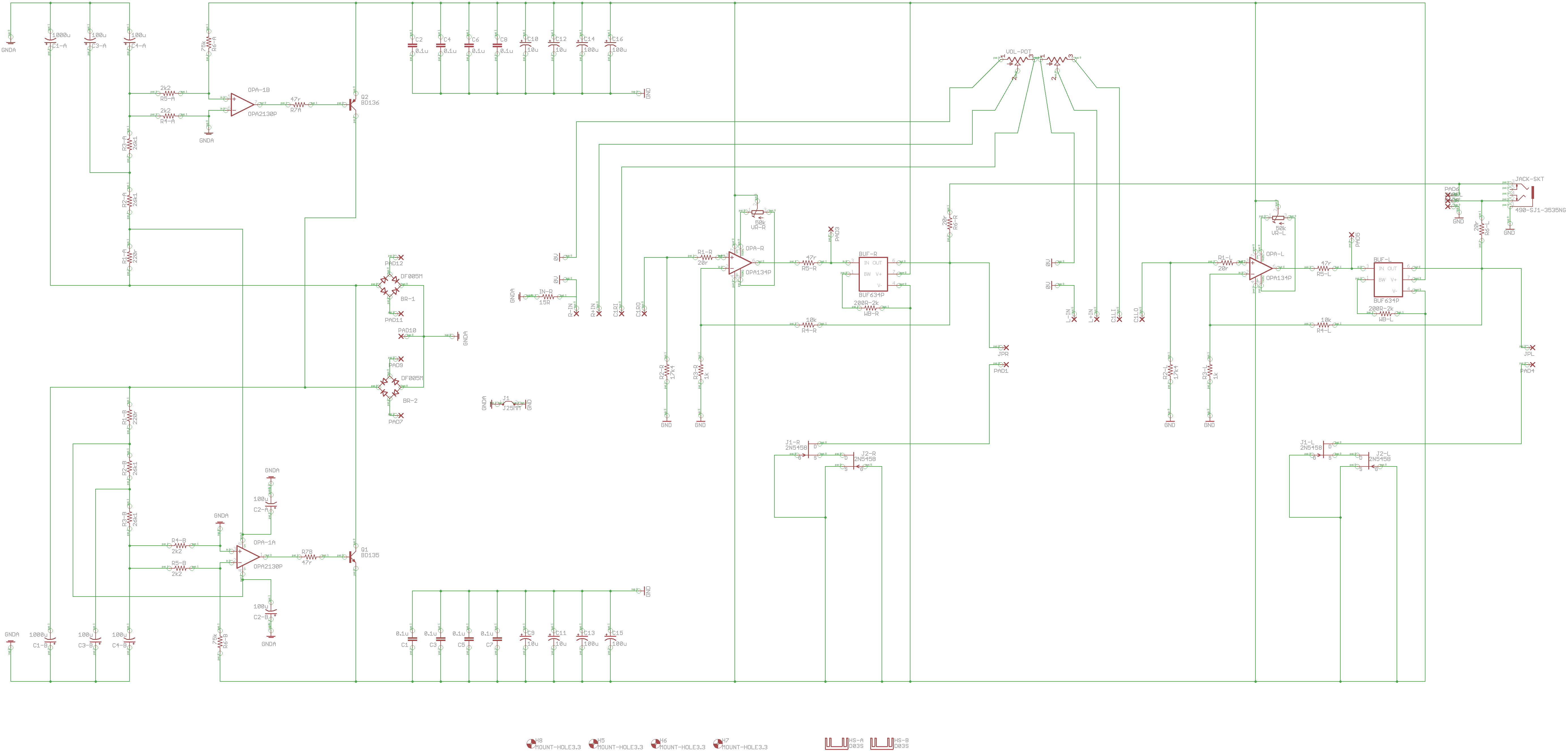

I think that there is an error in the PSU part of the schematic/layout. The positive bridge rectifier connects to the negative side of the capacitor.
The current flow of the input signal goes:
L/R+IN -> Pot -> C1-L/R -> R2-L/R -> GND -> PGND -> R -> AGND -> L/R-IN.
Could/should R2L/R and R3L/R not be connected to the input ground? Each channel could have its own input ground and resistor connecting the input grounds to the main ground (not PGND). This should also help reducing hum caused by ground loops.
Yes, the regulator and audio ground planes can be made into one plane.
Just keep the rectifiers/filter capacitors out of it, except via one direct connection.

well spotted, the whole regulation is upside down 🙁
R2/3-L/R are just drains to ground.
R2-L/R (and C1-L/R) form a high pass filter on the input (hot) to restrict at 20hz. with the amp being for headphones there is absolutely no point in going any lower than this as A,you cant hear it and B,you cant feel it. hooking up a CD/Digital file player will be ok but hooking up say a Phono stage could result in too much extension of the headphone diaphragm due to wow and flutter/rumble, ok so it wont stop WF/R at higher than 20hz but most dangerous are the ones below as they are the big 'cone flappers'.
R3-L/R is the drain for the feedback network.
The junction of the two filter capacitors is indeed a common, but many call it a ground.

Electronic circuits don't have a drain. Think loops, supplies and returns. The source, connected to the amp, has a supply and a return (GND). The signal current flows in a loop from the source though the interconnect, potentiometer, capacitor, resistors and returns back though the interconnect. The same goes for the amp feedback and the outputs. Positive/negative rails (capacitors) -> opamp -> Load and feedback -> Ground (capacitors).
The trick is to organise the grounds so that you don't mix the different currents though a ground plane. And, keep the supply and return loops small.
Could you please post a new schematic?
