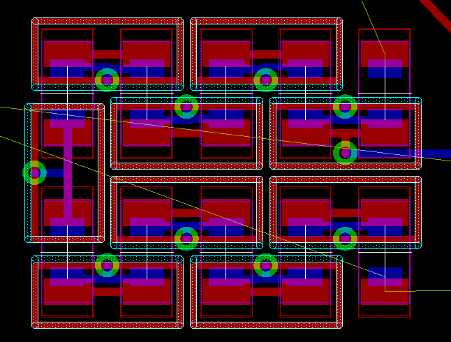

I have built a board with a equal value R string feedback, but with added 2nd low impedance "guard" string on the bottom of the board which drives guard rings for the feedback string PCB pads/nodes
pcb trace shield/guard rings are usually seen as a ultra high impedance/low leakage technique but it can also work to higher frequencies "bootstrapping" parasitic C for very low effective parasitic C, and when you consider typical pcb epoxy with fire retardants and adsorbed mositure is a poor dielectric then sub ppm distortion divider may want to use these techniques
the pic is just the top/bottom, guard ring top trace seen with overlapping stippled top part ouline, 1206 feedback divider on top, 0805 guard drive ladder on the bottom
not shown is the inner layer "window" cutout in this 4-layer board's pwr/gnd layers so the feedback R see the guarding ladder's "bootstrapped" V nodes through the pcb dielectric
the pcb trace shield/guarding could/should be extended all the way to amp inverting input pin, with 4-layers you can make a very high coverage shielded trace using inner layers
This isn't microwave. The inductance of the vias will be so low as to be unmeasurable below 10 MHz. I think the driven shield is also overkill, even though I'm using similar tricks in different places. A single shield and balancing the RC ratios will get closest to a real solution. That would be worth simulating and making a real prototype to test. As it is there is no provision for the input C of the feedback node. And the PCB does have a lot of non-linearities. However those vanish at these low impedances.

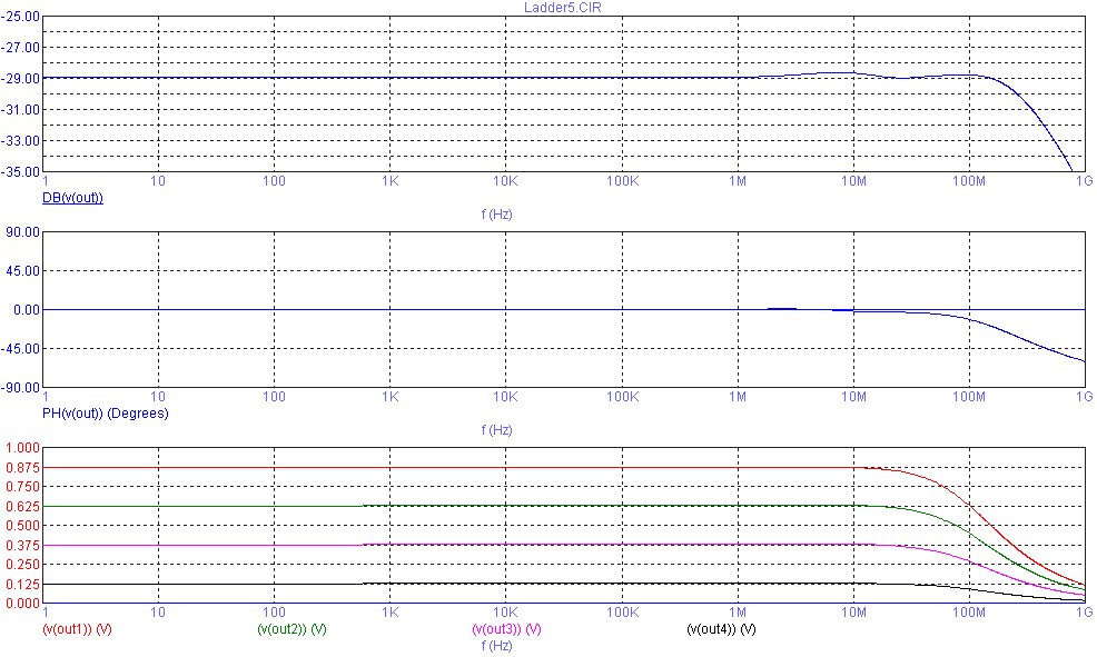

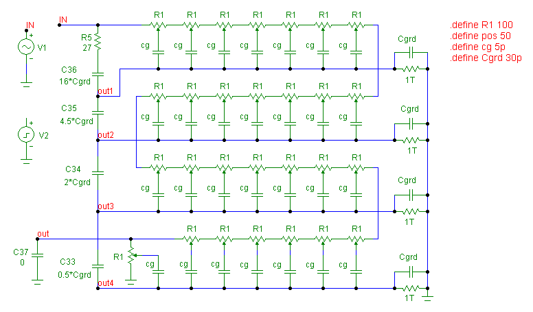

Now I have simulated a slightly different ladder, consisting of 28 resistors of 100 Ohm and 1/8W (1/4" long). They are divided in four groups, each having their own guard plane of 13*21mm (around and directly underneath the R's).
I estimated the capacitance between that plane and each resistor to 5pF and the capacitance between the guard and the ground plane beneath it to 30pF (using a four layer PCB).
Leaving the guard plane floating, I got a phase shift of 11 degrees at 1MHz.
Bootstrapping the guard planes by means of a capacitive ladder, such that the successive voltages are 7/8, 5/8, 3/8 and 1/8 of the input voltage, extends the bandwidth to over 100MHz (see next post). More than enough for audio applications, don't you think so?
Notice R5, which prevents peaking above 100MHz.
BTW, as told in a previous post, the internal capacitance as well as the "intra capacitance" have far less impact. So I've omitted these caps in this simulation
Edmond.
Good work, if a little involved. It would be worth the effort to find the real values of the parasitics and throw that in. Moving the response errors to above 100 MHz should make them a non-issue. The next trick would be to use the layers of the PCB to make the capacitive divider. You would still need to compensate for the input capacitance of the feedback node (which will be a much more non-linear capacitance than the PCB).
