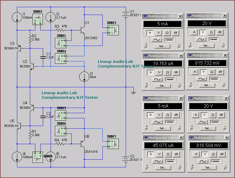

I did some search with google. I got 2 spice model. I don't know which model is right.
.model 2SC3281_1 NPN (IS=10F BF=107.06 VAF=100 IKF=16.941 ISE=0.578669F NE=1.14481 BR=10 IKR=1.04175 ISC=1.21848E-05F NC=2.99843 RE=1 RC=30.7022M CJE=600P MJE=350M CJC=1.05579N VJC=700M MJC=500.059M TF=4.16856N XTF=500M VTF=10 ITF=10.4762M TR=10N RB=0.16 XTB=2.0 Vceo=200 Icrating=15000m)
.model 2SA1302_1 PNP (IS=10F BF=129.738 VAF=100 IKF=16 ISE=0.414467F NE=1.12865 BR=10 IKR=9.99995 ISC=2.16381N NC=2.21849 RE=1 RC=149.165M CJE=800P MJE=350M CJC=1.83549N VJC=699.998M MJC=499.587M TF=6.72889N XTF=444.956M VTF=10.5982 ITF=1.13444P TR=10N RB=0.22 XTB=1.2
.MODEL 2SC3281_2 NPN( IS=10.000E-15 BF=155.65 VAF=100 IKF=9.2028 XTB=1.5 ISE=54.325E-15 NE=1.3056 BR=10.787 VAR=100 IKR=1.8561 ISC=106.69E-15 NC=1.6728 NK=.55624 RC=26.745E-3 CJE=2.0000E-12 CJC=534.41E-12 MJC=.33333 TF=8.0821E-9 XTF=3.1968 VTF=21.461E-3 ITF=169.59 TR=187.91E-9)
.MODEL 2SA1302_2 PNP( IS=21.479E-12 BF=136.48 VAF=100 IKF=19.980 ISE=21.504E-12 NE=1.3784 BR=329.48 VAR=100 IKR=19.980 ISC=4.3670E-9 NC=1.4264 NK=.72845 RC=93.301E-3 CJE=755.31E-12 MJE=.33333 CJC=1.1417E-9 MJC=.33333 TF=1.2802E-9 XTF=10 VTF=10 ITF=1 TR=10.000E-9)
thanh said:I did some search with google. I got 2 spice model. I don't know which model is right.
Setup a complementary BJT tester in your Sim.
I have such a circuit saved, that use.
This way I can see if there is something Not Normal .. for example with VBE.
My circuit works at higher Ampere: 1 - 2 A
But also at very low currents.
As you can see, the same current goes into NPN as into PNP.
You just have to change 1 Current source.
thanks lineup!
I just simulated my amp with these models. A model gived a good result and another is otherwise. Perhaps a bad/wrong model can be good😀

thanh said:thanks lineup!
I'm sorry! I just simulated my amp with these models. A model gived a good result and another is otherwise. Perhaps a bad/wrong model can not be good😀
Interesting question.
If one model is not correct/bad = does not show close to the curves of the transistor,
can one amplifier using this model/transistor be good/better in Simulation?
We have to say YES.
Because if the model is not correct,
it can be 'too good model'. Better than Reality.
Or 'too bad data' for this transistor.
The only thing we can do is to try to verify a model, if not sure it is close to real.
And there are only 2 good ways to do this:
1. Check against real measured data/curves taken from a REAL Transistor.
2. Check against some data/curves, that some other person has measured.
Most often those curves in DATASHEET.
We have to say YES.
