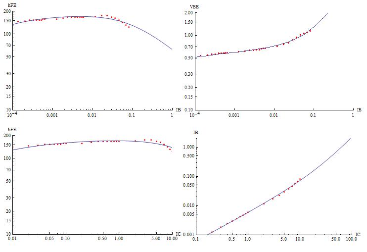

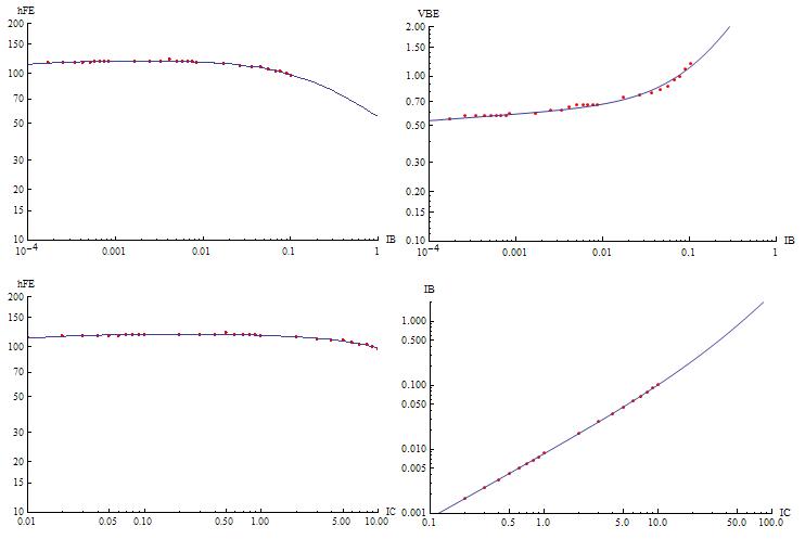

Static parameters for
Here are the static parameters I find for the MJL4302 and MKJ4281.
MJL4302:
IS=3.131*10^-14 BF=81.0725 NF=0.792065 VAF=40 IKF=31.1057 ISE=9.67702*10^-9 NE=3.25924 RB=4.4736
MJL4281A:
IS=7.62357*10^-10 BF=125.26 NF=1.21162 VAF=40 IKF=21.7701 ISE=3.59106*10^-9 NE=2.20222 RB=5.50224
Any comment and suggestion is wellcome.
