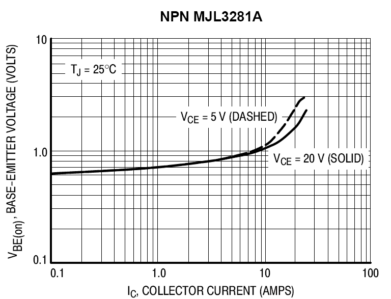

Are you talking HSPICE here? I'm looking in Massobrio and Antognetti, and the only quasi-sat parameter documentation in there is HSPICE-specific (level=2). AFAIK, LTspice doesn't have them. At least, I don't see any parameters in the LTspice SGP documentation that aren't in the SGP parameter descriptions in Massobrio and Antognetti.
I only mentioned quasi-sat because of Teodoro's post and graph here. That kind of behavior (negligible change in beta at low currents as Vcb is changed, but much larger changes in beta as Vcb is changed at high current) imply something akin to a lower Early voltage at higher Ic. You can also see this effect in the Ic vs. Vbe curves at two different Vcb values (see below).
Edit: Also, what I'm reading from some internet references is that quasi-sat also accounts for the sharp dropoff in fT at high currents - something I can't get the SGP models to handle correctly for the OnSemi power devices.

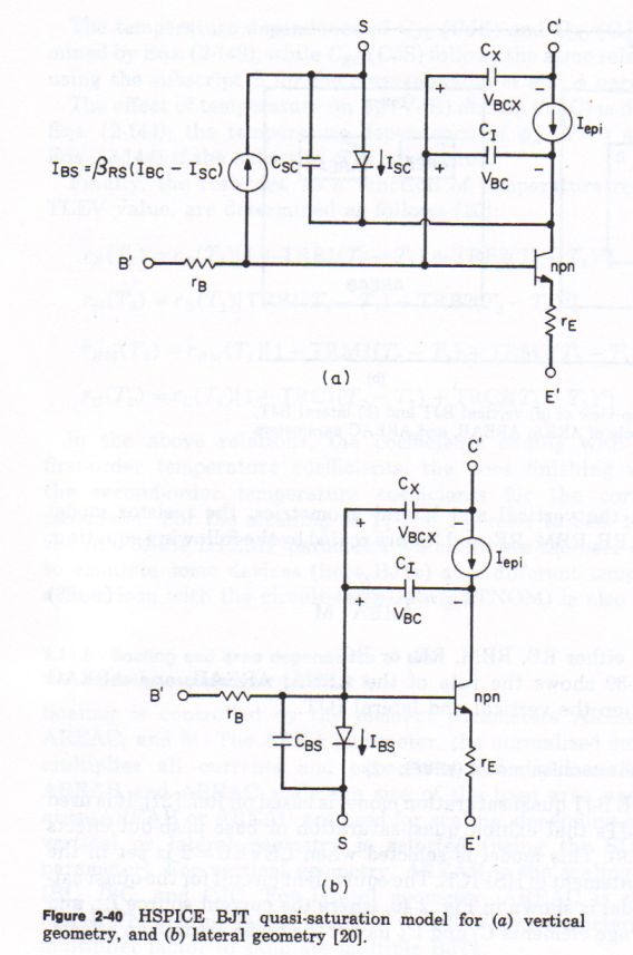

Okay, I found the quasi-saturation parameters in an online PSPICE manual here on page 212.
Looks like the parameters are VO, RCO, QCO and GAMMA. These aren't covered in Massobrio and Antognetti, but the reference below describes them:
"[3] G. M. Kull, L. W. Nagel, S. W. Lee, P. Lloyd, E. J. Prendergast, and H. K. Dirks, “A Unified Circuit Model for Bipolar Transistors Including Quasi-Saturation Effects,” IEEE Transactions on Electron Devices, ED-32, 1103-1113 (1985)."
In looking at Massobrio and Antognetti, the HSPICE level=2 BJT is stated as being based on this article and they say PSPICE is the same a SPICE2 - which is out of date. So it looks like PSPICE implemented it after Massobrio and Antognetti was written but HSPICE implemented it earlier. Also, I was wrong earlier about LTspice - it uses the VO, RCO, QCO and GAMMA parameters as PSPICE does.
Confusing! But maybe this can be used to improve the models.

Andy, do you believe that the curve you show is an issue with quasi-sat? Or is there a mechanism for beta droop being Vce dependent? I'd think that the Vce of 5 and higher would not be in quasi-sat, but I'm not sure, I see you have a reference there for the model.
I was originally thinking that, but when I looked at the equivalent circuit for quasi-sat, it looks like its effect in the model is a base current thing (Ibs, see attached graphic). So this would not be related to the collector current plot I posted earlier. It looks like to model the Vce-dependent beta droop may require a bias-dependent Early effect as VBIC uses - but I'm not sure. Maybe it could be handled by the quasi-sat stuff. I'd have to look into it more.

Massobrio and Antognetti is usually the place to go for Gummel-Poon info, but they failed me with this quasi-sat thing. Here is a link to that book. Each chapter is greatly abbreviated in that Google book, so it's not the complete thing by any means.

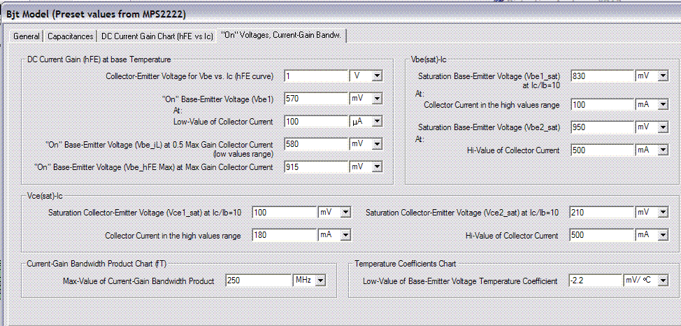

Multisim has a model building utility that I has attempted to use, but I lack the necessary specifications - the typical data sheet does not have enough information.
It needs specs like HOE at a given Ic and Vce, storage time(ts) at a given Ic and Ib, Ceb at several reverse voltages (likewise for Ccb), so on and so on.
Given enough info (some spec sheets don't even have capacitance charts), it's possible to produce, what should be, an accurate model.
Here's a screen shot of the model building dialog:
There is a small signal h parameter two port model that is sometimes used for LF circuit modelling. hfe is such an h parameter and hoe is another. hfe = Beta when hoe = 0.
I don't know about that modelling feature, is it available in the student version?

Disabled Account
Joined 2007
Pete,
Probably not, the student version is very stripped down.
I tried to use it to produce a model for the 2SA1011 but did not have enough information. Searching for a model on the internet brought me to this:
http://eesof.tm.agilent.com/docs/adsdoc2005A/pdf/vcap.pdf
where there are quite a few components, but they list only 3 "key parameters" (Is, Bf and Tf).
Is this useful?

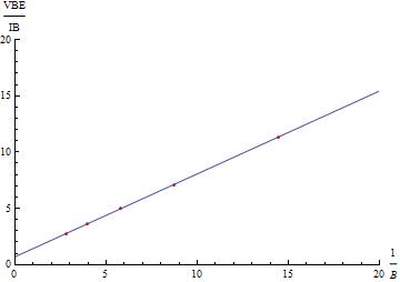

teodorom said:
Bob,
I have just developed (with Mathematica) a procedure able to extract (without any explicit, manual, recursion) those static, forward, parameters. For the others I assume the "typical" value.
The great uncertainty is the value of VAF: many times there is no way to get it.
I've got reasonable results for MJL1302A, MJL3281A, MJL4302A, MJL4281A. With the MJE15030 I had some problems (BF too high, when compared to hFE, convergence problems).
More over I have problems with the displacement of the "beta droop" when varying VCE (I guess it is a problem of the SGP model).
Are you using Rc=0 for these models?
Nice work by the way, those curve fits look quite good.
I notice that you're plotting hFE vs. Ib, did you also plot versus Ic?
Pete B.
Since I have no way to find RC, following andy_c, I have put RC=0.
I have checked (using LTSpice) that (1/IB,VBE/IB) are on a straight line, and that, if RC=0, the intercept with the "VBE/IB" axis is RB.
I came into this conclusion reading the Agilent papers, but I have no formal proof (or I'm unable to repeat the Agilent reasonings) of it.
The experimental points are well aligned.
In the graph I provided there is also hFE vs/ IC.
My method doesn't work all the times: I'm having problems with the MJE15030 ... and I don't understand why (the difference).
Yes, RC is a compromise since it is lower in saturation, however I'm not too concerned if Vce sat is a volt or so off, in fact there is often a wide range of .5 to 1.5V or more for typical vs. max value for Vce saturation in power transistors. Andy used a value of .06 ohms for Rc which provides a much more reasonable match over most of the operating range.
Seems something under .1 ohms is about right for most typical 10 to 20A power transistors with low Vce sat.
Obvioulsy, RC effects the hFE curve since for example with 1 ohm the max Ic is limited to 5A with Vce=5V and 20A with Vce=20V, no matter how large the Ib. The effect is less with smaller RC values but it does come into play. The value was completely off, being 2 ohms in the OnSemi model.
