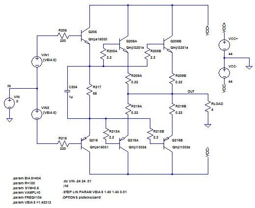

I picked the bias voltages VB1 and VB2 to get bias currents of 150 mA in each device with an open-circuit load. This was the current that Bob Cordell used in his original MOSFET error correction amp AES article. Since there's no optimum bias for FETs as there is for bipolars, the choice is somewhat arbitrary - the more, the better as far as distortion.
For the two offset voltages V3 and V9, I picked these so that V(out) = 0 when V(in) = 0. I guess this is somewhat arbitrary, and maybe unnecessary. I did this by first setting these voltages to zero, then finding the output DC voltage of each circuit with an open-circuit load. Then I set each one to the negative of its corresponding output offset, and reconnect the load. This usually gives an output offset within microvolts of zero with the load connected.

Nice job, Andy. How many hours I've spent on that !
gives
I guess that setting the offset (that is needed if one merely plots V(out)/V(in) since when V(in)=0 also V(out) need to be zero, otherwise you have a singularity) is unessential because you are dealing with d(V(out)).
Thanks again
gives
Thanks again

unclejed613 said:one thing i have found useful in LTSPICE is to plot the input waveform minus a portion of the output waveform (like this: V(in)-(V(out)/20) the number 20 represents the amp gain, and can be whatever number the gain is). this gives a waveform of the distortion residual. this will also show you if you have crossover distortion, since the spikes will be clearly visible. your residual may also seem to be out of phase, and i.m not really sure yet how to compensate for that.
the way to plot this is to wait for the simulation to finish, click on plot, select Add Plot, and insert the formula in the numeric expression box.
Sorry if it seems dumb, but does this mean if I perform this expression with say a .tran command, and I get a good squarewave thousand times less then V(out), the sim'd distortion is 0.001 without too many nastienesses?
Rüdiger
if your gain is .001 compared to V(in), then the expression will still result in a nasty trace. i've tried running the .FOUR command on numeric expressions, rather than actual voltage nodes, and it doesn't work. in any case, your distortion is weighted to the fundamental in the measured waveform, so whether you use .FOUR, or use FFT, you will still come out with huge distortion figures for a square wave. using V(in)-(V(out)/Av) will only give you a waveform with most of the fundamental cancelled out, leaving the distortion residual, and this will usually be a very nasty looking waveform, containing any crossover notch, clipping products, noise, and anything else that wasn't included in the input waveform.Onvinyl said:
Rüdiger
I cannot agree on that. With a reasonably small time step (preferably using a prime number ratio) I found the harmonics (via .FOUR) of the sine generator to be 180dB down (which seems to be a PC implementation limit -- I have yet to find a software generator with lower distortion than that). Of course with compression off (.opt plotwinsize=0), and using the alternate, higher precision solver.unclejed613 said:i've tried running the .FOUR command on numeric expressions, rather than actual voltage nodes, and it doesn't work.

teodorom said:Nice job, Andy. How many hours I've spent on that !
gives
Thanks again
Very nice display. Can you post the LTSpice asc file you used for this?
Thanks,
Bob
what i meant was, i think i tried something like .FOUR 1KHZ (V(IN)-(V(OUT)/20)) and it didn't work, but .FOUR 1KHZ V(OUT) or .FOUR 1KHZ V(N003) will work.
or maybe it was the .WAVE command that didn't work. i can't think of a reason to use a .FOUR command on a numeric expression, but since the .WAVE command requires input of less than +/- 1V, then it would be convenient to use .WAVE test.wav 44100 (V(OUT)/20) for an amplifier output, but i tried it, and got no output to the file.
Ah, ok. I tried that, seems like the expression parser quite simple. It uses the first node found within a complex expression, unless the expression starts with something else than a node. So (V(IN)-(V(OUT)/20)) will give just V(IN), but something like (-0.05*V(OUT)+V(IN)) will produce an error msg.unclejed613 said:what i meant was, i think i tried something like .FOUR 1KHZ (V(IN)-(V(OUT)/20)) and it didn't work, but .FOUR 1KHZ V(OUT) or .FOUR 1KHZ V(N003) will work.
Similar behaviour here. Either only first node taken, or error.or maybe it was the .WAVE command that didn't work. i can't think of a reason to use a .FOUR command on a numeric expression, but since the .WAVE command requires input of less than +/- 1V, then it would be convenient to use .WAVE test.wav 44100 (V(OUT)/20) for an amplifier output, but i tried it, and got no output to the file.
If just the node name alone is given, without V(..) or I(..), then the voltage is taken, I found out BTW
One can avoid that with a simple BV device generating a voltage from an arbitrary expression.
- Klaus
