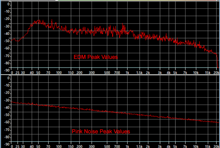

Yes, surprising, really. I did see one track that had a low sweep from about 35 to 70Hz, tho it actually rolled off at the bottom. Another track (not included) had a small peak circa 13Hz. Didn't see anything else nearly that low. Basically bass is 10dB above midrage and mids are 10dB above the tweeter range for peaks.
Anyhow, that's the way it's recorded. How you play it back is another matter. 🙂

I went over this paper a few times, it's good work. I tried to compare my findings to theirs, and had to re-run the analysis as close to the AES setting as I could. FFT of 32K bins, 50% overlap, Hamming window. My graphs are similar, tho not identical to those in the AES paper. Same trends, similar low end peaks and roll-offs. But their spectrum does not drop as fast as mine. Mine also show a bit more bass.
The study uses longer and different averaging than mine, so that might account for the difference in treble roll off. Certainly their plots are smoother than mine.
