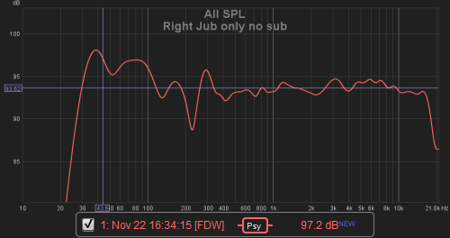

Here is a FR plot for the left channel of my system at the listening position:
The center and right channels are similar. The surround channels cut off at about 45 Hz, and the subs cut off at about 14.5 Hz and are crossed at 40 Hz. The rise in FR below 100 Hz was targeted at 1.5 dB/octave.
Each channel has been individually EQed flat using REW (the EQ optimizer facility) and a Xilica XP-8080 loudspeaker processor to within 2 db (excluding room mode dropouts). The front channels are all bi-amped, while the two surrounds are mono-amped but EQ-ed flat.

Thanks Chris! I see you applied FDW filtering. How many cycles? And can you also post the steady state response, i.e., no FDW filtering, just the psyhcoacoustic smoothing?

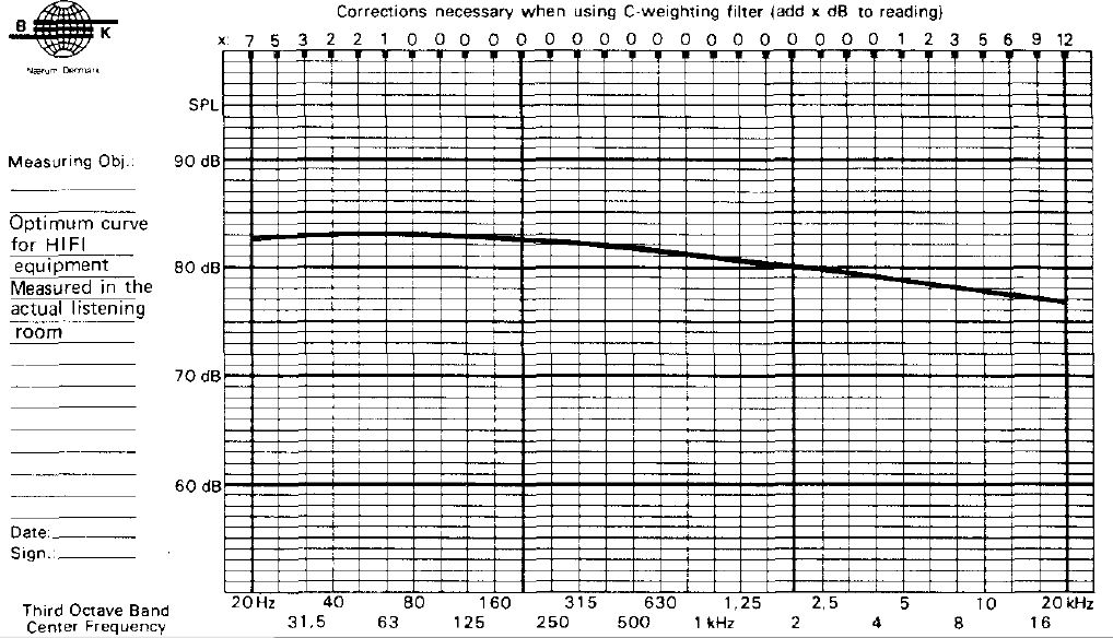

The reason I was asking is because it could be that the response at the listening position might be too bright causing a perception of a lack of bass. I (and many others here) like a B&K style curve at the listening position. Note that this is not the FDW response, but a steady state response that includes the power response of the speakers.
You'll note that the bass and lower midrange is quite a bit raised relative to the high frequencies. In most rooms, with the usual furniture and absorption, and usual cone/dome speakers, this is what you would get and most people would find this balance neutral. But, if you have constant directivity speakers combined with less room absoprtion, the total emitted power in the high frequencies may not get absorbed and may cause a perceived lack of bass.

I would still like to see your in-room steady state response, if you have it. Thanks!

Chris, I've had speakers with well controlled directivity in normal acoustically treated rooms, and open baffle speakers in a hypo-echoic room. Both have threads here. There is no question that the room and speaker together make a huge difference.
I've found that in a normal room, with good speakers, the classic B&K slope that Ra7 posted sounds well balanced. It's well known and well liked across the decades, so this should come as no surprise. However, in a room that was close to anechoic, the B&K curve was too dull for me. I ended up with a much flatter curve, similar to yours above 300Hz. What I could not try, because I didn't have the woofer size, was a low end boost like you have. That might have sounded nice, because the room could certainly take it without trouble. The OBs did play down into the 20s. No one who heard it, including sound engineers, complained about a lack of bass, much to my surprise, because I found it a bit bass shy. They just talked about how clean and non-resonant the bass was. Open baffle and a well damped lava cave will do that. 🙂
