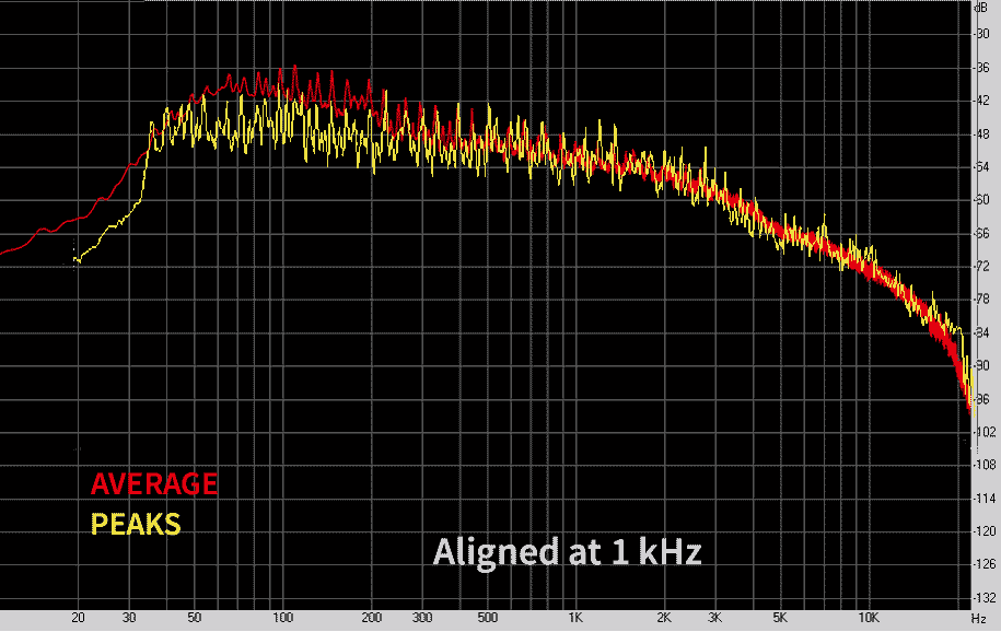

:eek: Sorry about the last graph, posted the wrong graphic! Here is the correct one with peaks vs average.

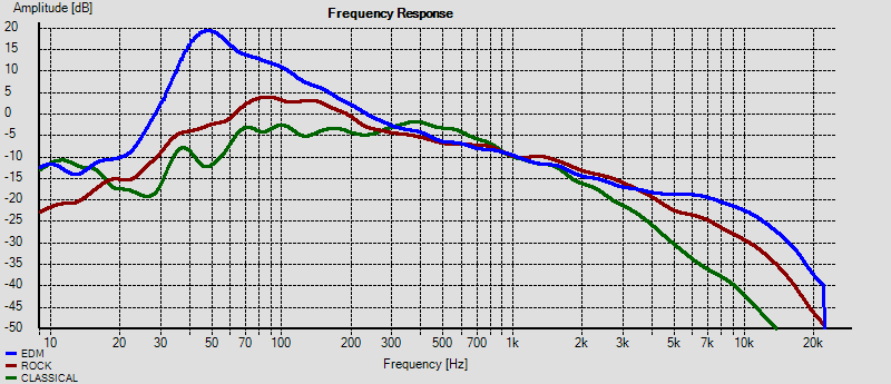

looks like a subwoofer is must for EDM/Dance/Trance. And one can safely discard super tweeter for most music genres.

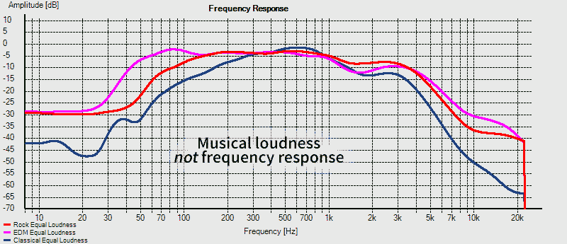

Here is a view you might find interesting. It's 3 types of music, Rock, EDM and Classical Symphonic as seen by loudness. This is not the frequency response of each type of music, but how loud it will sound to your ears.
This is approximate, of course. It's weighted by the Equal Loudness curves. Those change with level, so how loud each frequency band is to you, will change. This is just to give a feel of how loud each type might sound, consider it a view of tonal balance.

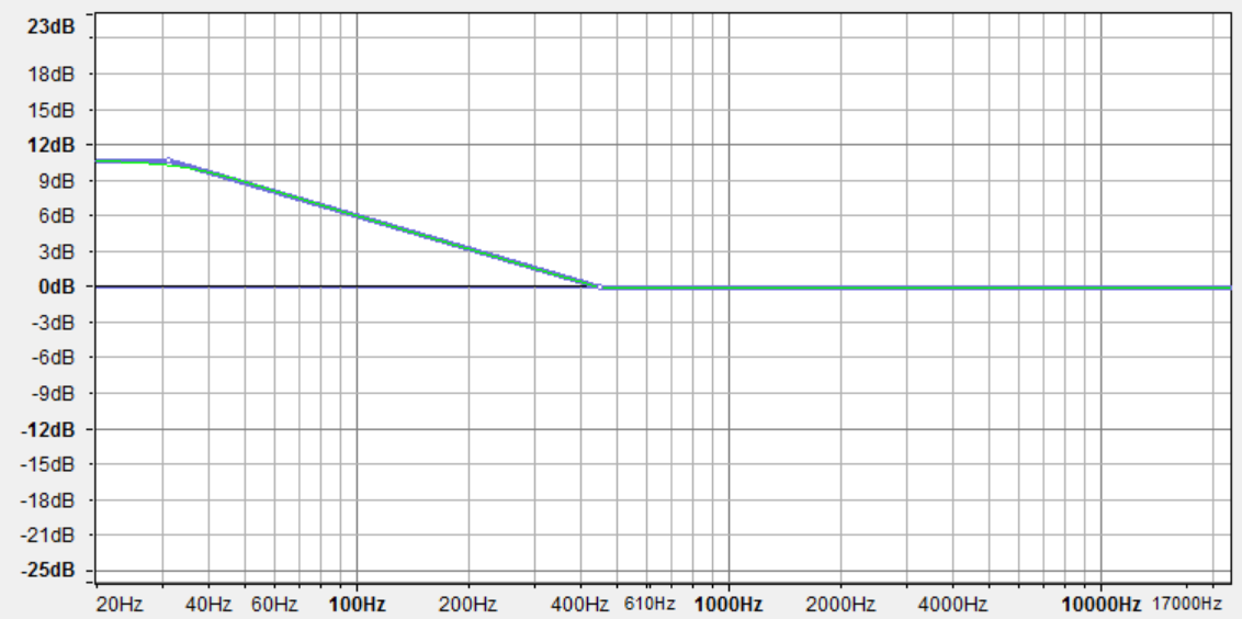

If you pull up the music track in something like Audacity, you can easily see the mastering EQ (attenuation) that's been applied, and hear and see the difference when the EQ spectrum is restored. The reason for the high frequency fall off is generally due to the miking distance--usually on the order of 3-5 metres/yards from the musicians. The HF spectrum will have greater relative amplitude than a string-only orchestra if wind instruments, particularly brass, and percussion accompaniment are written into the compositions.
With classical recordings, I find the following EQ curve within Audacity is a good place to start. Sometimes balancing the "tilt" of the EQ spectrum is needed after finding the correct bass EQ, as well as normalizing/moving the entire EQ curve down if the bass restoring EQ results in clipping.

Chris,
Can you post a frequency response at the listening position in your room? Even a 1/3rd Octave smoothed one is fine. I am interested in the overall shape. It seems like you are compensating for the speaker's response by boosting the bass in the recordings. I have several classical recordings, and I find them to be most pleasing, and do not find the need to apply such high levels of boost to the low frequencies.
