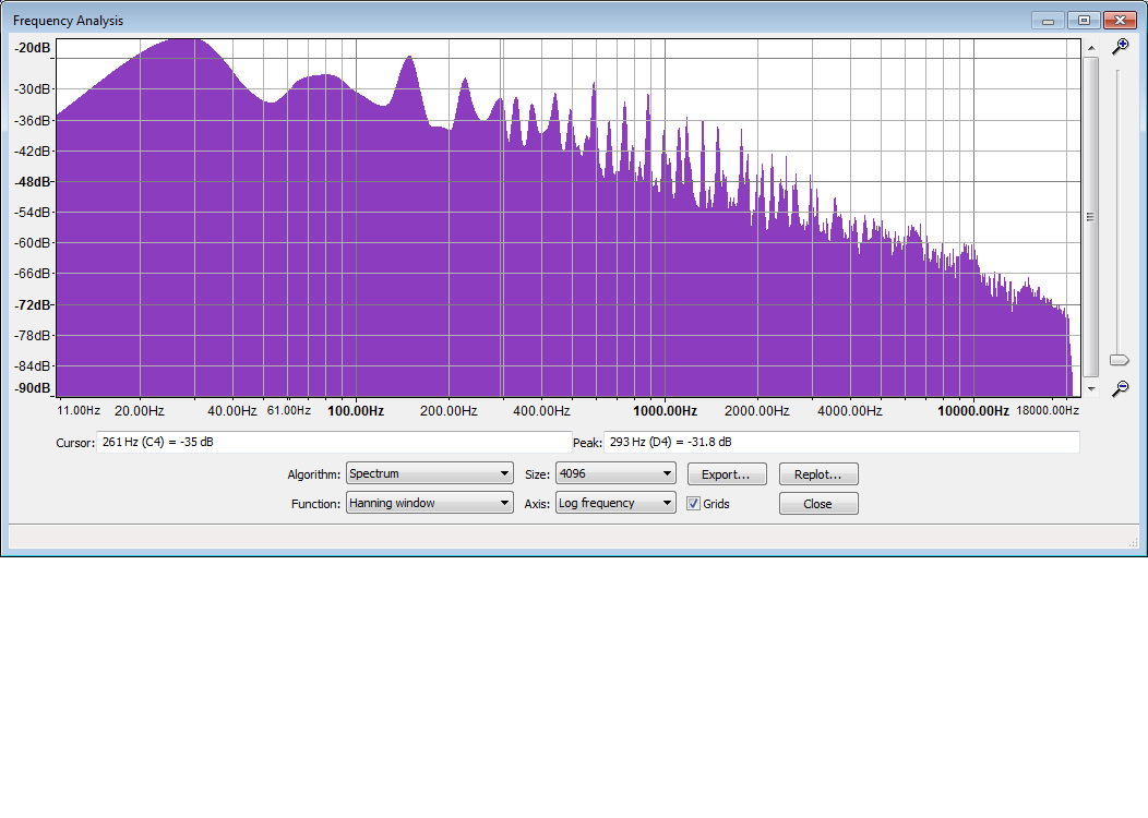

wrt to the 5.1 having more low end I have noted that Chandos, when they do a hybrid SACD release the redbook layer with the same low end as the 5.1 . An example shown attached from the remastering thread. There is a lot of LF energy which is part of the venue and I think something missing from the realism in a normal home environment. It was recorded in Royal concert hall Glasgow which is a 2500 seater auditorium. Note this is one small sample not a trend of any sort. But I do recommend the label for great recordings.

Maybe I'm not reading that right, but it looks like you are saying that the Chandos SACD and Redbook versions have the same low end?wrt to the 5.1 having more low end I have noted that Chandos, when they do a hybrid SACD release the redbook layer with the same low end as the 5.1 .
And Chris is saying that SACD typically has more low end?
