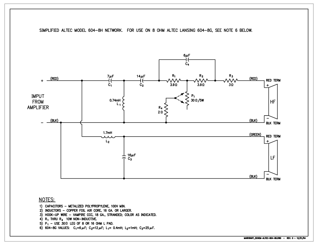

Thanks for the schematic. I don't think I've come across that one before. I've read some posts where people say the factory crossovers are not worth upgrading, but I'm not sure if that's true. I was looking into the parts for the Markwart crossover, which seems to be highly recommended. However, when I started pricing the higher end components that most people are using, like audiophile or NOS motor run capacitors, they started to get pretty expensive. So I started looking into lower cost parts like Dayton caps from Parts-Express, but I don't think I've come across any examples of people using those parts yet. So not sure it's a good idea.
Here's a screen shot of the part list I put together if you have any feedback. I think it's still missing a couple parts like L-Pads. By the way, I've been listening to the speakers a lot and they are sounding great. Bass definitely isn't a problem. It might be a bit too boomy right now, but I think that can be addressed with thicker baffles, bracing, damping, furniture in room etc. The highs can be fatiguing with my SS Yamaha amp, but they sound smoother with the Scott tube amp.

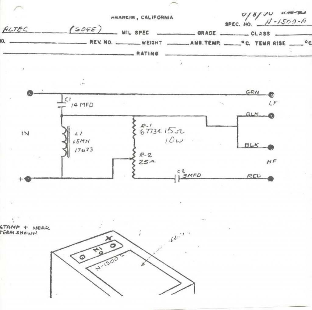

@streetcore
Ticknpop isn't doing you any favours by posting the schematic for the 604E duplex ( which is a 12-16 ohm model ) while your 604-8G's have 8 ohm voice-coils.
IOW, don't use the N1500 schematic for your 8G's .
Jeff Markwart published an updated 8G network that's worth sourcing ( the values for the 8G are in Note #6 ).

Thanks EarlK. I noticed the other schematic was for the 604E. Didn't know the impedance was different, but would have done more homework if I decided to go that route. I have the Markwart schematic and the parts in the shopping cart I shared are based on his notes for the 604-8G.

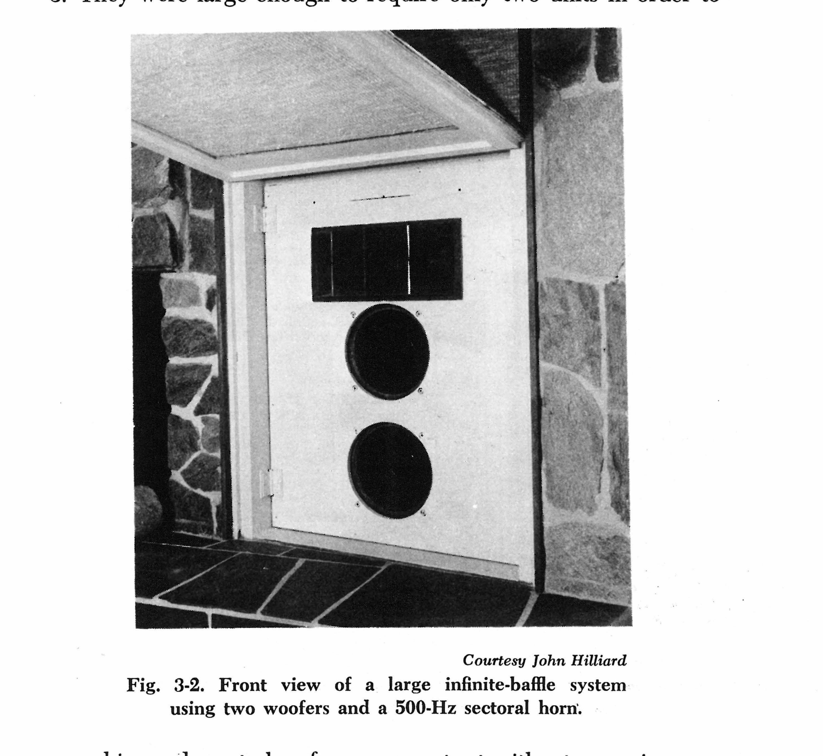

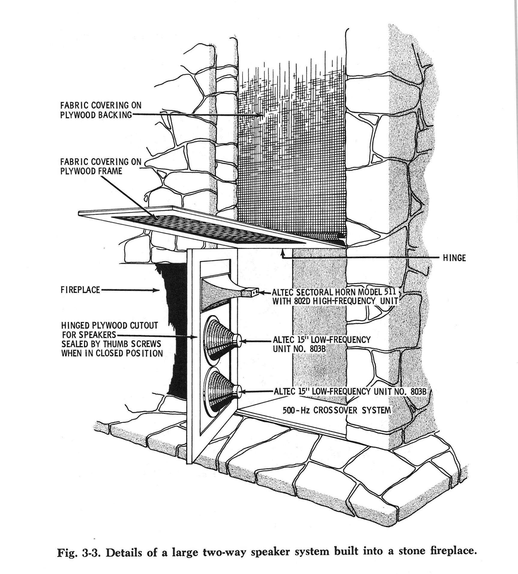

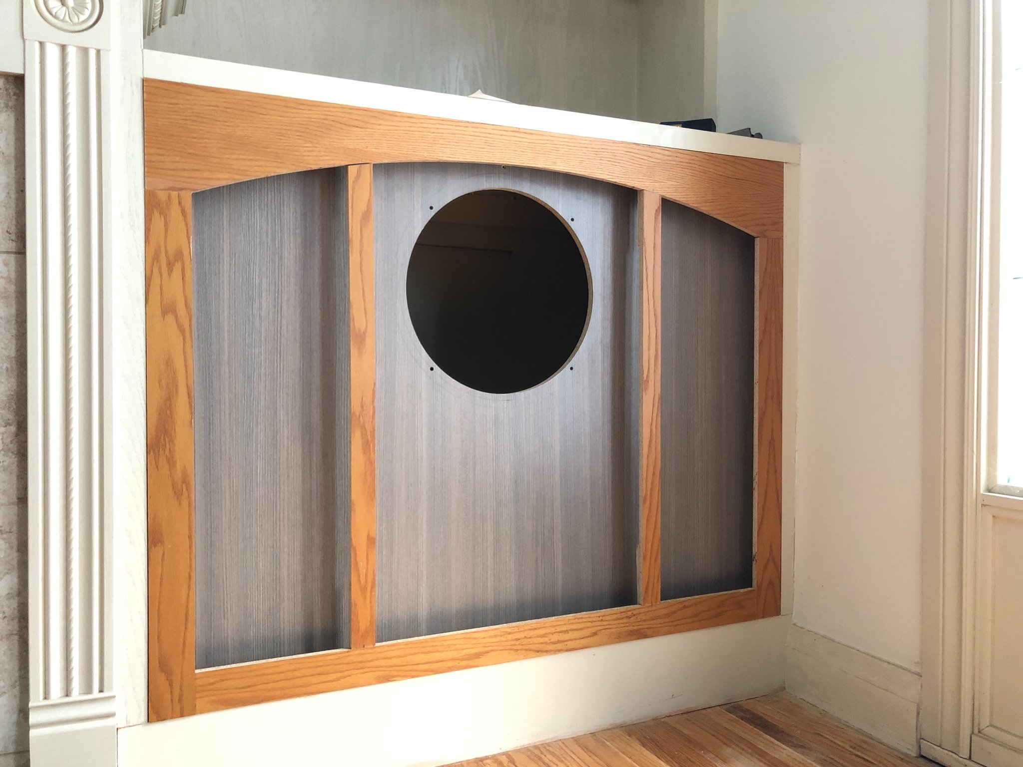

It's been slow going, but I've been making some progess on my built-ins. I'm the kind of guy who needs to test lots of ideas before commiting to a design or materials. So I've been making sketches, drawings, cardboard cut-outs, and prototypes out of scrap wood. The picture below shows where I'm at now and I think I may be happy with this design. The final outer frame will be a bit more elaborate with a traditional cope and stick construction similar to cabinet doors or a window sash. I've also ordered some samples of Guilford of Maine FR701 fabric for the grills. With such large grills, the correct fabric will obviously be crucial to making this project aesthetically pleasing.
I've also taken some inspiration from the book GM posted a while back. It has a section about infinite baffles that includes the images below of a large two-way system built into a fireplace. I like the idea of putting the baffle on hinges so I have easier access to connect wires or make alterations inside the cabinets.

It looks really nice- but I'd think about some thick wool felt on the back of the grille frame, to damp any cavity resonances and the frame itself. You don't want little resonating pockets of air in front of the driver. Good call prioritizing the build and XOs.
Thanks for the compliment and the advice. How much felt are you suggesting? Should I cover the entire back of the grill, except for the area directly in front of the speaker?It looks really nice- but I'd think about some thick wool felt on the back of the grille frame, to damp any cavity resonances and the frame itself. You don't want little resonating pockets of air in front of the driver. Good call prioritizing the build and XOs.
I'd want to basically have the felt compressed between the speaker mounting baffle and the entire backside of the grille, to keep the wood "damped" so the grill frame itself doesn't vibrate (the altecs can move some air!). You could use foam or another gasket solution, felt is nice because it's not sticky and is a little porous and absorbent, f11/f13 wool felt is preferred but not required. You seem to be handy enough to manage a good solution, the real goals are to prevent the grille itself from singing along with the music too much, and to prevent any cavity resonances in the spaces between the baffle and grille frame, you can use a less acoustically absorbent solution or other alternatives if you can "fill in" those gaps and keep the baffle from being too free to vibrate. .
