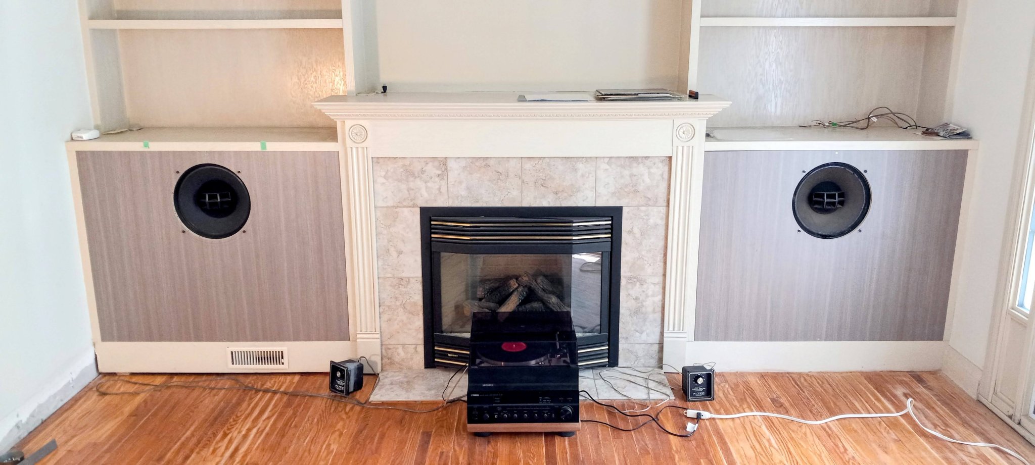

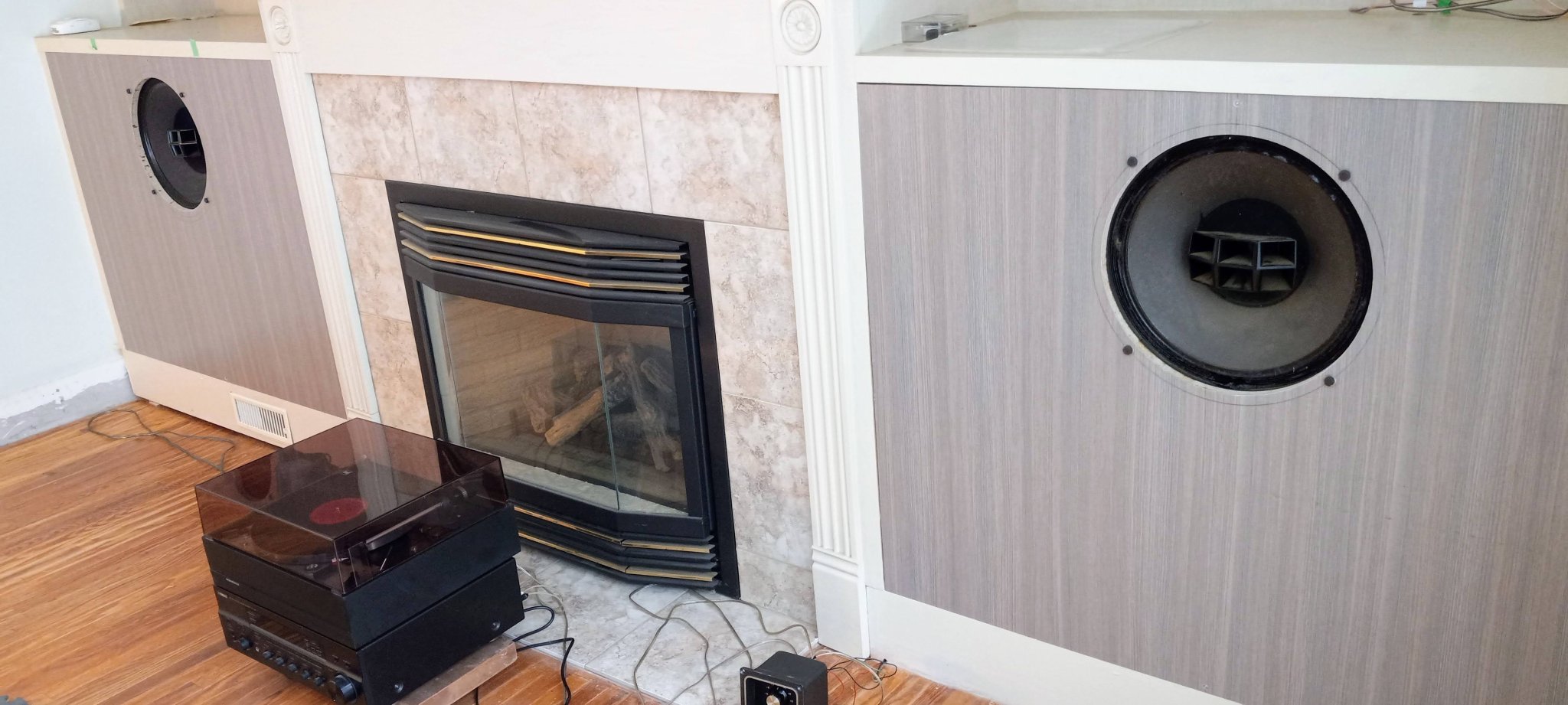

Well, the experimenting has begun. I had a sheet of 3/4" particle board in the garage, so decided to make a couple quick baffles just to get a better feeling about whether this is an idea worth pursuing or not.
My expectations were pretty low since I've added no additional bracing or damping to the cabinets or baffles yet, the speakers are firing straight ahead with no toe-in, one driver needs a new surround, my SS amplification is a poor match for the Altecs, and the room is empty at the moment, since I removed the old carpet and started refinishing the hardwood floors. So there are a lot of reasons why this should sound like crap, but I have to say I was pleasantly surprised. 🙂
There is obviously room for improvement, but I can certainly hear the potential and could almost live with the sound the way it is. So I'm definitely going to pursue this project further. Any suggestions on how to proceed with bracing, insulation, etc, would be much appreciated. I think I could add some toe-in by setting the inside edge of the baffle back a couple inches, but not sure if angling the speakers in relation to the rear and side walls is a good idea or not.

Pleased to hear that. It looks like you've just about made the best of the situation.
From here I guess I'd do a little equalising and look at hanging drapes along part of the side walls.

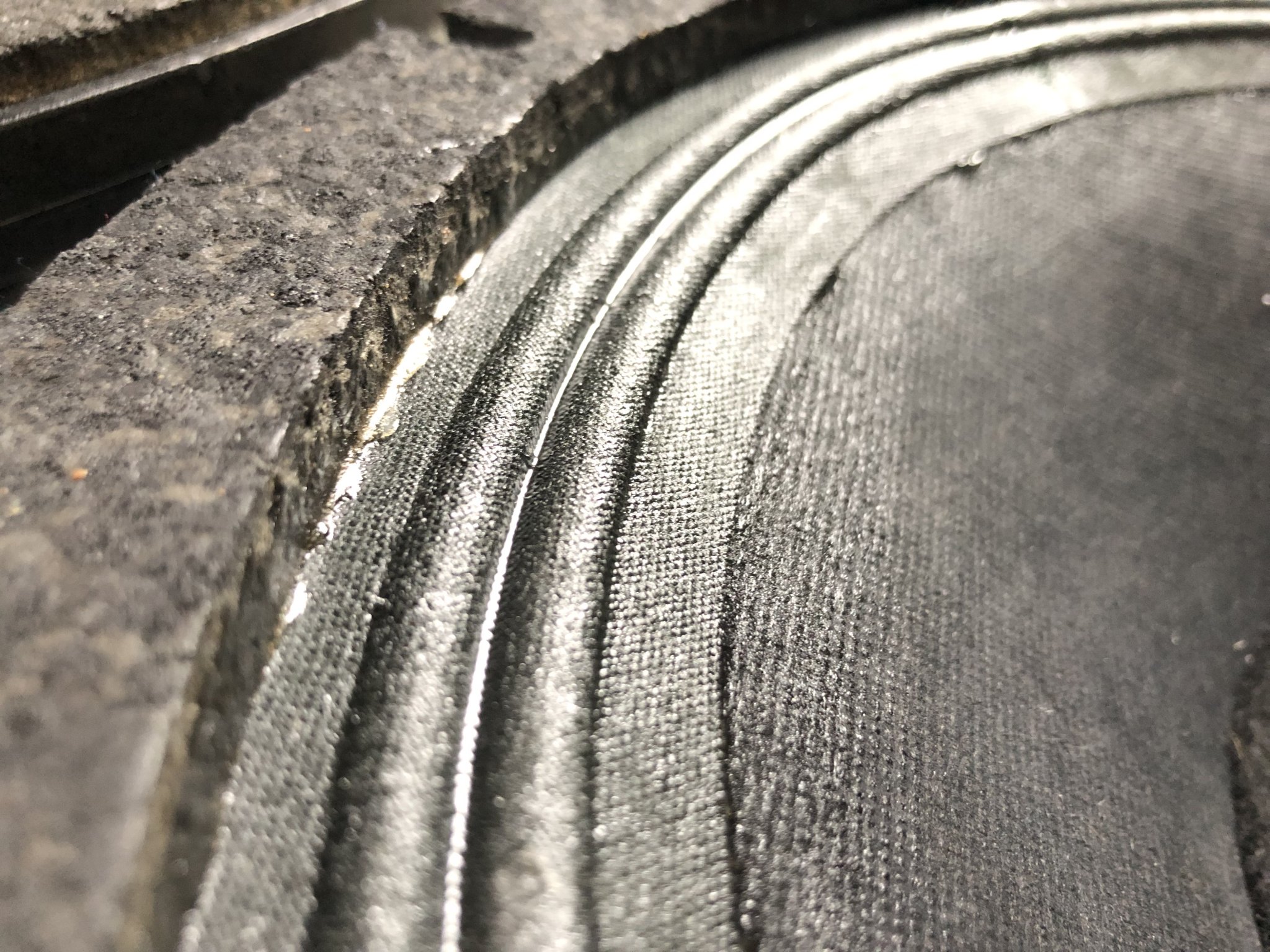

I've got a little update and I'm not a happy camper right now. I took the Altec's to my local speaker guy to repair the surround, but I'm worried he messed them up. Before I took them over I sent several pics showing the damaged surround on the one speaker and asked him if he wanted me to purchase the recone kits. He said no need for a full recone and he could "replace the surrounds and repair the cones" for $75. He's been doing speaker repairs for more than 40 years, and has done a few other speakers for me, so I trusted him to do it right.
Well, he just emailed me saying they're ready to pickup and included the below photo of the "repaired" speakers. I could tell immediately the surrounds he used are different than the originals and they look like foam, not cloth. Now I'm worried I'm going to be boxing these up and sending them to Great Plains Audio to be repaired properly. I'm in Canada, so shipping alone is going to be expensive. The other option is to order the recone kits and try doing it myself. What a disappointment 😢
Here's the pic he sent me. Any feedback or suggestions on next steps would be much appreciated.
They are treated paper surrounds similar to the originals, Santon Audio has reconed over 200,000 speakers over 40 years - maybe thats your repair place, they know what their doing - rest easy unless you want exact originals. ( and it will cost you both for the recone and the shipping. You could possibly get the cone kits to recone locally - cheaper, but still won’t be cheap
Thanks for reply. It wasn't Stanton, but maybe that's where my speaker guy got the parts. I hope you're right about them being close to the originals. I just wish he had told me what he using and that they would look different.
The originals should have been treated cloth surrounds but it's hard to say what you have now. I am leaning toward ticknpop's suggestion that those are paper. The important part is to have the same, or very similar compliance, which one must assume that your guy cross referenced to ensure they are correct. You don't take a classic driver like that and throw any old thing at it. Perhaps ask gently about the difference. I say gently because the speaker guys can be an ornery bunch when poked or prodded. 🙂
Looking further the new surrounds they could be cloth

I haven't picked them up yet, but I messaged him and he said "cloth surrounds all perform the same, almost no movement".Looking further the new surrounds they could be cloth
That's why I reacted the way I did when I saw the picture. Given the choice, I would have been happy to pay more money to get the correct surrounds installed. Hopefully, he took compliance into consideration and the performance is not impacted, but I do think the resale value has been reduced just based on the appearance. I don't plan to sell them now, but I don't know if this built-in speaker experiment is going to work. So they could be up for sale in the future . Anyone who knows anything about these speakers will be able to tell the surrounds are not correct. I also know I'll have lingering concerns about whether I'm getting the most out of these speakers and whether the repairs where done right.You don't take a classic driver like that and throw any old thing at it.
Got the speakers home and surrounds are cloth. He was pretty adamant that they will be the same as originals, but will require some break in time. I asked where he got them, and he said he ordered them from the states and didn't elaborate. He's a nice guy who does good work at reasonable prices, and he's also only guy in town that I know of. So I didn't want to poke or prod too much 😉They definitely look better, that's for sure. He said he had to completely disassemble them and cleaned up some corrosion and other crap around the voice coil.
Not sure why he went with what's known as an "M-roll" (two rounded bumps) instead of a standard pleated/corrugated cloth surround, like the originals. Those surrounds are available in the USA, probably just as easily as the ones used there. I have repaired quite a few 416s, 604s and such, with these surrounds.
Those M-roll surrounds are usually stiffer (which raises the Fs a bit), and have different damping behavior, compared to the originals. I don't know if it will be a detriment, an improvement, or a wash (not better or worse), but it definitely will result in a different frequency response than the original surrounds.

Yeah, I wish he told me what he was doing and why. I would have definitely preferred the original pleated style and offered to order the Speaker Exchange recone kits for him. He said a complete recone wasn't necessary and I trusted his expertize. But then today he told me the cones were different sizes because one had been reconed previously and they also had two different spiders. So it sounds like recone kits would have been a good idea.
I definitely learned a lesson here and will ask more questions next time. Thankfully, nothing he did is irreversible and I could always have then redone again in the future if I really like them. I paid $225 for the speakers and $120 for the repairs. So I've only got $345CAD into them now.
