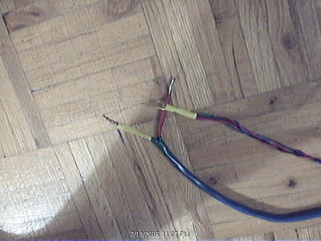

Ok i am ending this thread about speaker wire. At least ending it for me. I put on the stuff i have been twisting for two days . Each lead had 3 sets of twisted pair 18 guage silver over copper communication wire. For a total of 6 conductors per set of + and - . Each set is 6 foot 7 inches long give or take an inch. Dead short reading trying to get a resistance measurment so i am guessing my meter isnt that sensitive. Also wouldnt read capacitance went to the error beep. Measured .017 mH up to .028 mH on the 4 total leads.
Each set goes from the output of my amp to the passive crossover which is jury rigged directly to the terminal leads into the speaker cabinets, so no different wire in there except inside the cabinet from terminal to speaker.
My GF her brother me and my rich "i have to many toys to enjoy" neighbour.
Warning Sign by Coldplay. Played it like 50 times and never want to hear it again.
Long story short. Wait actually ill add this. According to a chart we found on line we have nearly tripled the surface area from the single lead 16 guage wire that we replaced. But no more excuses.
the Midrange changed. That was the consensus. Nothing else was apparent. I dont know if it was removing the extra 3 feet and mounting the crossover direct or what. I put the 16 gauge cheese wire on played the song a few times and then put the twisted pair DIY stuff on and the midrange changed. Wasnt even a 5 minute argument. Now the debate (5 glasses of red wine in) is whether or not the change in wire strand count was the difference. Who knows. Anyway, this thread was thouroughly entertaining. But in conclusion and in my own 'opinion' I could have went out and bought cheesy wire, like 12 gauge or something and been perfectly happy.
Time for an amp or two or three. Must go active and remove this electrical storm from my speaker line.

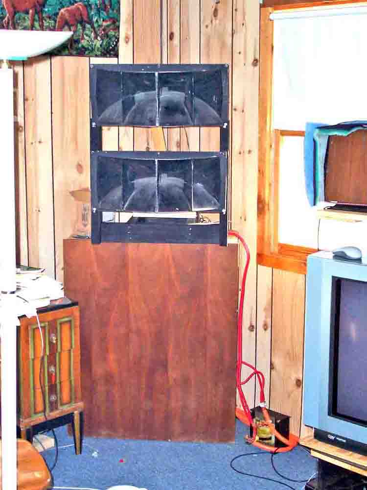

When you talk about monster speaker wire and its size or conductivity you are really talking about increasing the damping factor to your speakers in the final analysis.
All wire has resitance and the longer and smaller the wire the greater the resistance.
High wire resistance creates low damping, and is the mortal enemy of clean uncolored sound.
It has been claimed in tests that a person cannot hear the difference in damping once a damping factor of 200 has been reached, (or 20 depending on which formula you choose to use), However for some reason I can hear and appreciate the difference.
I use double 00 gauge welding cables, at about .85/ft, where the copper is physically the same diameter as a dime for my speakers, coupled to a low impedance amp, the crown k2 which has a damping factor of 3000 in conjunction with bass crossovers wound with number 4 square, (the size of a pencil), which yields a damping of approximately 400 at the speaker terminals.
(an alternative and ideal solution would be to put an amp within 1 foot of the speaker and use standard number 14 zip cord to get optimal damping that would equal that of your chosen amp).
This particular system is so clean and dynamic I tend to prefer to listen to this instead of most of the local live bands around here... (after all they dont have the equipment to asound as good as the huge bands do)
For those who are interested here is a neet damping calculator for you to get an idea of where your own systems are as compared to the 200 claimed minimum... for wires larger than those that they list just enter the resistance per foot and it will use your entry for the calculation of damping.
Also for those purists who want their speakers to have even bass from left to right remember to size the wire for an equal damping factor on the left and the right or the sound, (especially the bass) will tend to pull toward the least damped side and color the stereo image...
so for an example if you have 4 ohm speaker system with a 3 foot run of wire from the amp to the speaker terminals, you may want an awg14 to obtain a minimum damping of 200 to that speaker, and if your second speaker is 8 feet away from the amp you would want to use an awg 10 wire on that speaker to obtain equal damping factor for your left and right speakers. Another method would be to use equal length wires but remember not to coil up the excess wire...
http://www.autohifi-world.de/fack/dampfact.htm
The attached picture is about a year old and you can see the coil and the relative size of the feed wires... Awg 00 wire runs about 85 cents a foot.
I have since found a bass driver that needs no crossover for my application and have eliminated the coil completely which took my damping to well over 2000 at the speaker terminals and wow what a difference...
Now the bass and mid bass are rediculously tight... (It rivals my brothers Marshall) I am hearing especially bass warbles and grumbles I never knew existed in the music before and i have heard these songs a million times... Also a point of interest foir me is that the bass would tend to start giving out a bit at 115 db you could just begin to hear a slight flutter.... and since I no longer need that coil for the crossover I am able to take it up to an earth shattering 125db continuous peaking at roughly 130db and no sign of flutter except for what I felt on my nose. I frankly could not go any louder as my ears were becoming numb after listening to it that loud for a few minutes...
I feel that extremely high damping and equally damping the left and right speaker is the single most important factor in obtaining exception sound quality from any speaker system... Second is a good equalizer that allows spike removal such as the beringer deq 2496 and of course you cannot beat a super low impedance fet amp for high damping and fast rise time.
