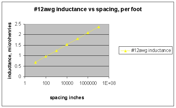

Well, one has to admit, inductors are also a bone of contention for some. And, the actual device is designed for flux coupling and specified energy storage characteristics..vc's are the same, but they also have different design criteria..
Inductance measurement of a single wire has little meaning, as it requires forming a loop, which is not consistent with end use. I'd use the Terman equation first, unless the wire design was some goofy thing..Johan Potgieter said:I must agree with you, Mike. Let us get a little sense here. I measured a number of loudspeaker cables for L and C (R being irrelevant in home setups) and found the highest C to be 220pF per 3m length; inductance of 3 microhy. Taking into account that normal 8 ohm loudspeakers rise to some 30 ohms at 20 KHz, the -1dB frequency would be 250 KHz (actually shifting to the MHz region because the loudspeaker impedance keep rising). Furthermore this inductance was for 1 wire. Normally with 2 leads being together, current would flow in opposite directions, substantially cancelling inductive effect.
