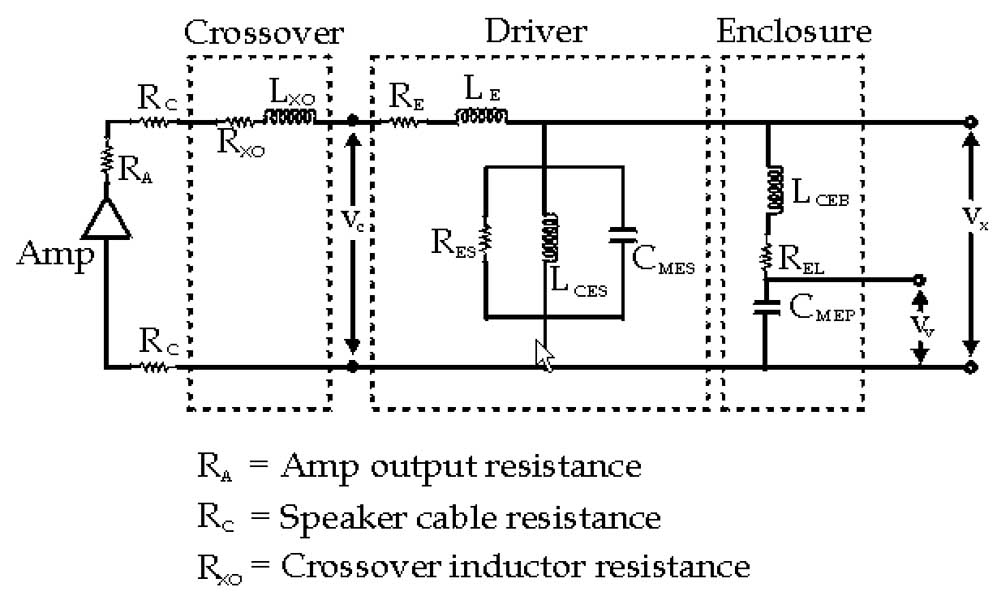

Effect of speaker cable resistance and amplifier damping factor
The results presented in this section include the effect of .04 Ohms amplifier output resistance, corresponding to an amplifier damping factor of 200, 10 feet of 16 AWG zip cord speaker cable with .04 Ohms per side, and .32 Ohms crossover resistance. (see the equivalent circuit schematic [6.5kb]). For the bi-amped configuration the crossover resistance is absent, and the circuit is more sensitive to cable and amplifier resistance. For this case, the effect of increasing the amplifier damping factor to infinity, and increasing the cable size to infinity is simply to produce an imperceptible 0.2-dB increase in SPL level. Did the infinite damping factor give the amp "greater control" over the transient response? No, the difference is imperceptible.
So the effect of increasing the damping factor beyond 200 is insignificant. And the effect of cables is insignificant, unless the cables are a lot longer, and/or a lot smaller.
I know many audiophiles will not believe this result. I would only say that there are many things that engineers do not understand well, but circuit analysis is not one of them.
The complete Thiele/Small damping circuit model is in the pic below for those of you who are ee's and not on some planet with the belief damping is all a sham...
If you dont believe Thiele/Small you should just go to the store and buy a set of speakers like carlos did ...
Here you go mike and anyone else interested... right from the leading authority on speaker analysis whos work is used as a standard in the industry... Hope you find this encouraging Mike!
My advice folks is to fly with the driver gods, (Thiele/Small ), and dont be fooled by the fanciful dreamers...
We all know who on this site has been preaching this since his first post on the subject and caught all kinds of flaq from the dreamers for doing so! But I wont mention who that was!
I rest my case!
