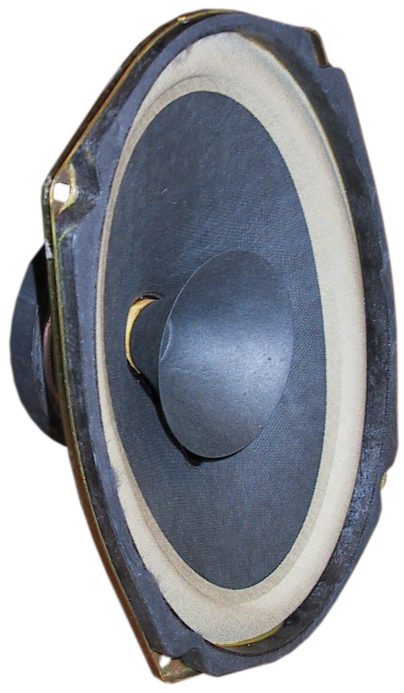

If these speakers actually cost more than the foam surrounds do, and if they were just raw 6x9 speakers, than go for it - what would you have to lose? But there are two things to carefully consider, and everyone was trying to warn you of. 1. The value of the speaker is likely less than the cost of the repair kit. You have to ask yourself if it’s worth the twenty bucks - if you sent it to a shop it would be 60. 2. Getting that tweeter bridge off so you can shim the VC is not going to be as easy as you think. Can you even get it off in one piece? I’ve never been able to - at least not without making the tweeter assembly worthless in the process. Try to get the tweeter bridge off first, before buying the repair kit. Don’t do this step backwards. If you bugger it up, it will save you the twenty bucks, and you can put it toward a new speaker.
im pretty sure the bridge is bolted on from the backside.
I dont care they are worthless (people on fleabay seem to think they are worth 200+ for used ones i guess *shrug*) and i do not care how they sound. The car is already a tin can resonance chamber. None of the speakers have padding on the back side, the magnet sticks to the body panel, they are attached to essentially compressed cardboard, and I'm using an ancient pioneer 2 post radio from the mid 80's.
I like fixing stuff. I want to learn how to fix audio stuff. But it seems every time I ask for help on this site, I get shut down from nay sayers. I have an old jvc 5003 I wanted to repair myself. Asked several times, and a handful of members for help. Nothing. Get asked for help with these speakers. Get called a troll and that the speakers are trash. Does it hurt to keep your opinion to yourself to help someone else learn how to fix something? We all need to start somewhere. I want to start with these.
Just get the parts, watch half a dozen videos about refoaming (just to be more certain) and do them yourself.
IF you have some reconer nearby, ask him to do it, practice makes perfect and he´ll certainly have done a few.
From all suggestions above, the one about carefully cutting the dust cover off and shimming voice coil is the most sensibleWhen fully dy 824 hours), youb remove shims and reglue dstcap in place.
Use as little adhesive as posible.
Suspect subframe holding tweeter is glued between old foam ring and cardboard gasket, it must have been added *after* main cone was glued in.
Soften old dried up adhesive with acetone / toluene / paint thinner , it depends on what they used originally.

Let us know how the repair goes. The last time I had a speaker with tweeter on a bracket like yours, I had to cut it off with a grinder - it was tack welded in place. Hopefully yours uses screws.

There are quite a few good resources on Youtube as far as reconing tutorials.
It often comes down to learning how to remove the old surround gracefully.
You just have to do your homework and see if you can do it. Worst case, you spent some money and maybe learned something.

We seem to have lost track of the original question.How would I go about finding replacement foam for the woofer?
How's that going Foxx? 😉
I don't know where you are based, but here is a supplier of 6 x 9 inch oval foam surrounds: https://speakerrepairshop.nl/en/foam-surrounds/by-size/oval-surrounds/g-20000074
Used this guy many many times , recommended

The Speaker Exchange has them. A LOT of refoam and recone kits. At prices WAY better than they used to be 20-30 years ago.

You might want to look into these: They seem to be rubber instead of foam, and it comes with everything you need. Rubber Edge 6"x9" Speaker Repair Kit RSK-6x9 (PAIR)
