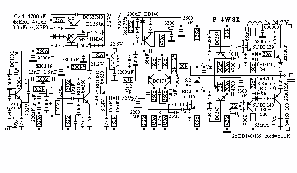

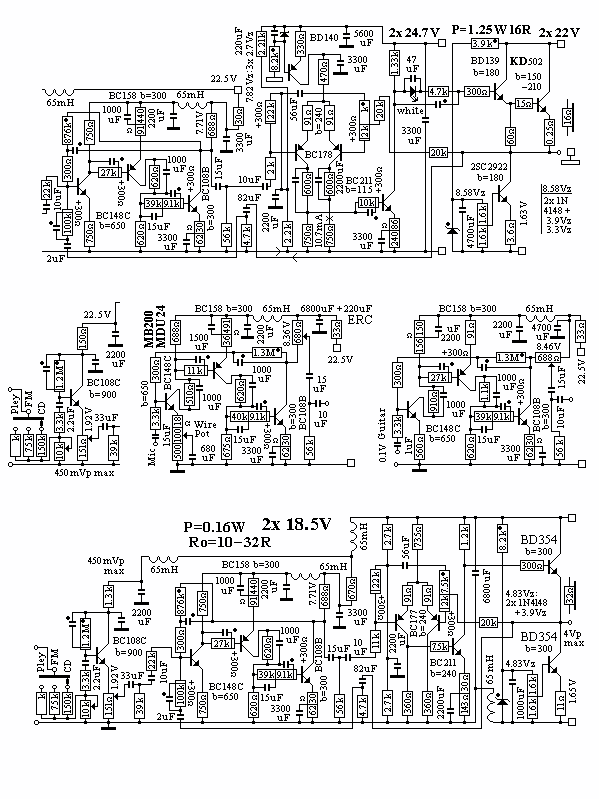

Hello! These are original authentic clean amps -speaker IPOD Power Amplifier P2--- 6W.

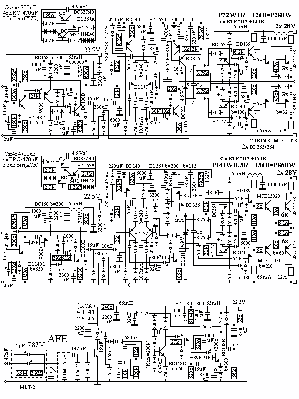

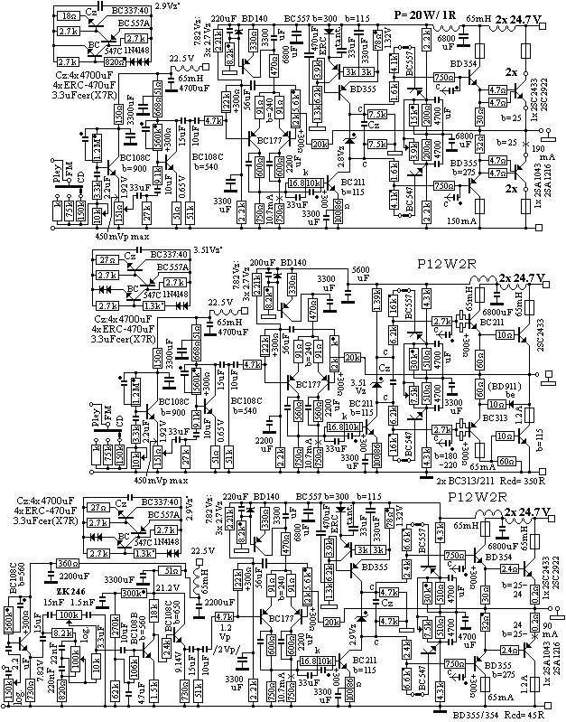

Hi End amplifier Ro = 8R has a dynamic linearity for Ic = 1Ap max and give it a clean power P = 4W8R max.
This is what is in each forum are rubbish amplifiers, the design of amplifiers need to know.
The whole China and America can not do better low-power amplifiers to the IPOD speakers and are these schemes.
Would I be right in reading this as needing a 24.7v power supply?
If so, there's no way this is gonna be any use for small iPod speakers - this might be cheating (as its an IC), but...

To begin with he's specifying 2x24.7V supplies, which translates into 25 to 30W RMS into 8 ohms.
Just do the Math, he won't 🙄
He has no clue whatsoever 🙄
He has "designed" 1 (one) amplifier, very poorly at that, and has posted the exact same schematic with meaningless variations (such as specifying some transistor Hfe 180 instead of 240, or 158K pots (good luck finding them😉) some 150 times by now.
Only useless clutter.
To "justify" it, each time it gets a new name.
All aggravated because they are always the same horrible design drawn in Paint or worse.😡

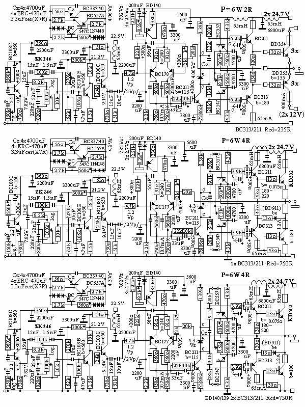

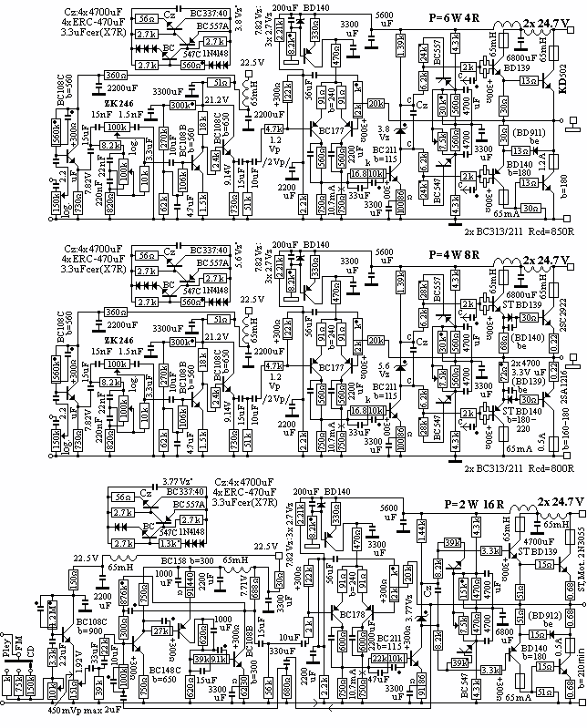

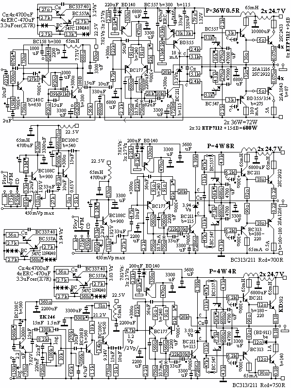

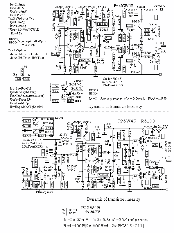

I'll make you a gift-Annex I gave the best audio technology.
Small linear distortion to the speaker is the power of P = 1W max !
The largest musical heat power output of the speaker is P = 3W max, think of yourself !

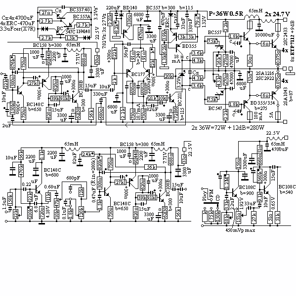

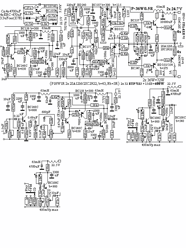

Small correction for P36W0.5R : 430R/430R---2.21k/2.2k end 2.2k+200R/2.2k+200R ---2.2k+270R/2.2k+270R.
Re:
Speaker Rsp = 4R is the linearity of the power P = 1Wp max, which corresponds to the voltage on the speaker 2Vp and 32 speaker Rsp=4R is used an increase of 15 dB amplifier gain, the amplifier P36W0.5R has a power of 215W and two-channel amplifier P = 600W (amplifier has Uo=6Vp for P=36W, 2x 16 pieces speaker has Usp=4Vp! –linearity).
