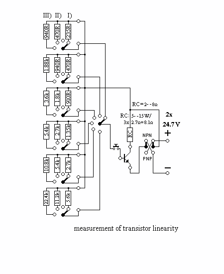

I'd love to describe something more but do not know English. Linear and symmetrical control of the all transistors in the amplifier and speakers good works. Good amplifier strongly pumped speakers sounds of music.

Power transistors are poorly manufactured and DIY is a nonsense.
Enjoy yourselves, the most expensive things in my schema that can not be different.
