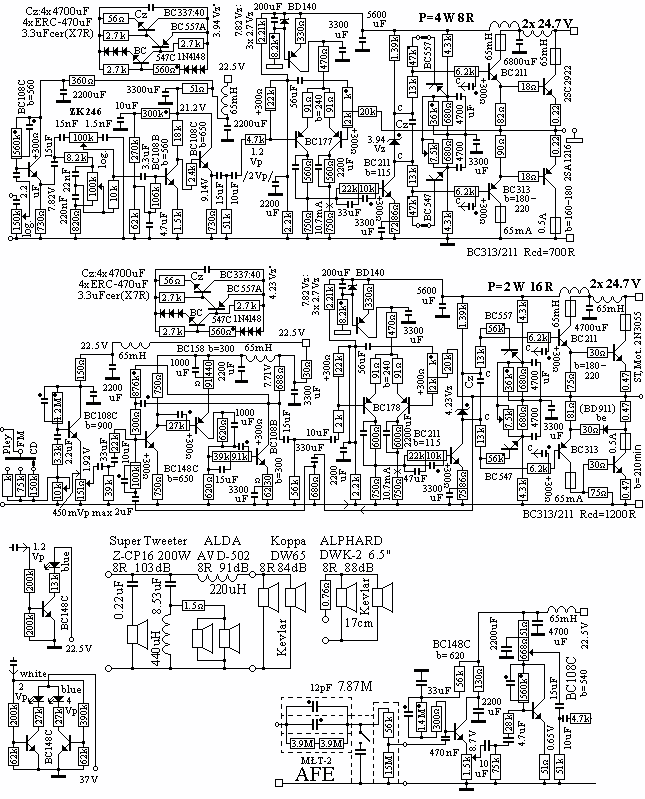

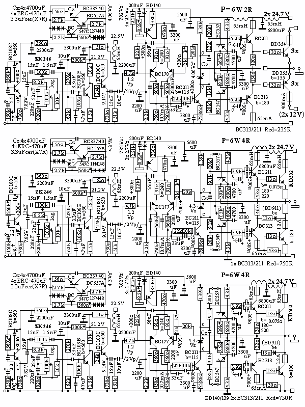

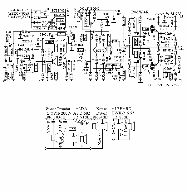

Hello!
Favorite Top hi fi amplifier P6W/4R.
Power transistor beta-lin. 0.25A/0.5A = 0.7% max.
People do not understand: this circuit amplifier as low as the god himself is nothing if it is not exactly perform (1983/STK080 Ro = 4R-THD = 0.0006%).

These are 40 year old industry standard circuits. I've seen them a million times. There are reasons they are not used anymore.
Perhaps you could design a modern circuit that employs the best features of these legacy circuits?

You're supposed to tell us "what affects the quality of the amplifier." If you can't, you should be asking questions, not posting nonsensical jibberish. Most of us here know way more than you do. You don't even know enough to not understand what you're talking about. I hope you don't think that you sound smart. You almost come off as a bot.

If you want to see what's wrong with your beloved classic designs, and want to see elegantly simple and effective remedies of these shortcomings look here. Distortion In Power Amplifiers
I've used some of these solutions before in my own designs, but Mr. Self has come up with a design that addresses all the shortcomings in one design.

its a complete waste of space/bandwidth, surely nobody could really think this is hifi, or even mid-fi.
ive seen this posted as headphone amp, poweramp, low poweramp all in this childlike illegible text and pictures, I cannot call them schematics.
perhaps he has some stocks of all this old crap and cant get rid of it?
