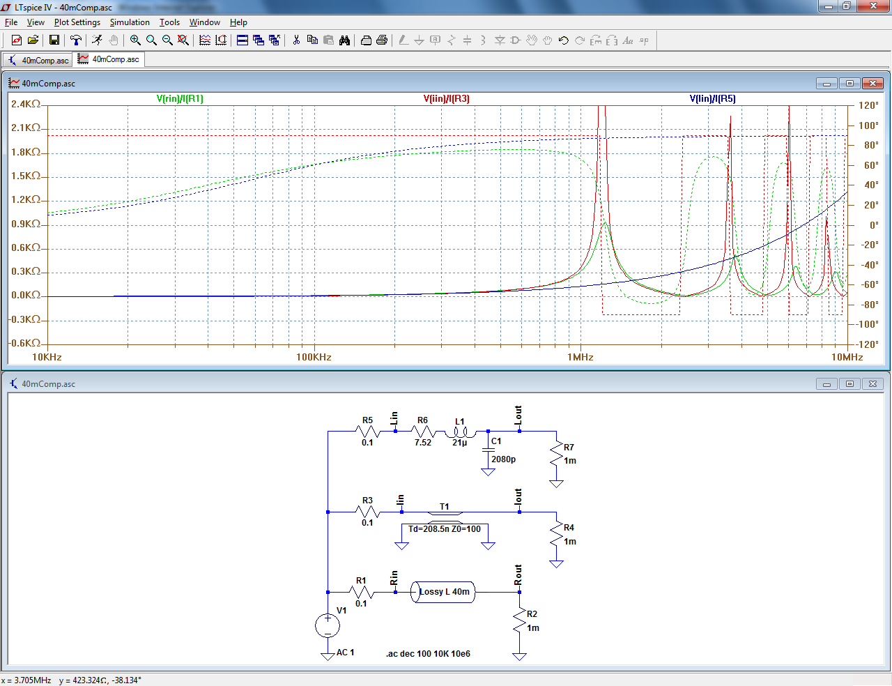

To put things in perspective, here is the comparison between three 40m cable models feeding a 8Ω purely resistive load. The cable has a characteristic impedance of 100Ω.
The impedance seen by the amplifier is plotted from 1KHz to 100KHz (below 1KHz nothing interesting happens) for an actual cable (green), an ideal transmission line having no LF effects (red), and a lumped model (blue).
Despite the 40m length, the effects remain relatively small, but it is interesting to note that the crude lumped model does better than the ideal transmission line, particularly regarding phase (dotted lines).
Next are the same parameters viewed with Nyquist. The markers are at 20KHz.
And finally, the frequency response seen by the speaker (the amplitude of the red trace has been scaled to more or less match the other traces)
Why did you use a series resistance of 7.5 ohms in the lumped model?? Did you mean to use .0075?
I recommend you review your model. In addition, read Cyril where he details why he required 200 lumped elements to bring his model closer to reality. Using one LR and C is not consistent with actual results.

Your model results do not support this within the audio band..

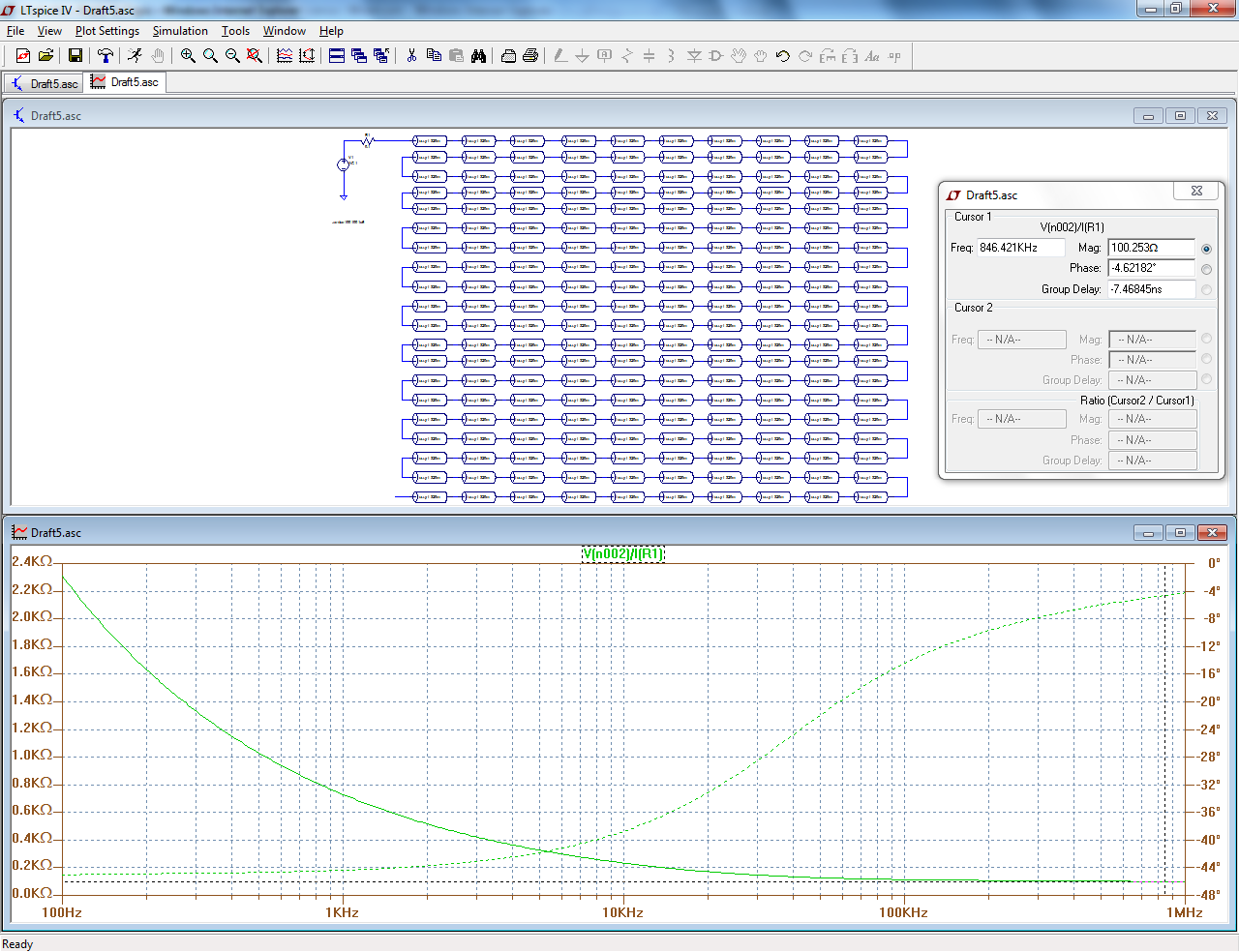

Here again, because the characteristic impedance is an iterative impedance, not a regular one that you can measure with a standard impedance-meter.
However, if the line has an infinite length, the apparent impedance becomes the characteristic impedance.
Below is an example of "infinite" line: 200 segments of 320m are cascaded, giving a good approximation of infinity down to 100Hz.
The total is left unterminated, because it doesn't really matter: the return signal is vanishingly low
No, it is actually 7.5Ω, because the cable modelled is 0.5mm twisted pair.
These are models I had available, because I created them for my work and they would require a lot of work to be adapted for other cables.
The lossy model exactly mirrors the reality: it is not based on lumped elements, and is completely accurate at any frequency.
I have included the (very) crude lumped element model in the previous sim to show that at audio frequencies, it performs rather well, better anyway than an ideal transmission line model
As I said, we're speaking about short speaker wire lengths terminated terribly.
When I said 200 segments, I meant 200 to model the length given, in Cyril's case it was 4.9 meters.
No, it is actually 7.5Ω, because the cable modelled is 0.5mm twisted pair.These are models I had available, because I created them for my work and they would require a lot of work to be adapted for other cables.
Ah, 24 guage, 40 meters long. Not exactly appropriate for the discussion, eh?
It's important to model what is being discussed rather than trying to shoehorn the available model to different circumstances. You're losing HALF the power to the line, certainly not reality..
The lumped element model NEEDS sufficient elements to make the t-line model match the lumped element as well as match real hardware results. This is precisely what Cyril Batemen did, and where the 200 elements came from.
Despite all this discussion, what is being bypassed it the fact that ACTUAL hard measurements of load to line discontinuity caused reflections has been demonstrated despite statements that the line is too short at these frequencies.
Also, if you were to actually put 40 meters of zip into an 8 ohm load, the reflection at the source will be delayed 100 microseconds.. Note that the actual load current will be one prop delay in front of that, roughly 120 nanoseconds earlier...99.88 uSec delayed. That delay is not inconsequential to humans.
jn

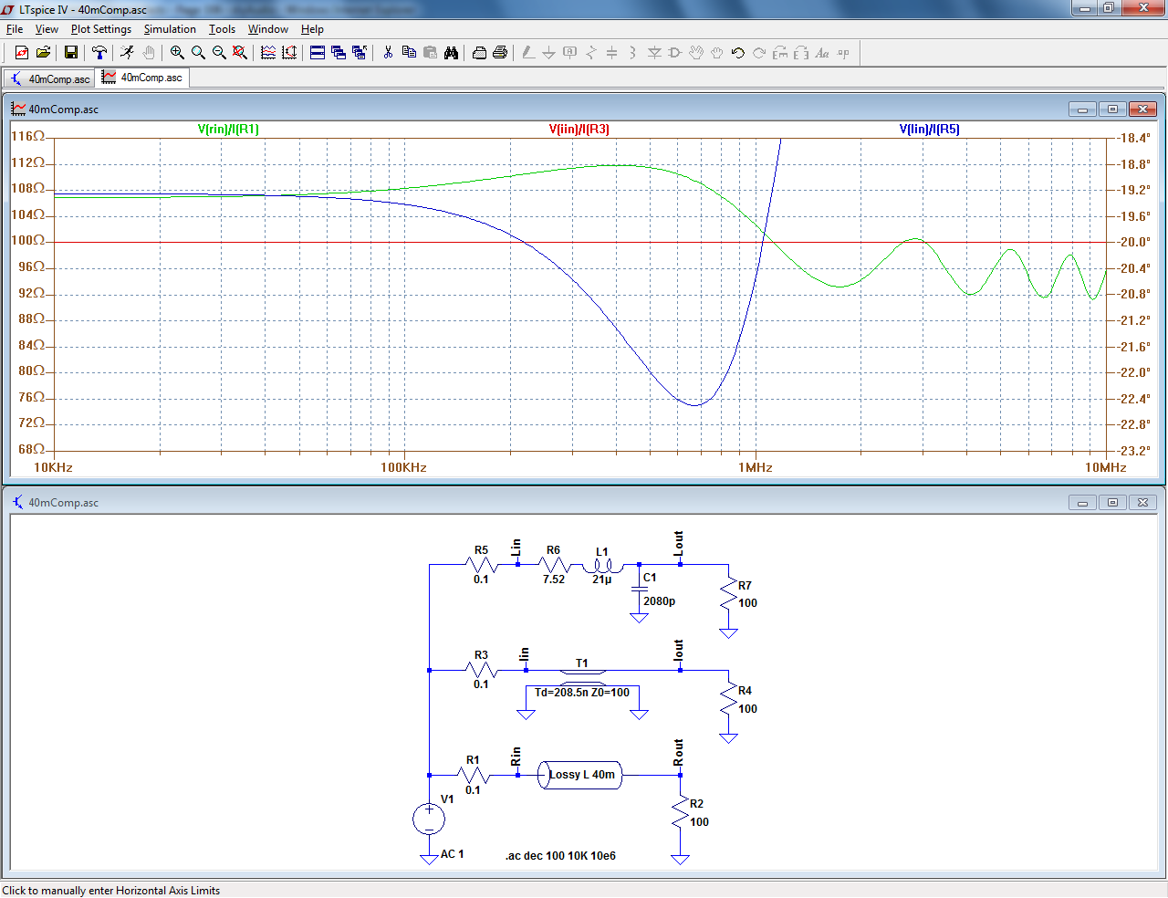

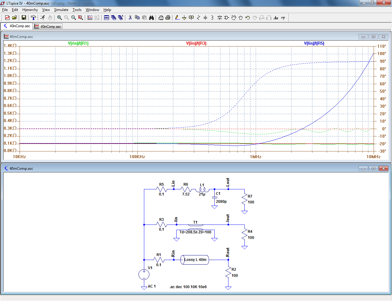

Good work, Elvee. However, it would be even more interesting if you plotted it out to 10MHz. A lot of the fun does not begin until beyond 100kHz.
With plots to 10MHz, it would also be interesting to see these three situations depicted for the conditions of the cable terminated in 100 ohms, the cable terminated into a short, and the cable completely unterminated.
I did that for a 10-foot length of Zip-type Monster cable in Figure 18.4 in my book "Designing Audio Power Amplifiers".
It gets REALLY ugly between 10MHz and 100MHz in the mis-terminated cases. While this is well above the ULGF of most amplifiers, it is not necessarily well above the frequency range where some amplifier output stages can be prone to local parasitic osillation, especially if fast output transistors are used and/or no output L-R isolating network is used.
On the other hand, even ordinary speaker cable terminated in 120 ohms was remakably well-behaved out to 80MHz. A Zobel at the loudspeaker end consisting of a 0.01uF capacitor in series with 120 ohms is all it takes.

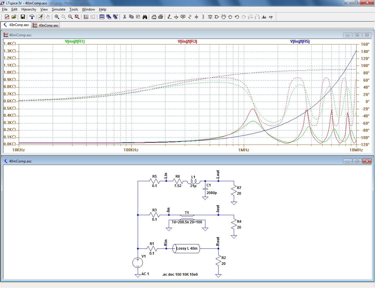

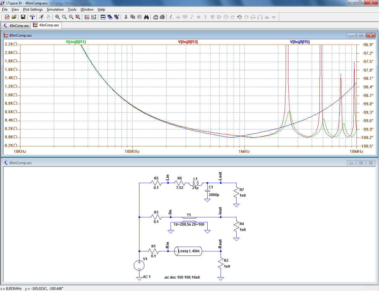

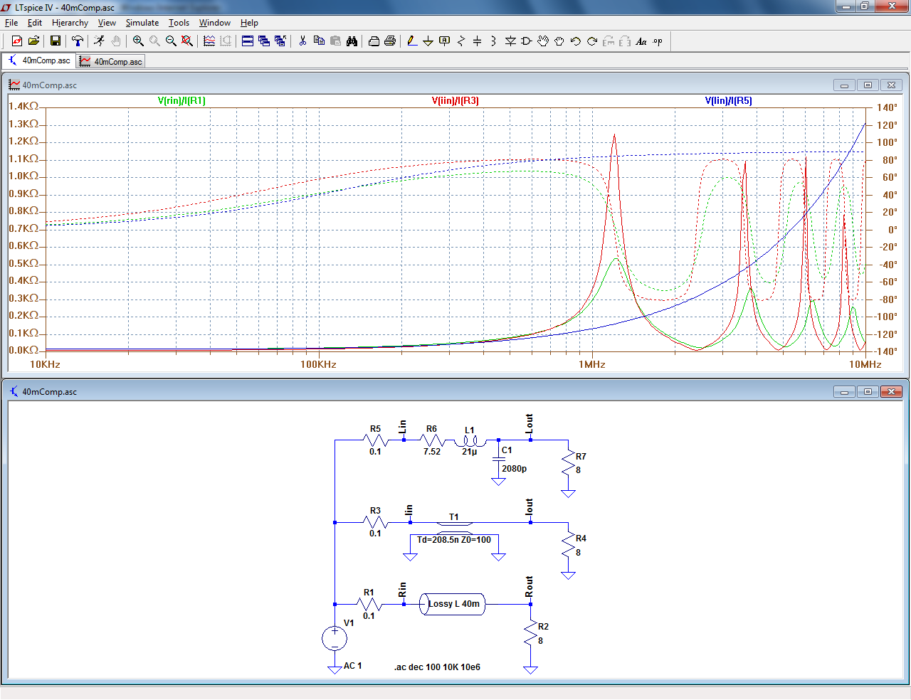

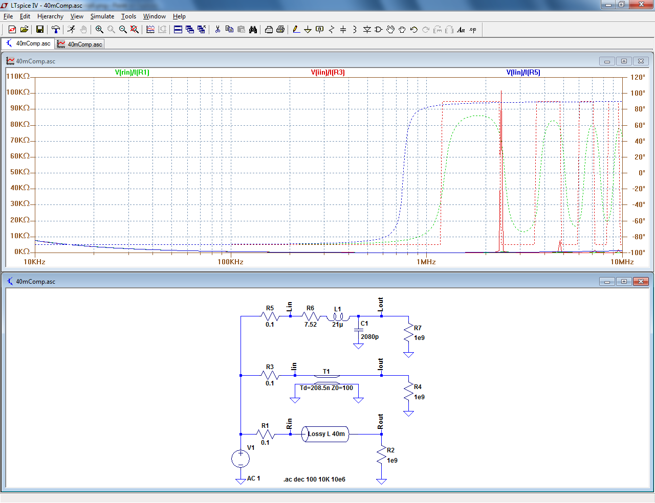

Here you are. I have also included a 20Ω load, partly to adress John's criticism about the lack of suitability of the 0.5mm model, and partly to get a more realistic view of the problem: actual speaker cables normally have an impedance lower than 100Ω, and with 20Ω, the Zo to Zl ratio is better respected.
The 100Ω case is duplicated, to zoom on the finer details.

I am perfectly aware of that. This was just to answer your question about the 45° phase missing at low frequencies.
Note that having a complex and variable characteristic impedance is not without consequences, even for short lengths: these effects will alter the impedance seen by the amplifier
Yes, the 200 number I took is just a coincidence.
Anyway, as I said in another discussion, modelling real lines with lumped elements, even in very large numbers is a poor and crude method.
For physical simulation, it might still be acceptable but for soft simulation there are better options
Not appropriate if we want to discuss specific numerical results, but perfectly adequate to illustrate theoretical concepts like the variation of characteristic impedance with frequency.
My point is that the usual transmission line concepts like matching, etc, are essentially useless at audio frequencies.
If you build a 8Ω speaker cable, it will stay at that value down to a few KHz, at the very best, and go all over the place below: matching makes no sense, you would need to present a load having a phase of 45° over many octaves, together with a variable magnitude, which is completely unrealistic
Transmission line effects are completely agnostic, and manifest themselves wheter the line is 1,000λ or 0.001λ. The underlying theory remains the same.
With a good VNA working in virtual time-domain, you can see incredibly small details.
