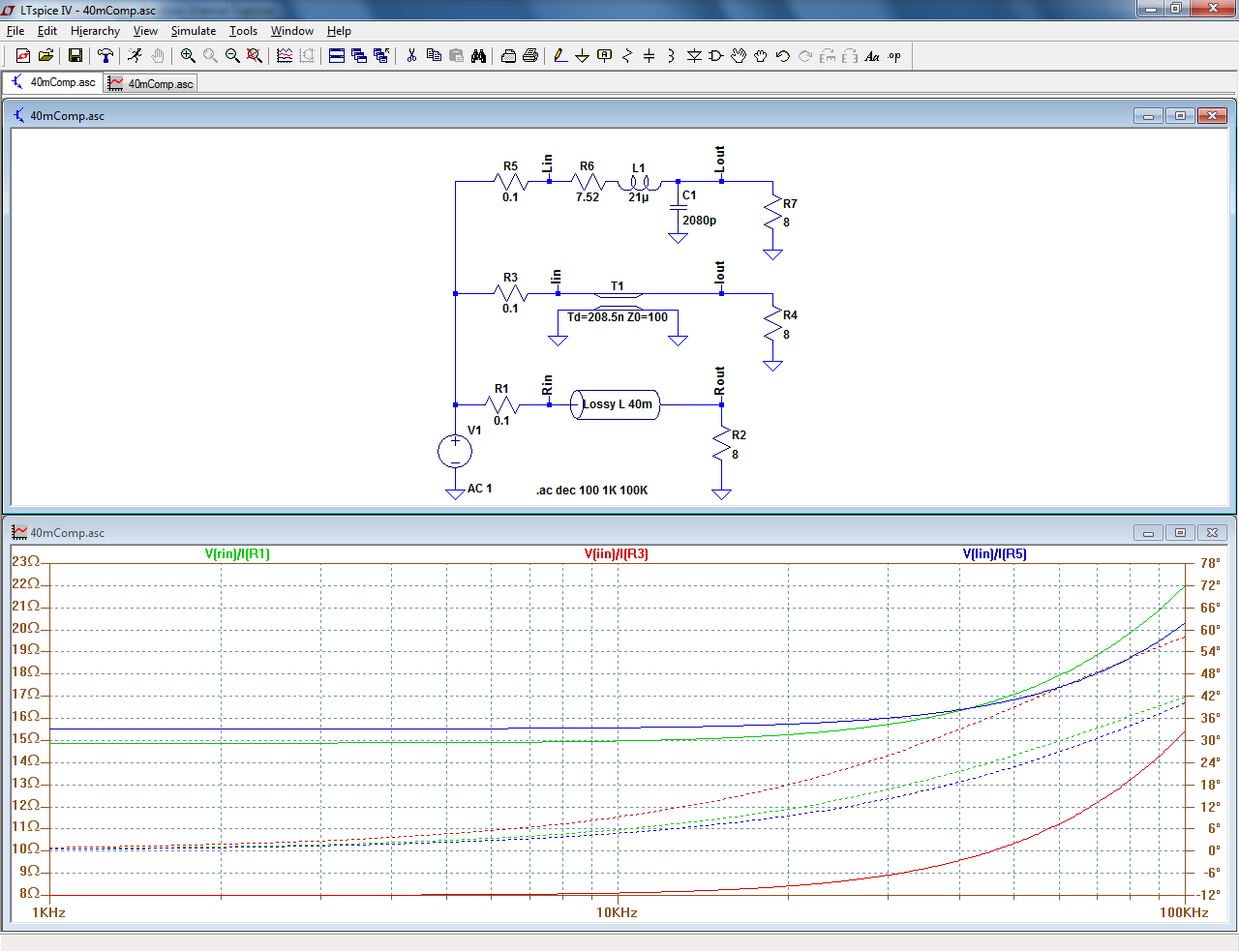

To put things in perspective, here is the comparison between three 40m cable models feeding a 8Ω purely resistive load. The cable has a characteristic impedance of 100Ω.
The impedance seen by the amplifier is plotted from 1KHz to 100KHz (below 1KHz nothing interesting happens) for an actual cable (green), an ideal transmission line having no LF effects (red), and a lumped model (blue).
Despite the 40m length, the effects remain relatively small, but it is interesting to note that the crude lumped model does better than the ideal transmission line, particularly regarding phase (dotted lines).

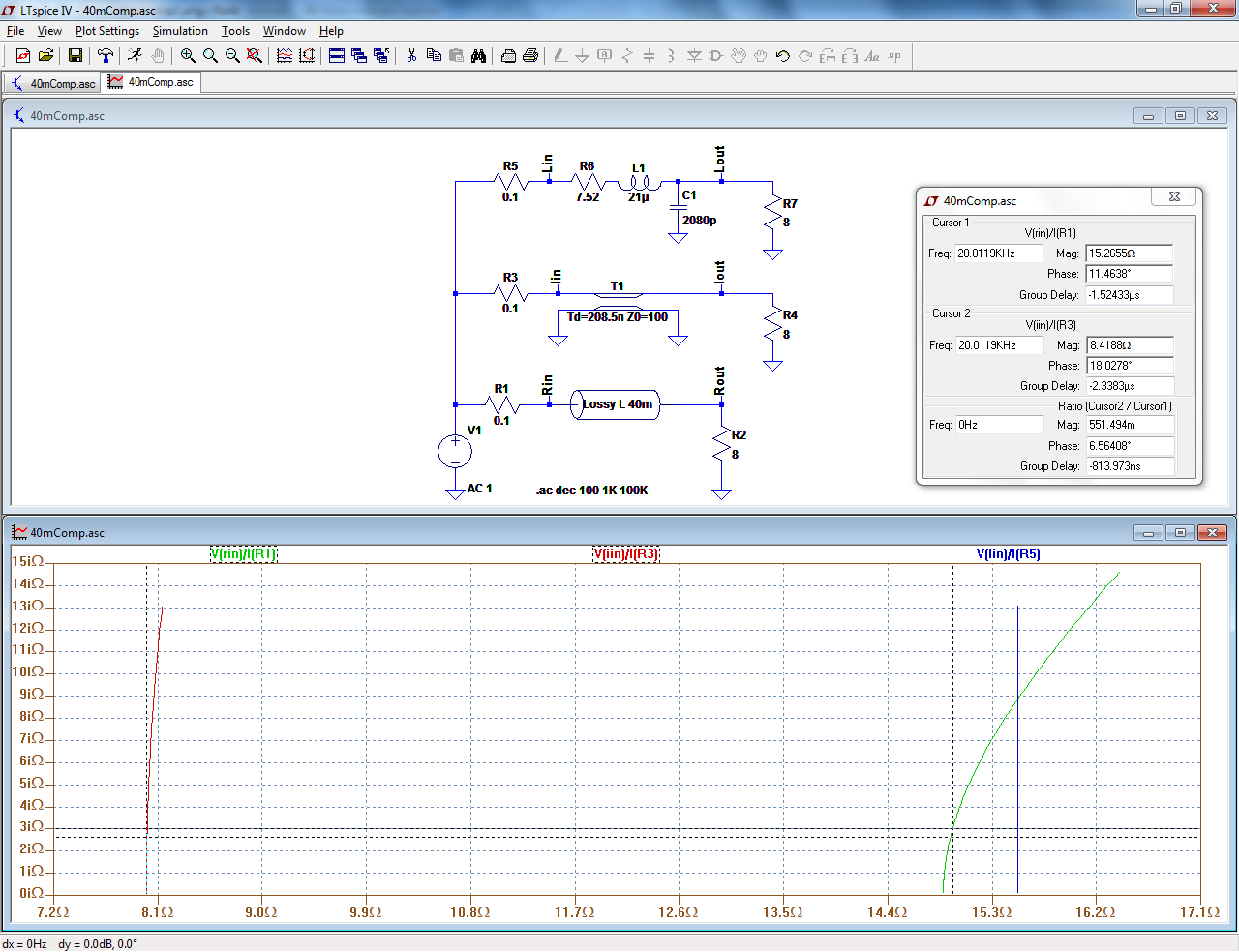

Next are the same parameters viewed with Nyquist. The markers are at 20KHz.

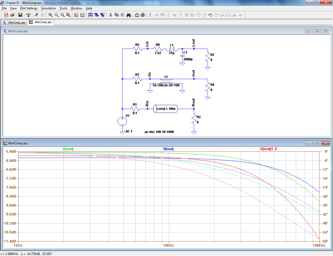

And finally, the frequency response seen by the speaker (the amplitude of the red trace has been scaled to more or less match the other traces)
