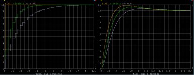

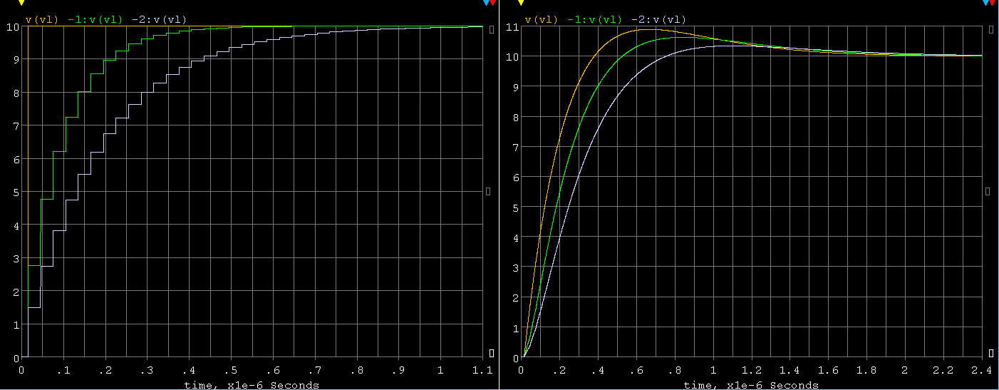

OK so nobody else has pictures, here's one. On the left we have 8 Ohms at the end of 15 nsec of 100, 50, and 8 Ohm lossless ideal transmission line and a perfect amplifier. On the right I added ONLY a very modest Zobel and L that you would find on just about any SS amp (500 nano-H, .1uF, 4.7 Ohms) at the output of a still ideal amp.
So please tell me how these steps are visible using an off the shelf $100 amp?
Also please note time scale. Everything interesting is done in <1usec.
EDIT - JPEG farkled it a little, there are none of the little spaces.

If you wanted to prove that it makes no differences at all, you perfectly reached your goal .OK so nobody else has pictures, here's one. On the left we have 8 Ohms at the end of 15 nsec of 100, 50, and 8 Ohm lossless ideal transmission line and a perfect amplifier. On the right I added ONLY a very modest Zobel and L that you would find on just about any SS amp (500 nano-H, .1uF, 4.7 Ohms) at the output of a still ideal amp.
Please, and again, can-you publish a complete period we can have an idea of the scale. ;-)
After that, i will publish a picture of the same square wave out of a Class D amplifier well known for his sonic qualities ;-)
Oh, too, can-you publish the same test, but measuring the signal with a microphone in front of your tweeter ? If you can see ANY difference, i eat my hat.
