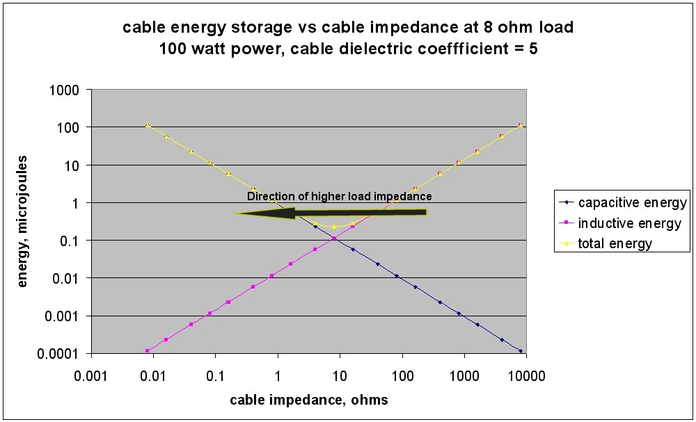

T-line effects do indeed come into play in the audio realm, but in a non-obvious way. Standard smith charts, standing waves and ratio, all completely fall apart at these wavelengths..
Using a bounce model to establish the low pass nature of the t-line/low z load is significant only in establishing the delay the system can cause. This delay is dependent on the line to load ratio. AND, this delay is essentially zero when line equals load.
Way up in frequency, with gain still available, the unloaded (open termination) t line will look like a capacitor. graph attached..
Of note is how the line stores energy as a result of the impedance of the load. For open or high z load, the nature of the line storage is capacitive. For shorted or low load z, the nature of the line storage is inductive.
When the load z equals the line z, the nature of the line is that of pure resistance. And, at that point, the inductive energy stored is exactly equal to the capacitive energy storage.
Cheers, jn
