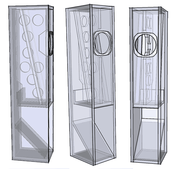

Half-Chili Chang
1st pass of the plans for Half-Chili are done. If anyone would like to be an early builder, email me for the full plans.
Anyone interested in Changs of any flavour should have a look at the visualization... this is the 1st one i've done where i have explicitly added what i would consider the minimum amount of bracing.
dave

Re: Half-Chili Chang
dave
After our experience with Brynn, would you like to suggest a few small braces in the lower void cavity? Sand or shot fill on a cabinet this size would make it very unwieldy
