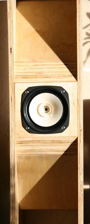

Sunrise over BVR Iris

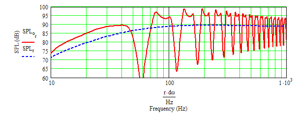

It would be slick if you guys could design and post a subwoofer design taylored for the Olivia and/or other FE127 speakers.
Well, in theory, a single SD12 channel in a ~226" long x ~37.98"^2 CSA 15 Hz TL/channel will acoustically blend with the Olivia's simmed roll-off once its higher harmonics above its 3rd harmonic dip at ~60 Hz are EQ'd down, then just use a XO point where they sum flattest. The pipe loads the driver at a 2:1 compression ratio though, so a little ingenuity is required to cosmetically blend the driver to the end of it.
GM

Re: Sunrise over BVR Iris
I'm ready to button up the Harvey (did some cosmetic polishing today.)
This isn't the Harvey builder's thread but I'm wondering what treatment you are using in the BR portion ( what I call the compression chamber in the Harvey)?
Initial test gave the impression of The Hardy Boys and the Treasure in
the Cave.
I've been fooling around with other projects and fearful of finishing the last side without knowing something about how to do the stuffing. I normally do very little of that. Keeping clear of the BVR vent looks troubling.
Some pics of the inside would help.
