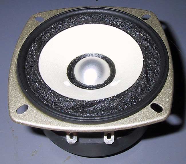

I think i even posted a 1st round thot experiment picture. A 2 L box.
Planned driver is the FF85K (only Fostex that will fit in a small enuff box). It also is the most interesting of the 3" with a Sigma-class surround.
dave

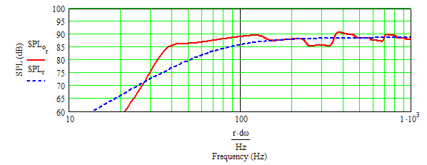

germpod said:For me the zigmahornet shaped enclosure for the fe127 is very exciting. I was going to start experimenting and increase the size of the original zigmahornet to try to get it to work with a friends fe127 drivers but if you have a similar one designed by the pro's then all the better.
Greets!
It really is too tall/skinny for best performance, but if they will be near a back wall, then with a CSA = ~35"^2 and ~1.875" dia. vent (assumes 0.5" thick material) and either some series resistance and/or a high output impedance amp it might perform OK:
GM
