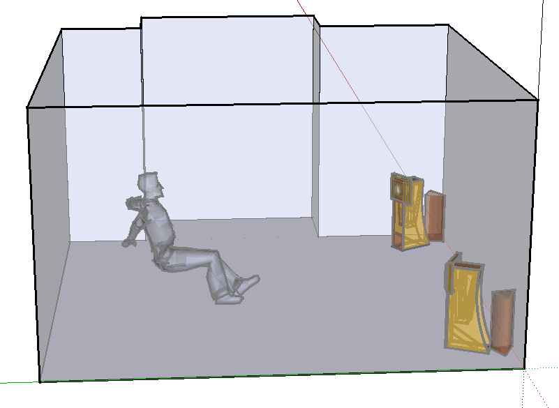

Room sizes
Having looked at the Frugal Horn site, and read this entire thread, it would be great to have some sort of guidance on what size rooms these speakers are appropriate for. Perhaps, what distance apart the speakers should be and listener distance?
I have a room that is 13 x 14, with a 2.5' x 6.5' addition on the 13' side, so half the room is 15.5' long. I have a clean slate, this would be my first foray into the full range speaker world.
Thanks,
-Dwight
Thanks,
-Dwight
This is so room dependent even when they're nominally the same dims that I tend to ignore its size per se.
Speaker spacing OTOH normally forms an equilateral triangle with the listening distance 'sweet spot', with this point being up to 2x the speaker spacing depending on how 'focussed' the speaker's power response is, i.e. large point source 'fullrange' drivers and most FLHs need a longer distance and vice versa for smaller point source drivers and wide dispersion horns or WGs. Obviously, the amount of toe-in affects this.
Anyway, a good listening point in a typical room is typically at some golden or acoustic ratio between the sound (front) and reflection (rear) walls, so figuring everything else from this point is the best way to go IMO. High aspect ratio and/or non simple box shaped rooms have to be dealt with on an individual basis.
Re: Room sizes
Like this? (8" ceilings assumed)
Whatever you do, it should be happy fairly close to the wall.
dave
morgandc said:I have a room that is 13 x 14, with a 2.5' x 6.5' addition on the 13' side, so half the room is 15.5' long.
dave
Too much fun! Slide the additional space section all the way toward the speaker and put a door in the corner. Then yep!

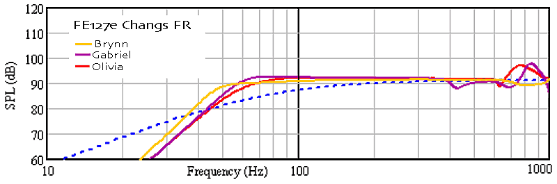

Hard at work today working on catching up with some of the Spawns. Have done the FE127e Changs -- Gabriel, Brynn, & Olivia (FE126e may work with series R -- Scott has those sims in his queue)
1st up here are the 0v9 plans (QC everyone, Scott check to make sure i didn't miss something)

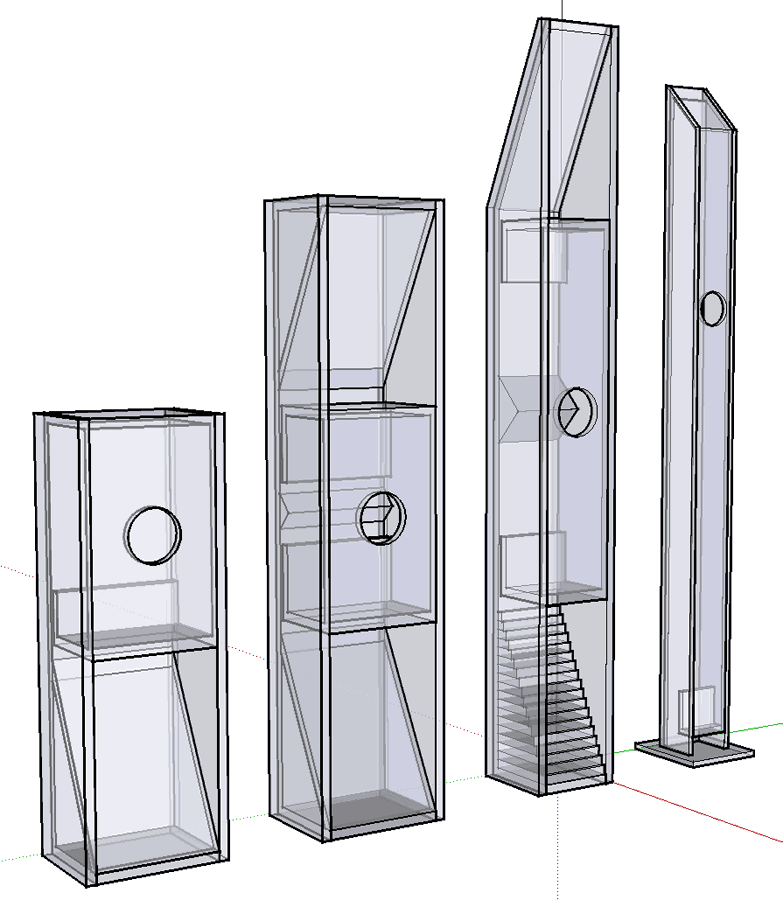

Visualization of the 3 next to the Zigma (Brynn, Gabriel, Oliva, Zigmahornet) -- Olivia turns out to be quite a bit chunkier than Zigma...
