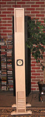

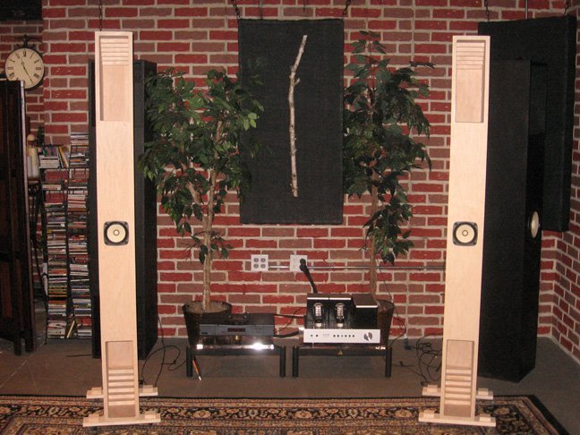

Figures. Actually, I think that's a brilliant idea. Bet the local council, or whatever equivalent would witter about 'health & safety' as a way of wriggling out of it unfortunately.
Up side -those cabinets look like they're coming on very nicely indeed.
Second up-side: Derek, who's black Sachiko's are shown on the Frugal-horn site, has just sent me some images of the 126 cabinet based on this layout / design. Here's one of the shots he sent -you can see his black, full-size cabinets with FE206ES-R's lurking in the background. I think they look sensational. 🙂
You are right Scott, they look great in Black, and I have considered this myself, but I am a little unsure I would be able to pull it off, though it would look cool and hide the odd imperfection in the grain of the wood. I will look into it further, I may be able to hire some spray kit to do the job. Steve.

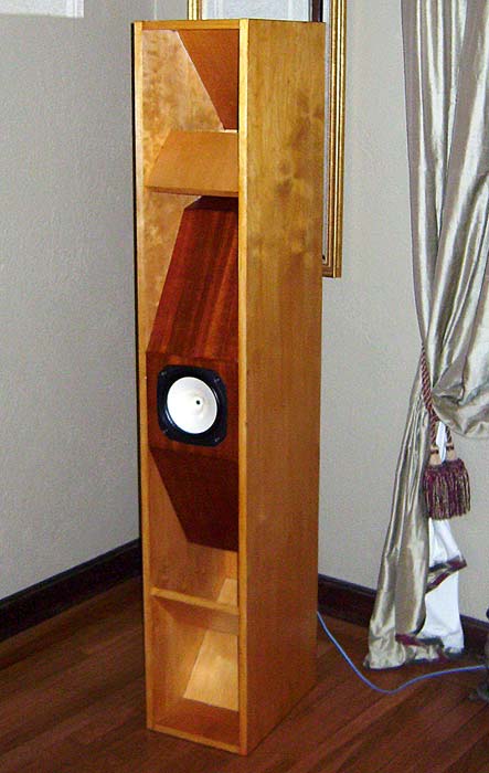

Scottmoose said:Oooh. Nice. Love the contrasting finishes. 🙂
The front is mahogany veneer. The finish is seedlac and wax. I love shellac!

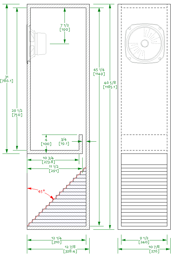

Half Bruce
With a few weeks I will have 2 homeless FE207e drivers.
Now I like Bruce but unfortunately it is not possible to get such a big (tall) enclosure in the living room 🙁
So I was wondering if there is a possibillity to build a half Bruce so with only a big vent on the bottom?
Any use (see attached)?
Alternatively, there's the Replikon: http://www.hornlautsprecher.de/projekt_replikon.htm
I was more hoping of literally a half Bruce: i.e. just take the top mouth of and presto.
I know that it is not that simple but that is what I was thinking of.
I could use the replikon design but I would like it more if it is a "Spawn of" design.
If I can find time, I'll design a one-off. Time is something I don't have much of at present, but I'll do my best. It'd have to be a clean-sheet box as none of the existing cabinets can be halved.

Scottmoose said:If I can find time, I'll design a one-off. Time is something I don't have much of at present, but I'll do my best. It'd have to be a clean-sheet box as none of the existing cabinets can be halved.
I appreciate that you are willing to put some time in it.
Like I mentioned already I am not in a hurry as the drivers will come in a few weeks.
So far thanks alot in advance!
