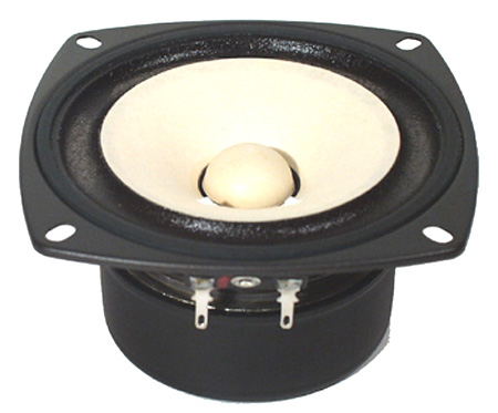

which for FE107E?
I have pair of Fostex FE107E sitting around in the garage, I have finished the Chang using Pioneer B20 drivers but sound is not quite stellar.
I like to build another using Fostex.
Fostex 4” SHIELDED FULL RANGE
ES banana pulp cone
8 ohm impedance
90dB sensitivity
Frequency response
to 22kHz
Flange 107mm
Cut-out 92mm
Depth 54.7mm
Znom 8 ohm
Re 7.6 ohm
Le@1kHz - mH
fs 80 Hz
Qms 2.56
Qes 0.45
Qts 0.38
Mms 2.6 g
Cms 0.0017 mm/N
Sd 0.005 cm2
BL 4.7 N/A
Vas 5.95 ltrs
Xmax 0.35 mm peak
VC Ø 20 mm
Sensitivity
1W / 1m 90 dB
Nom. Power 15 W
Shall I try Harvey or Mikasa? would appreciate any suggestions.

The sound won't be stellar -you're using Pioneer B20s. A fine driver for the money, and I gather very pleasent to listen to for extended periods. But in detail, extension (especially upper), transparency, transient response etc it's not in the same league as a Fostex 8in or similar.
The 127? I'd use Harvey.

That tweeter looks like a good match for the B20 to me. You've got a driver rather than a cabinet issue at present as the box has little effect on the midrange / HF.
Ah, the 107 (sorry -misread). To be honest they're all too big for it in practical terms. If you must, then it should go into Harvey, but you'll need to go very easy with the volume knob.
Scottmoose said:
That tweeter looks like a good match for the B20 to me. You've got a driver rather than a cabinet issue at present.
thanks, I must admit bass seems fine, seems to be the driver...
Harvey will have to wait a while, in part out of frustration with B20 at the moment.
gychang
Think positive mate -the tweeter will improve things markedly according to the guys with experience (Jeff, Dave, Nelson etc), and I gather that solo, they're quite a nice, mellow listen, if lacking detail by Fostex standards. Plus, they have a reputation for being bomb-proof, so you could throw a party. Or two. 😀
Worst comes to the worst, remember that box will take the 206/7 (it was designed for them -the B20 just happens to fit) so at some point in the future when funds permit, you could upgrade to one of the Fostex units, which will sort out that midrange & treble issue at a stroke. 🙂
