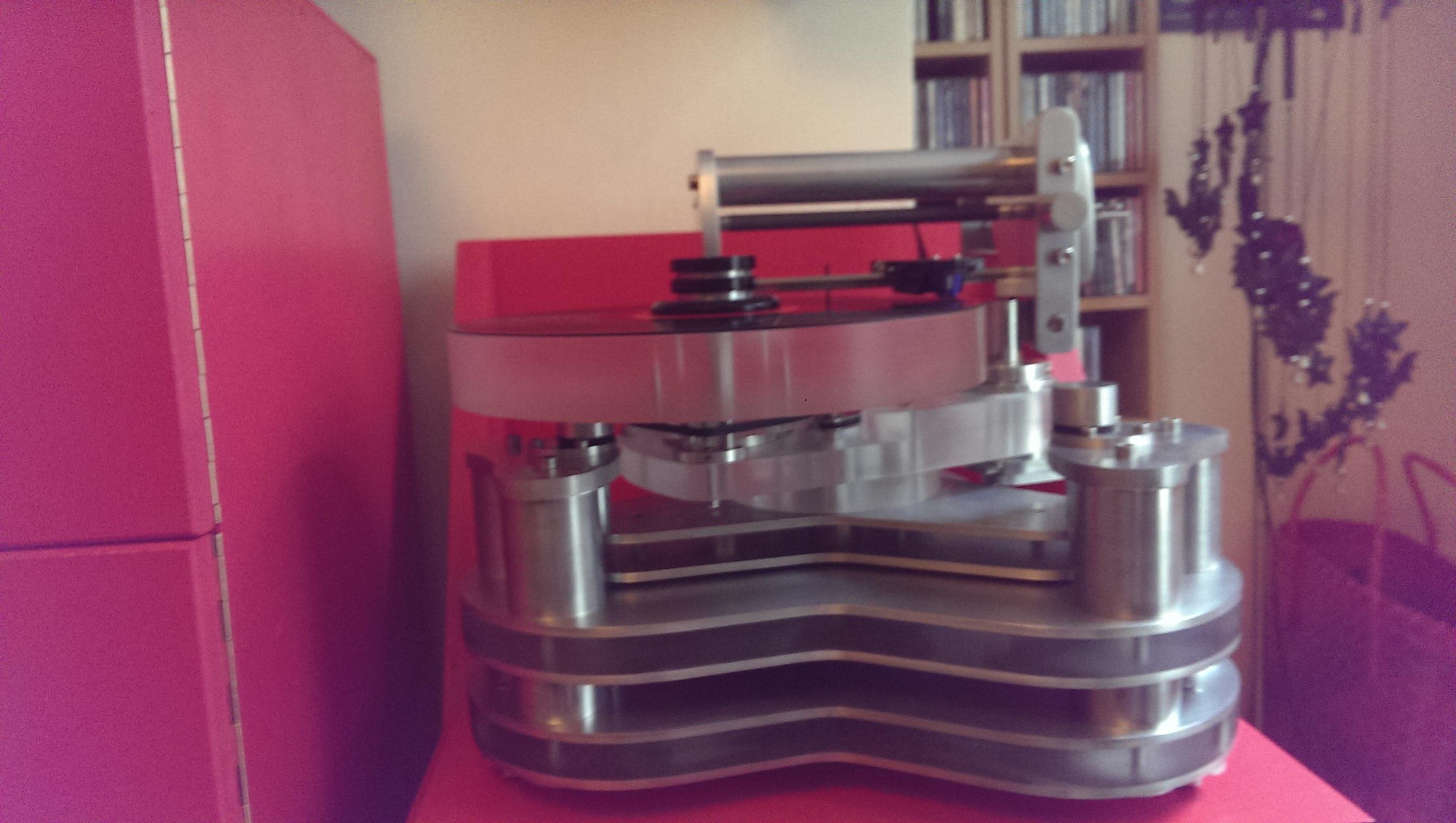

One of the reasons that this thread is so interesting to me is that I have been doing a lot of work investigating bearing friction in an attempt to improve my passive linear tracking arm. To this end I have built a test rig to accurately measure the static friction of various bearings. Static friction is more important than dynamic friction as it is higher than dynamic and the arm is constantly stop starting due to record eccentricity.
My arm is different to the souther as it uses two bearings running between two rods but the effects of bearing friction will be the same.
I have two sets of high quality bearings and have to date only fully tested one set, full ceramic zirconium oxide, as the others are fitted to my arm and I still want to listen to music, though a quick test indicated they are similar in performance. The test rig has the bearings spaced the same as my arm with the side force applied where the stylus would be to give a real world image of what's going on.
I took literally hundreds of separate readings with different carriage masses. I plotted the distribution of side force required to move the carriage for each carriage mass (30, 40, 50 and 60 grams). As my computer had gone down I had to do this old school with a pencil and paper. I had expected/hoped to see a nice Gaussian (bell curve) distribution spread over a narrow range. What I actually found was quite surprising. The distribution showed two overlapping bell curves, each with a nice Gaussian distribution, of similar magnitude and much more spread out than expected. By dividing the measured lateral force, in grams, by the carriage mass the coefficient of friction of the bearing system can be determined. The coefficients of friction calculated for each peak and the overall average were consistent between the four different carriage masses tested. The overall average coefficient of friction was 0.01. The lower mode/peek was 0.008 and the higher at 0.011. The highest level of the coefficient of friction measured was 0.015.
The bearings used in the souther are not fully ceramic and probably have a coefficient of friction even higher than those I measured. I do not know the exact mass of the souther carriage. If I assume that it is 40g including cartridge then a 0.011 c.o.f. ,the higher mode, would result in a lateral force of 0.44g. Using a cartridge of 9um/mN compliance with a 5mm long cantilever would result in a lateral tracking error of 0.45°. Still better than a pivoted arm but not perfect. The maximum lateral tracking error would be higher still.
With extra testing I determined that the peeks in the distribution curve were connected to the rotational angle of the bearing. If the bearings were positioned with a single ball at the bottom this resulted in the higher mode and if positioned with two balls at the bottom in the lower mode. As the carriage moves across the record the lateral force varies up and down by a small amount in absolute terms but a large amount in relative terms, about 40%.
The bearings used for this arm are designed for high speed applications where only their dynamic friction is of concern and small variations within a single revolution do not matter. Our application is the opposite of this, very low speed.
We have mentioned the importance of having a very accurate smooth surface of the rails. The same is also true for the outside of the bearings. Unfortunately for the intended use of these bearings only the dimensional accuracy of the outside is important and not the surface finish. Polishing the outside of the bearings can help to reduce friction and lower noise. This is definitely worth doing but extreme care must be taken to avoid contamination of the bearing with polishing compound.
My experiments are on going with the aim of producing lower friction, better sounding bearings. Currently I have just made some pin bearings, similar to those used in watches and clocks and designed for low speed. So far this is looking very promising. The distribution for these bearings show a normal Gaussian distribution, with no double peeks, a narrower distribution and most importantly less than half the friction. I am midway through building a new rail to test these bearings on my arm so I do not know how they effect sound quality as yet. On the hardness of materials used. I initially used aluminium for the wheels, to keep mass down, and got a coefficient of friction of 0.005. Pretty good. I then tried 316 stainless steel and the coefficient of friction dropped to 0.0039, over 20% improvement. Hardness really is important. I would love to try tungsten carbide rails at some point to see if any further improvements can be made. Also, currently the cups of my pin bearings are just stainless steel. If the new bearing design shows an improvement in sound quality over the ball bearings then I will replace the cups with sapphire vee jewels, much harder than steel and should lower friction even further. As the vee jewels are expensive l want to be sure that they work before splashing out on them. Pin bearings should also have several advantages other than lower more consistent friction. With ball race bearings only the balls at the bottom are under load, the rest are loose and free to move about. This is a possible source of chatter. Although any chatter would be at a very low level, and not directly heard, it could still smear microdynamics. With pin bearings there are no unloaded components so the possibility of chatter is greatly reduced. Also the carriage is supported on what are essentially spikes. This should give very effective mechanical grounding, the same principle as spiked equipment supports or speaker stands. Finally, compared to ball races the pin bearings are much quieter. Rolling my test carriage backwards and forwards on my test rigs rail with ball races fitted results in a clearly audible noise, with the pin bearings it is almost silent.
The last section is probably a bit off topic as it is probably very difficult to upgrade a souther to use this type of bearing but might be worth trying.

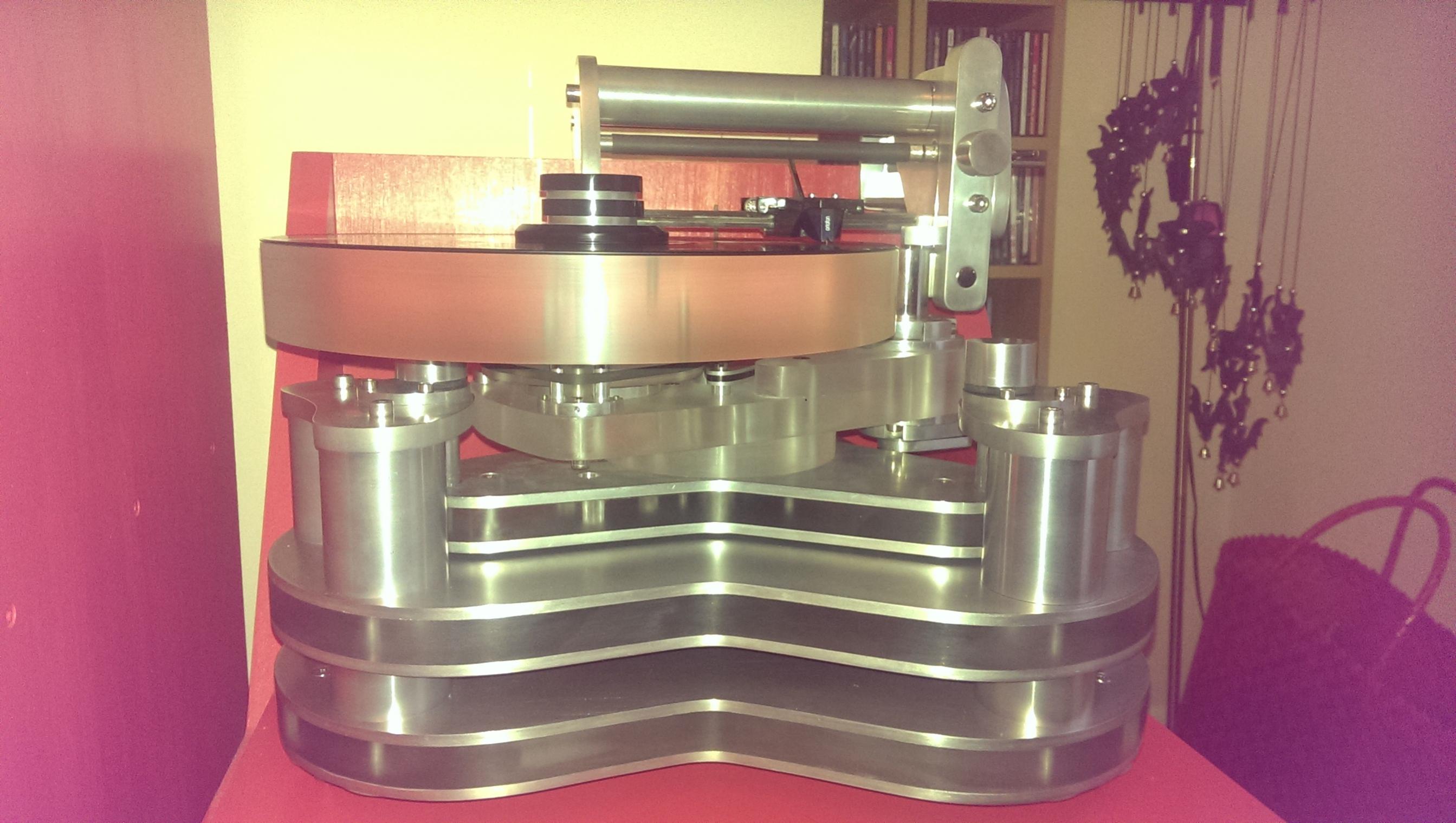

WOW, I am officially impressed in your efforts to make the best mechanical linear tonearm possible !!! What diameter rods do you use for the rails ? What length rod ? My reason for asking is if you are flexible about your rod dimensions I might be able to get you some tungsten carbide rods but they may be in inch dimension rather then mm. I will send them to you for free as my contribution to the cause. Also, small diameter carbide pins would be no problem. I think full ceramic bearings would be good enough but sapphire may be better--but very brittle. Send me an email at joesnipe767@yahoo.com if I can help. This is how you move the performance envelop of this type of arm forward.
Hi Kevinkr
The mass of the carriage I am working from is the entire piece that moves horizontally including bearings. Even with a 5g cartridge I would be surprised if the total mass was as low as 15g but then Lou was aiming at minimum mass and low energy storage so maybe.
WOW hottattoo
That is an amazing offer, thank you very much. The rods I am using are 4mm diameter and 170mm long. I can be flexible with anything in this ballpark.Please please let me know if you can source tungsten carbide rods close to these dimensions, I would be extremely grateful.
In an earlier post you mentioned the difficulty in obtaining quality glass rods, I cannot remember who I got mine from, I did import them from the States and had to buy a batch of thirty at 30cm but at least that gave me lots to experiment with. The two I've just glued into my new rail were thoroughly checked. I measured them with a micrometer in dozens of places each. The measured diameter was to within 5um on all measurements. Also rolling them against each other on a mirror showed no deviation from absolutely straight. Looks like I got Lucky. I've attached a couple of pictures of my turntable/arm combo as it is at the moment. All hand built by myself with no fancy tools. (Having a bit of an issue uploading photos)
Niffy
Hi niffy,
I figured this would happen. I can get 2 12" long carbide rods in either .1463" or .1875" diameter . I am waiting to hear from one person about 4mm carbide rod--should know in a day or two. Is that any help to you ? That is a beautiful turntable !!!

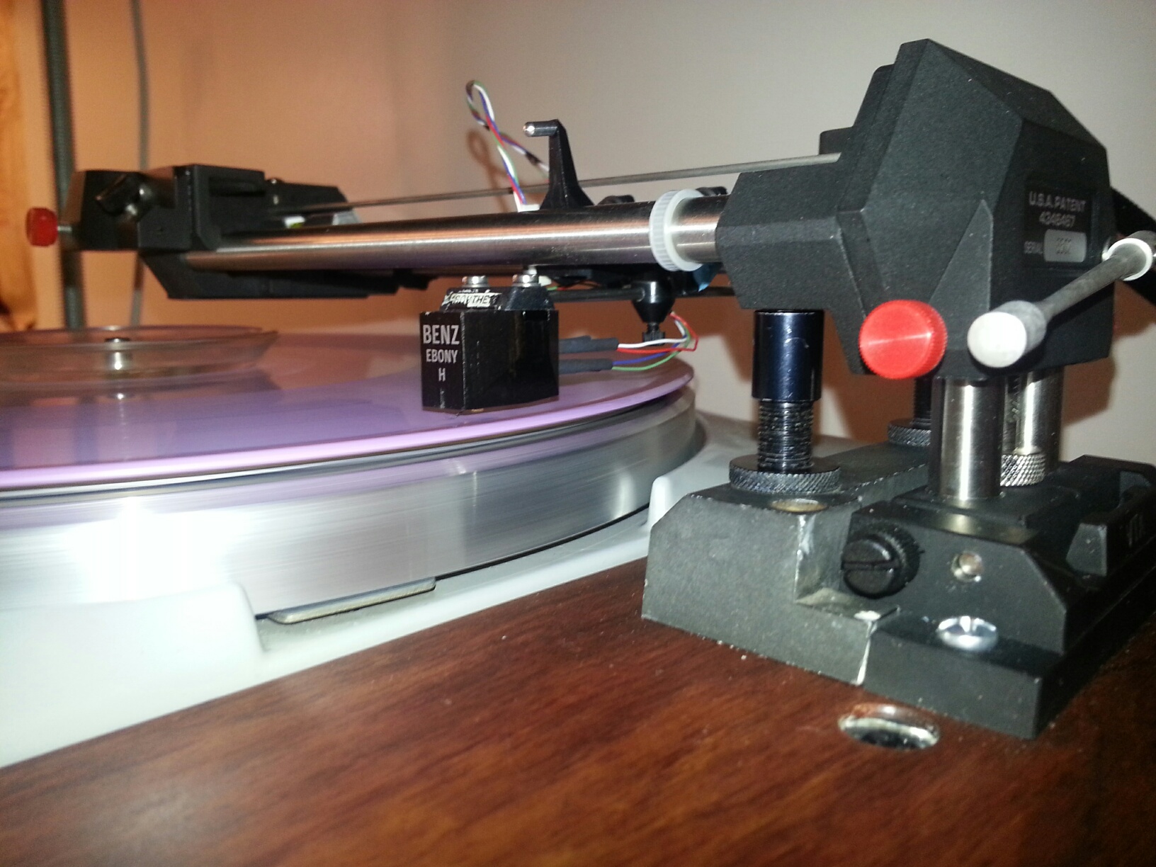

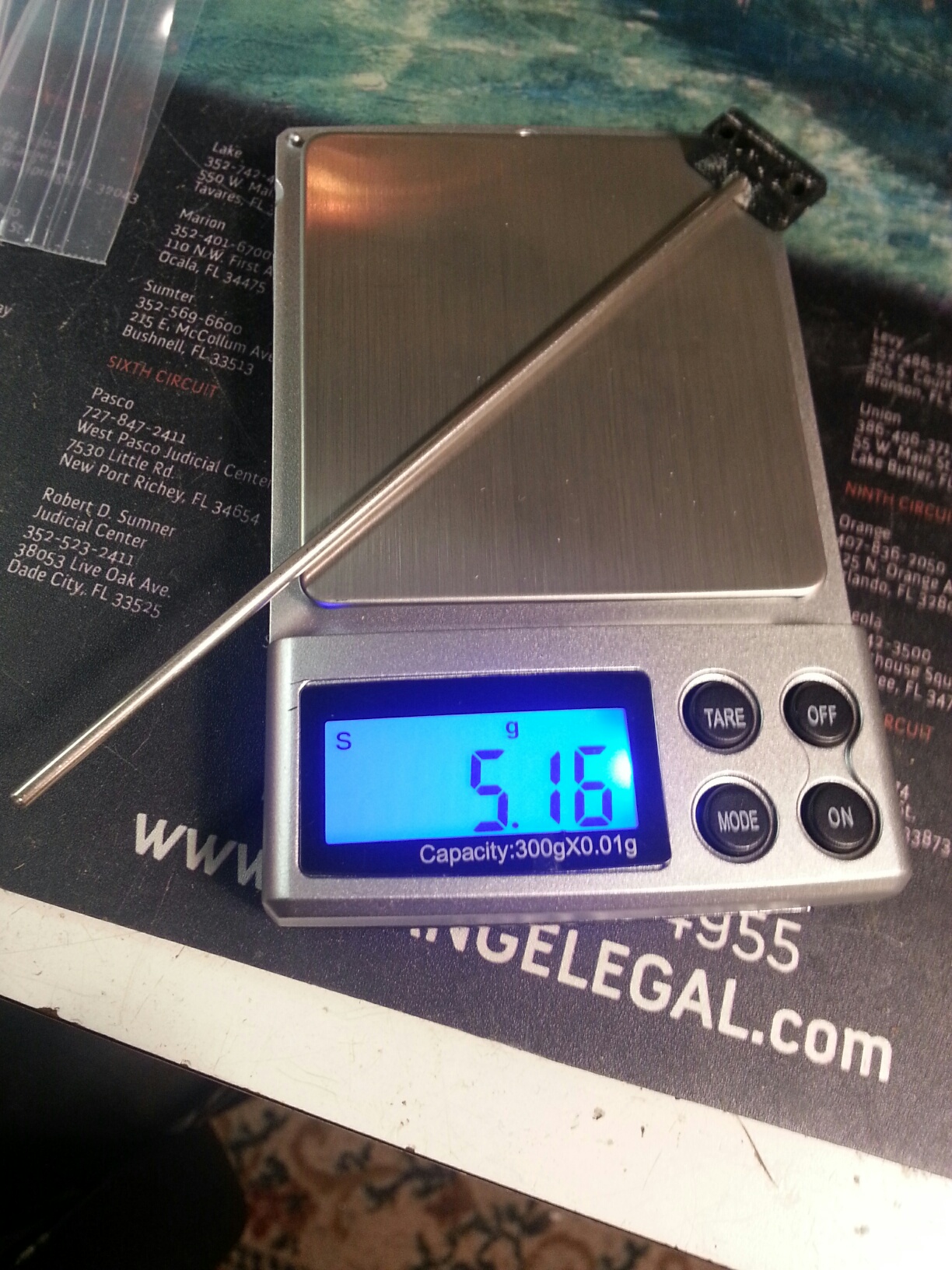

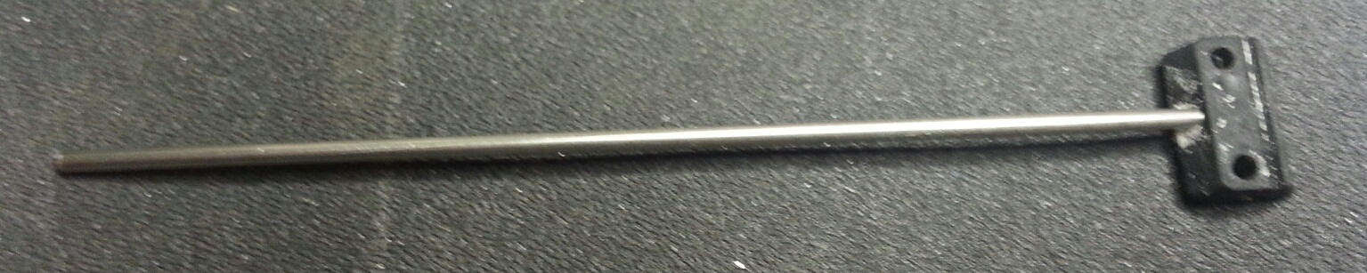

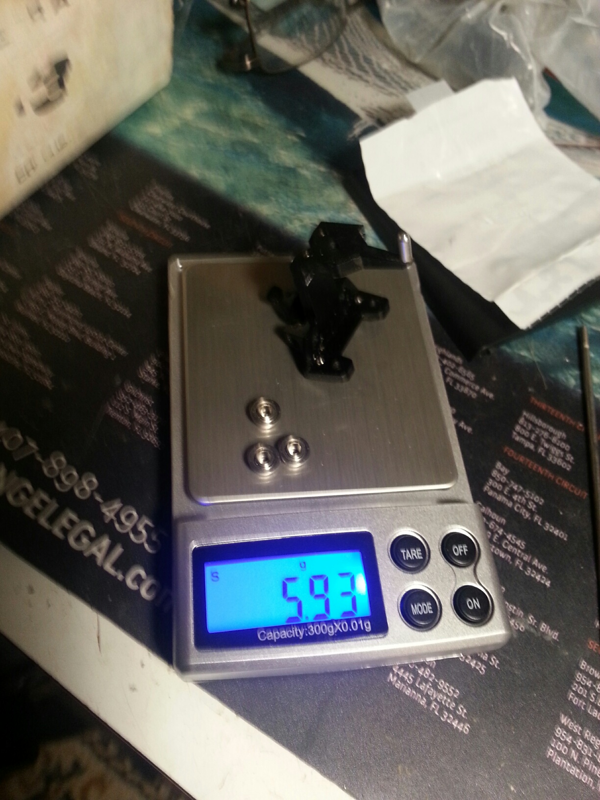

Arm wands
Tonight I pulled the hollow arm tube out of one of my two light weight arm wands and cut a replacement arm wand from some stainless steel stock that came this week-end, I made it about 3/8" inches longer than the arm tube it replaced. It press fit quite nicely onto the old Souther head shell. I've installed the Benz on the SLA-3 and reinstalled it on the MKII. So far it seems to be working pretty well.
The cartridge weighs in at 10.7gms, the sole counterweight is 6gms, the arm wand is 5.2gms, and carriage is about 6gms for a total mass in the horizontal plane of 27.9gms.

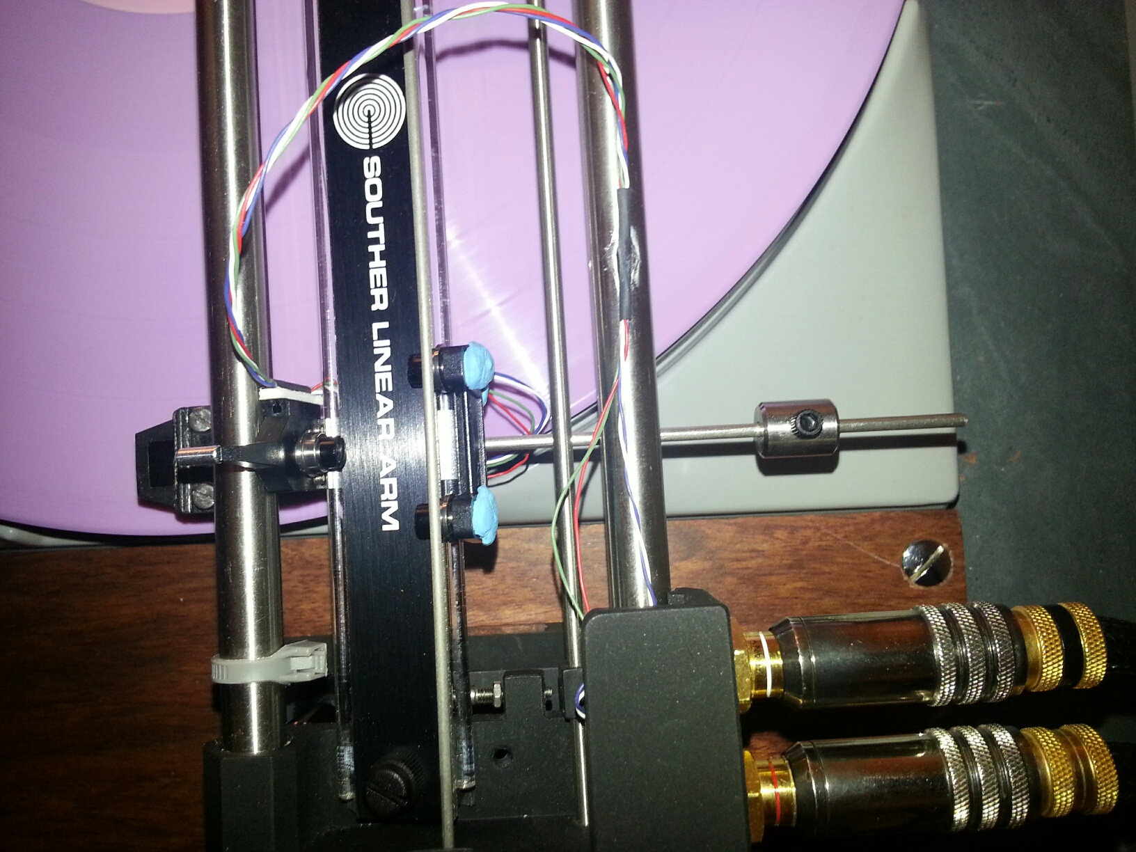

Niffy, the carriage weighs in at 5.93gms.. The only thing missing are the fasteners which are currently on the arms. As mentioned the current set up on the SLA-3 has a total mass in the horizontal plane of around 28gms.
Completely OEM with a 5gm cartridge it might be possible to get the total mass down close to 15 - 16gms, but I will continue to use MC cartridges in the 8 - 11gm range..

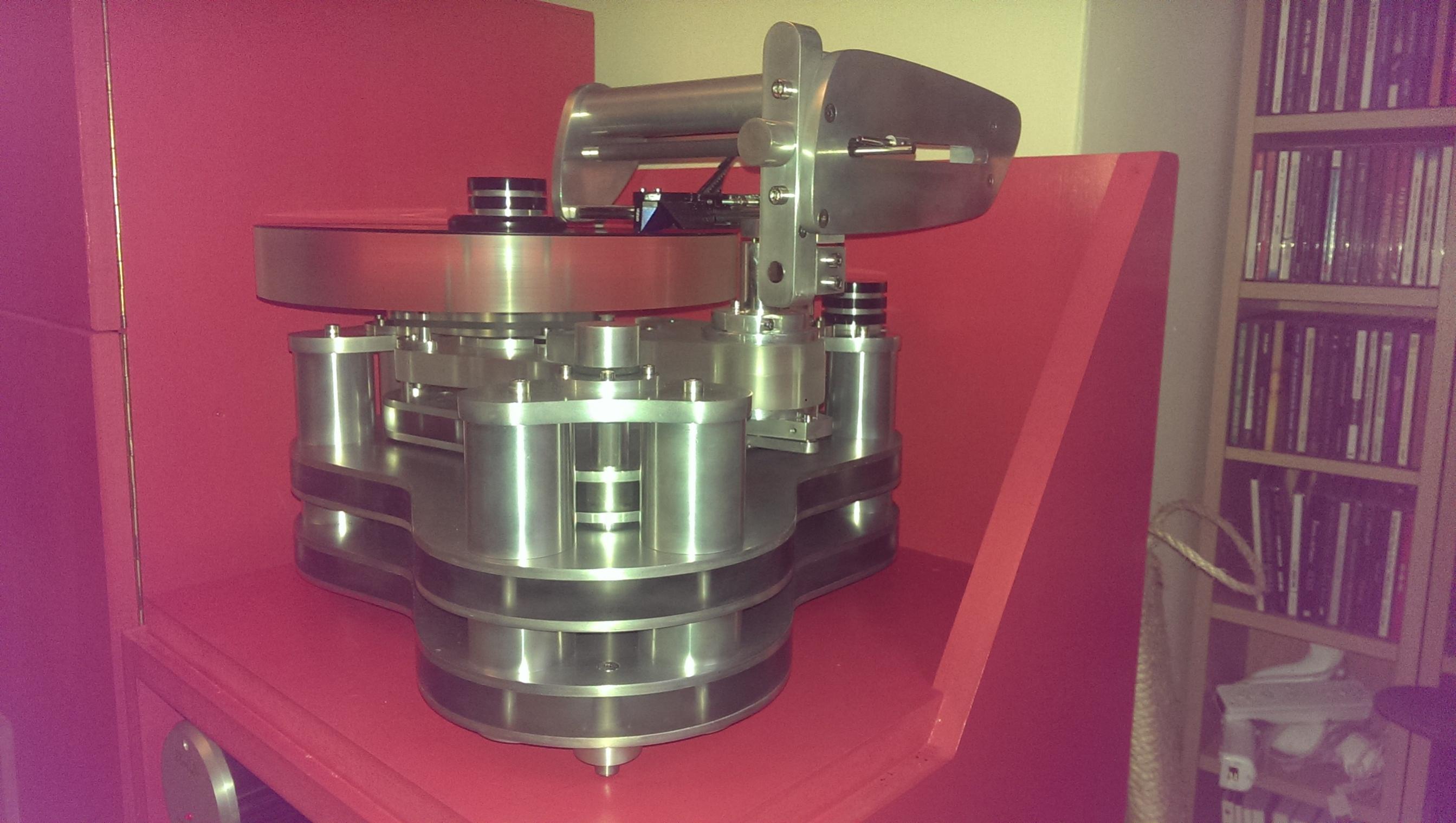

Hi all and thank you for your kind words.
I am planning on starting a new thread to describe my deck once it's completely finished. I'll probably focus more on the design and my philosophy behind it rather than the actual building, more the why than how.
Bill.

That really is a low mass arm. At 28g the lateral tracking error, based on my previous example, would drop to only 0.31°. That's pretty close to completely inaudible. The lateral tracking error due to record eccentricity on the inner groove of an average record is higher than this. Nice.
