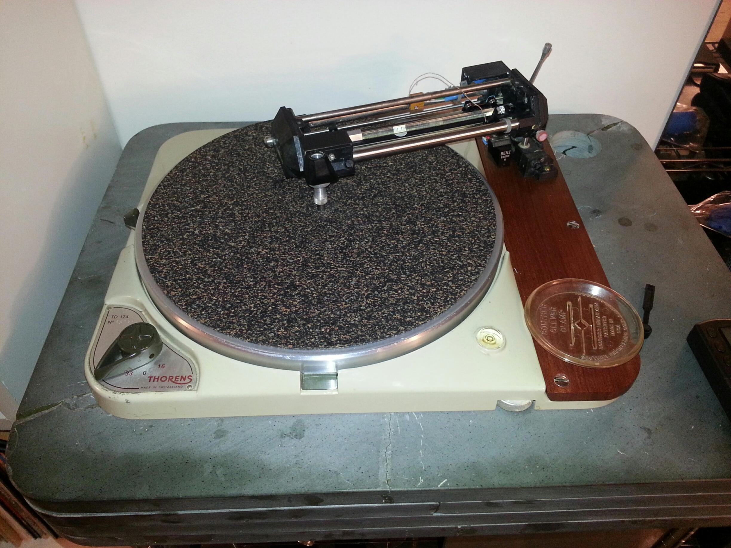

The level of performance these arms achieve came as quite a surprise to me too. I was not expecting this particularly from the Tri-Quartz which was in very rough shape when I got it. I've done lots of work to clean it up and it does seem to be working rather well now.
I am not sure my SLA-3 was deliberately designed to lock the arm, it might be more of a fortuitous accident, best I can determine the flimsy plastic cover is the key, when in the fully up position the cuing lever on the carriage binds lightly against the cover, this may or may not be a deliberate design choice but I have no way to know. Since I have only a sample of one it could be simply that the slot routed in the cover for the cuing lever happens to be in the right place for this to happen. It's very handy whatever the cause, I suspect a stiffening bar placed in the right spot could accomplish the same thing. I haven't yet noted any significant difference with the cover on or off on the SLA-3 in terms of sound and because of the dust concern for now mostly leave it in place.
I'm still working on getting the SLA-3/Windfeld combo sorted out to my satisfaction, and will profess to having a slight preference for the Tri-Quart/Benz combo at the moment. It took me more than a few weeks of tinkering to get the original set up to work as well as it now does.

I was wrong on a couple of counts. Tonight I removed the flimsy cover and I think it actually is a little better without it. I was pretty convinced it wasn't and couldn't be that audible, but it appears the street wisdom on this might be correct.
I also took a really close look at the carriage locking behavior, it's apparently not accidental and has nothing to do with the cover as I surmised; with it removed it locks just as nicely as before. This it does by forcing the carriage bottom to into contact with the bottom of the rods. I suspect it nothing more than a minor adjustment to the cuing lever travel limit screw. The SLA-3 had not been touched by anyone since it left the factory which I know is not the case with my Tri-Quartz which incorporates just about every modification known to man. It has a locking position that the later arm either never had or was defeated during modification.
Edit: I found a difference, the SLA-3 uses short screw as a travel stop for the cuing, and allows about another 20 degrees of travel as compared to the Tri-Quartz. The TQ has a threaded rod which sticks out much further and limits the travel at the top of the cuing lever rotation. I think that's it basically, the shorter screw allows the cuing to bung the carriage into the bottom of the rods, which IMHO is a good idea. There must have been a concern as the SN 35xx SLA-3 has it and the SN 45xx Tri-Quartz doesn't, looks like a running change to me.

For whatever reason Lou Souther was adamantly opposed to the fulcrum end support that Clear Audio came up with - he maintained that it needed to be supported at both ends of the arm. (This according to the former owner of my Tri-Quartz who actually knew Lou Souther)
For the moment I don't have a viable way to do a direct comparison, the SLA-3 spindle bushing profile is not correct for the spindle on the 124 which is normally a none issue except if I want to do this very experiment. All I can say is the the Tri-Quartz without the support still manages to sound marginally better most of the time than the SLA-3 with it. We're not talking a huge difference here.
The SLA-3 came with an optional brass arm wand which I have just installed in place of the hollow titanium arm wand (with the filler rod) and it is definitely preferable, some sibilance I heard on some female vocal passages is much reduced. (The TQ/Benz exhibits virtually no sibilance at all on that particular passage.)
I would say the hollow arm tubes should be avoided.
The set up guidelines for arm height should probably be ignored, modern cartridges seem to be substantially taller than the cartridges Souther was thinking of when those instructions were written.
A few further cartridge thoughts. I'd say anything much over 11gms is really too heavy, although cartridges up to 13gms can be made to work satisfactorily.
The Windfeld VTA adjustment is extremely critical, more so than the other replicant/line contact stylus equipped cartridges I own. The result of getting this wrong is sibilants on some vocals which becomes very pronounced on the inner grooves but is audible everywhere on the disk. Get this set correctly and it disappears, but the window of adjustment is small enough it can be missed. VTA adjustment is pretty easy on the Souther as long as you are not using the CA support at the fulcrum.
I would say cartridge weights of 5 - 11 gms and tracking forces of 2gms or greater work well. No tracking issues with compliances of 12 - 16 cu so far.
The Benz Ebony series is just about ideal.
A couple of dozen records played over the past 6 days with both arms, no skipping on either.

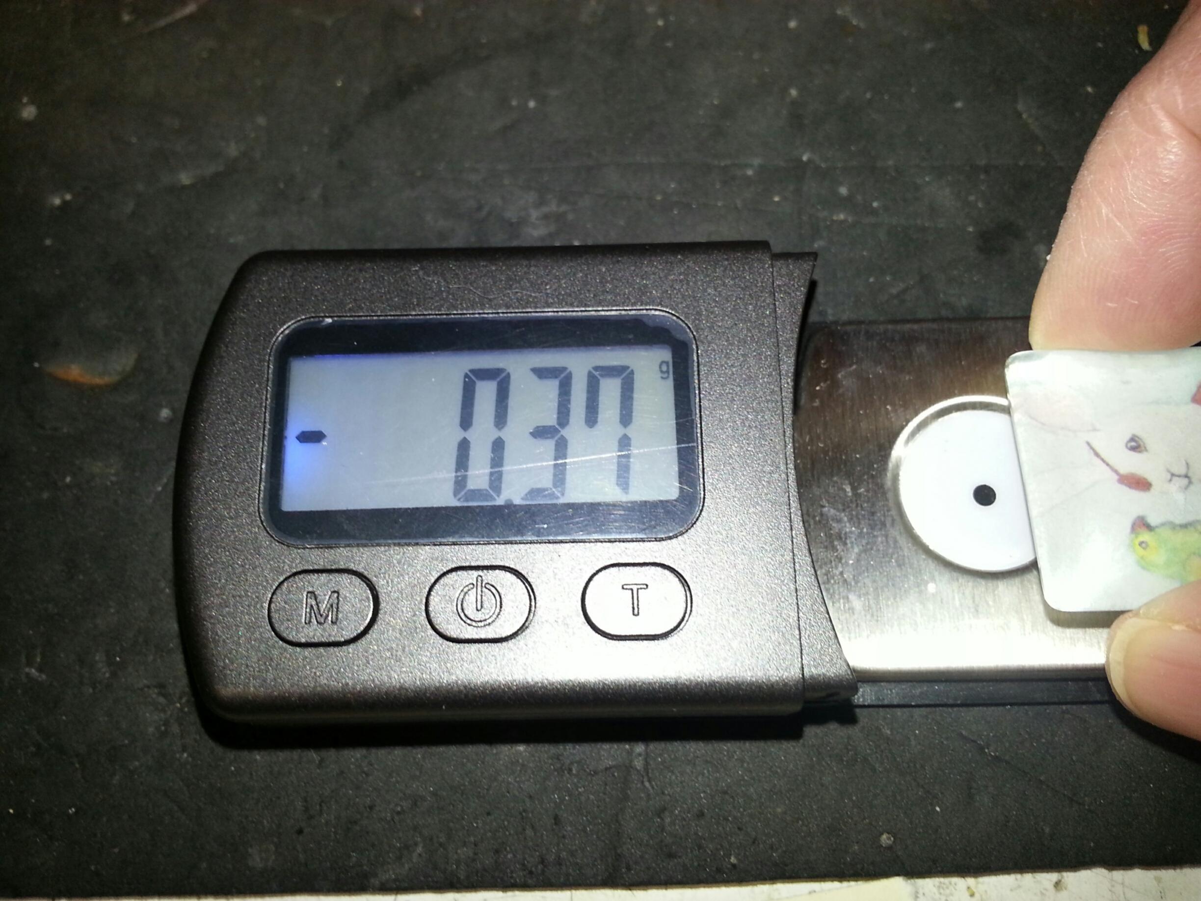

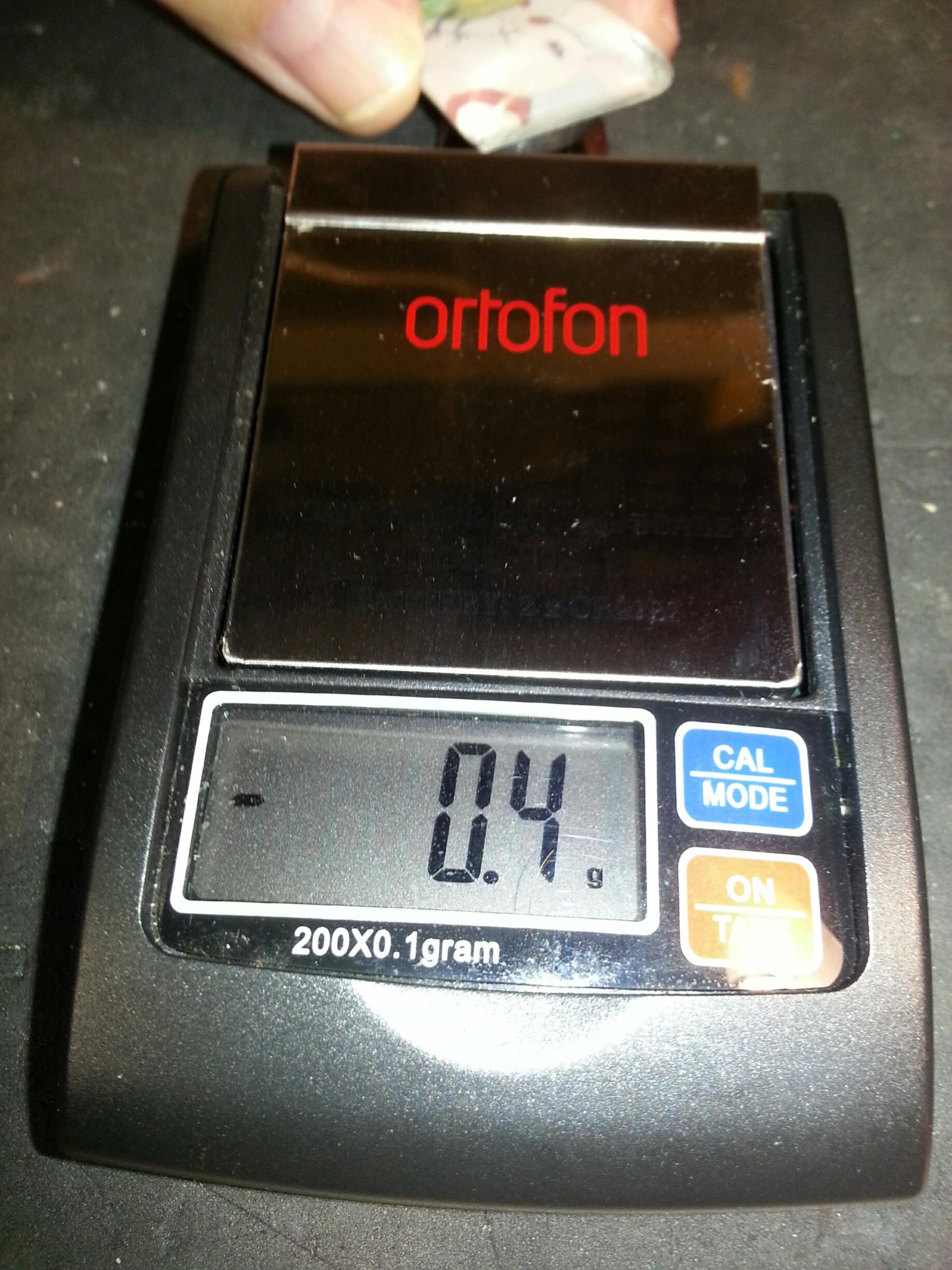

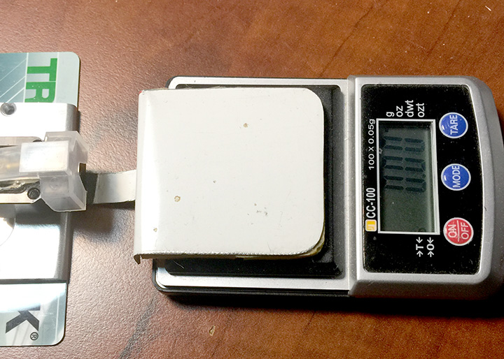

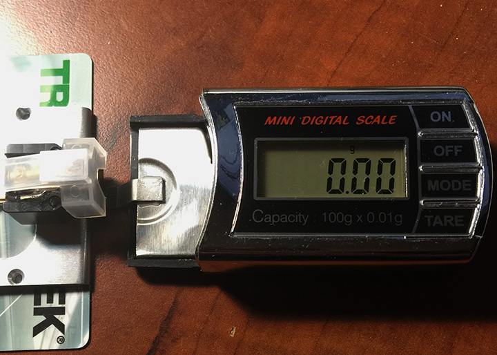

I've really been struggling with the Windfeld in the SLA-3, this cartridge is extremely sensitive to both SRA and azimuth, very small changes in either generally result in profound changes in performance - usually in the wrong direction.
Add to this the discovery that my stylus force gauge, an inexpensive Asian made thing that looks like some much more expensive devices is a lying piece of <expletive deleted>. The measurement platform is made of a magnetic form of stainless steel, with MC cartridges with powerful magnets this results in tracking force settings that are far less than what the gauge reports - errors of a gram or more are possible, and the Windfeld has extremely power magnets, as it approaches within 6mm or so of the gauge you can see the reading move off of zero and into the negative force range. (0.2gms or more) I am sure as the cartridge rests on the actual platform the attraction is much, much greater. This gauge is therefore useless as a means for setting the tracking force. Some of my problems with the Windfeld undoubtedly stem from this issue.
I took the plastic cover off of the SLA-3 a few days ago... I have done quite a lot of tweaking and it appears that the Windfeld can work well on this arm - not a given however as it is heavier than the optimum, and incredibly sensitive to SRA (VTA), it's been a rough go complicated by the fact that the stylus pressure gauge interacts with the magnetic field and sometimes gives erratic tracking force readings, unfortunately the just acquired Ortofon DS-1 has the same flaw as the stainless steel used is quite magnetic. It is otherwise much easier to use with the Souther Arms.
I've attached photographs of the said gauges with an external magnet in proximity to the measurement surface. I observe the same effects with the cartridge bodies in close proximity to the pans. In theory this actually should not cause an error in readings of externally applied tracking force, but it creates some uncertainty as you try to measure the tracking force. (Need to allow time for everything to settle)
I don't know why you have trouble with your scales. That Ortofon scale costs over $100. I will never buy that while I know it only worth less $15.00. I have two scales. Both cost less than $15.00. One has accuracy of .01 g and another has .05 g. After I read your post, I tried to make sure mine working properly. I also used a very strong magnet to do experiments. Both scales worked fine if I put the magnet on the lip. But if I put the magnet on direct top of the scales, I got .4 readings.
