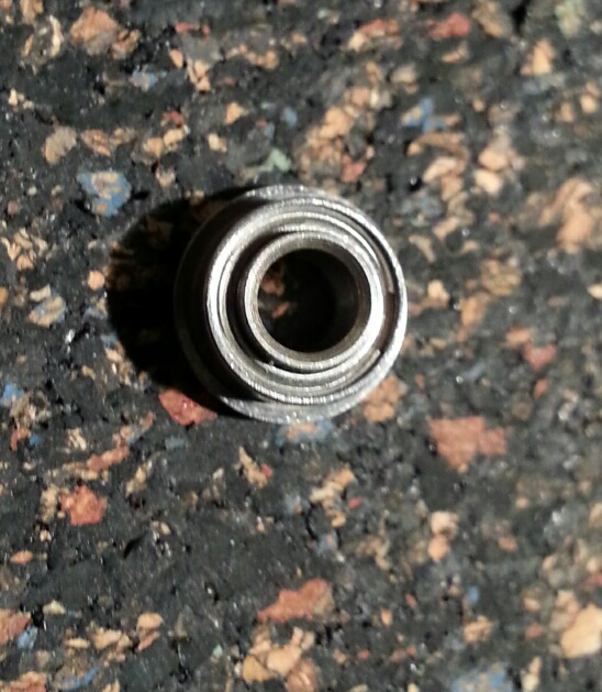

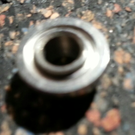

Snapped a few pictures of the bearings used which I will share here..
The dimensions I measured are as follows, and I was careful, but as always I might be off a few mils.
The race excluding flange has an O.D. of 0.250"
With Flange 0.296"
The race outer race is 0.110"wide
The inner race is 0.140" wide
The I.D. of the inner race is 0.1245"
These are flanged bearings obviously.
There is a significant difference between the performance of these bearings and the ones on the unused SLA-3. The Quartz rods are scrupulously clean now and get a regular wipe down with distilled water on a swab. The bearings have received the same treatment on a regular basis as well and while it has helped I still believe that new bearings would be a worthwhile investment.

Bearings
Hi Kevin,
Attached, please find drawings and specifications for the above bearing.
They are available from McMaster-Carr for around $ 7 to 8.

The bearings you ordered from McMaster-Carr are oil filled which are not desirable. You should clean them once you got. The bearings should be dry bearings. You may also try to use professional double side tape from Home Depot to warp around both ends of the glass rods to reduce noise. I would suggest to cover the glass rod as much as you can. If I were you, I would change the wand from metal one to carbon fiber one to reduce the noise. However, if you reach that point, you are almost going to completely change the tonearm. Personally, I don't like the construction to begin with.
I plan to experiment with the bearings so doing as you suggest is viable. I can always put the old ones back in, they are satisfactory after obsessive cleaning.

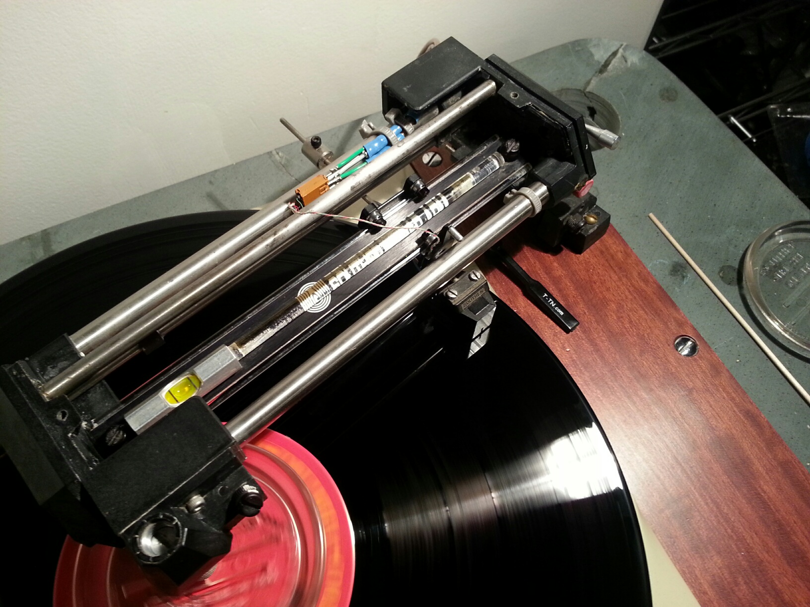

I've attached a snap shot of the arm as currently configured, you can see the cartridge position relative to older shots, I've set it back at least a quarter of an inch, and according to the tool it is properly lined up.
I could blab on about what improvements or deficits I perceive now which would be entirely subject to my bias.
