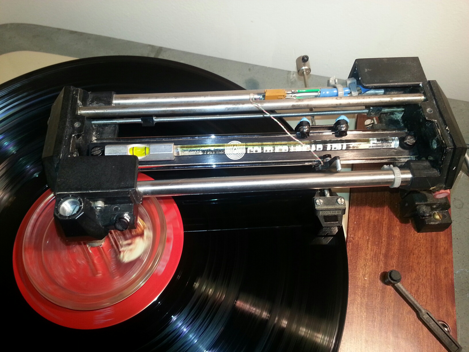

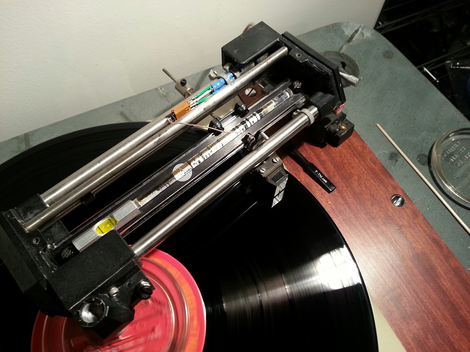

Funny that you ask, some people apparently do install the arm so that it is at a slight incline, this has not proven necessary at all in my case. I suspect clean rods and bearings are what are needed.
I can't imagine adding weights or pulleys to this thing. Getting it to work correctly takes some patience but once understood just keeping it really clean is most of the battle.

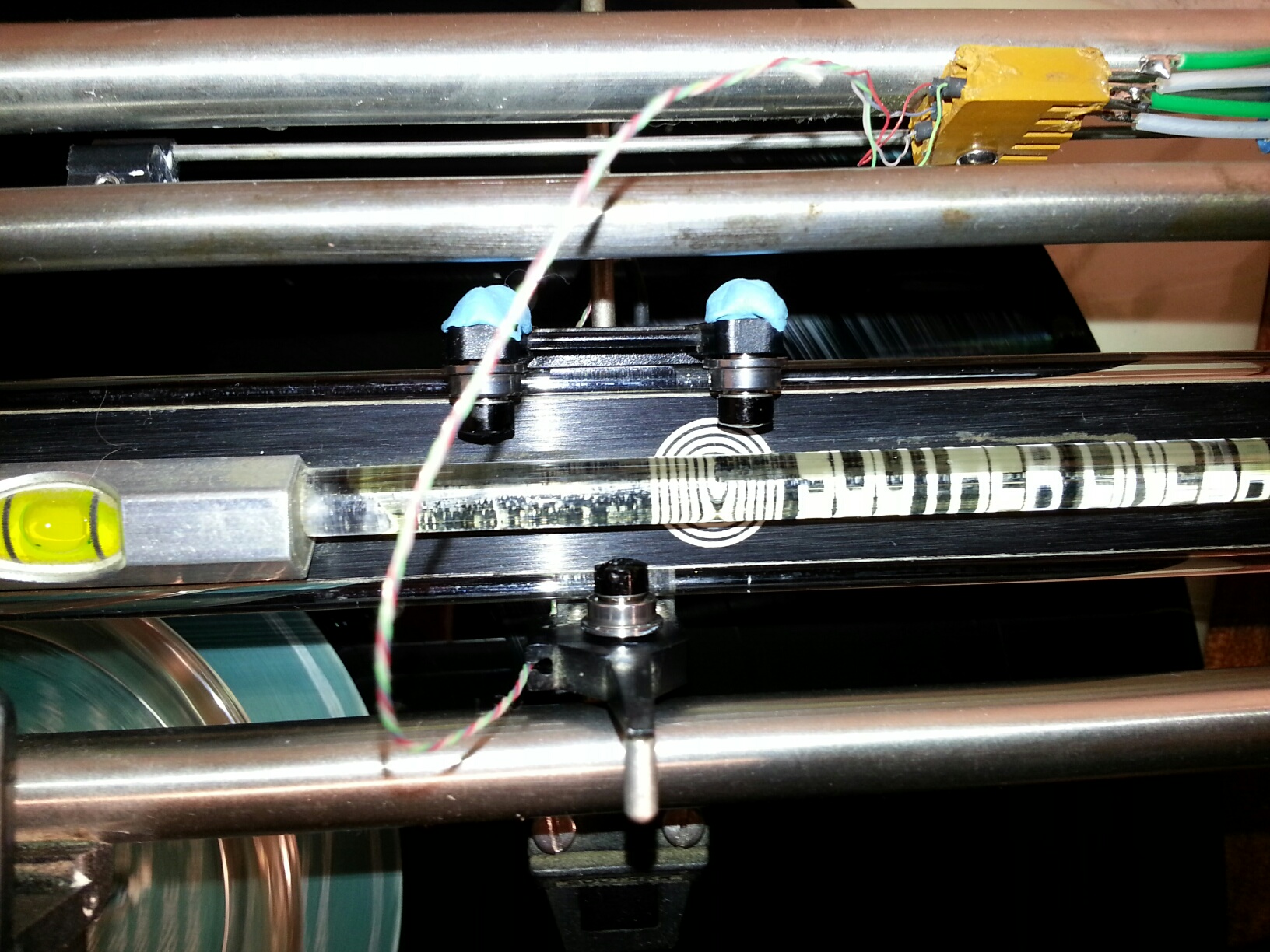

I replaced the bearings last week and so far so good, it is noticeably quieter in operation now.
I have stuck two little blobs of blue tack behind the rear bearings, looks stupid, but it seems to be doing something positive. I have no explanation but it sounds more coherent, it almost seems like the noise floor dropped. Probably deluding myself, but since it looks stupid I took it off and ended up putting it back.
All I can say is it is getting a lot more use than the other arm/cartridge combination.
Waiting on some parts and a cartridge for the other arm and I will perform the same surgery on the other table...

The litz wiring should be longer and looped higher so its influence is out of question.

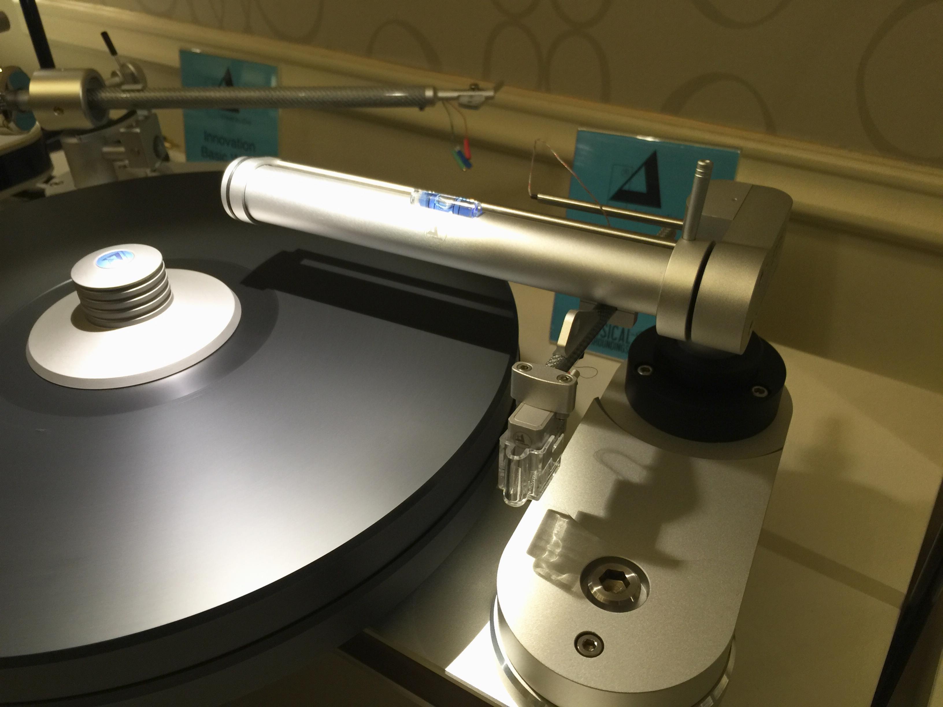

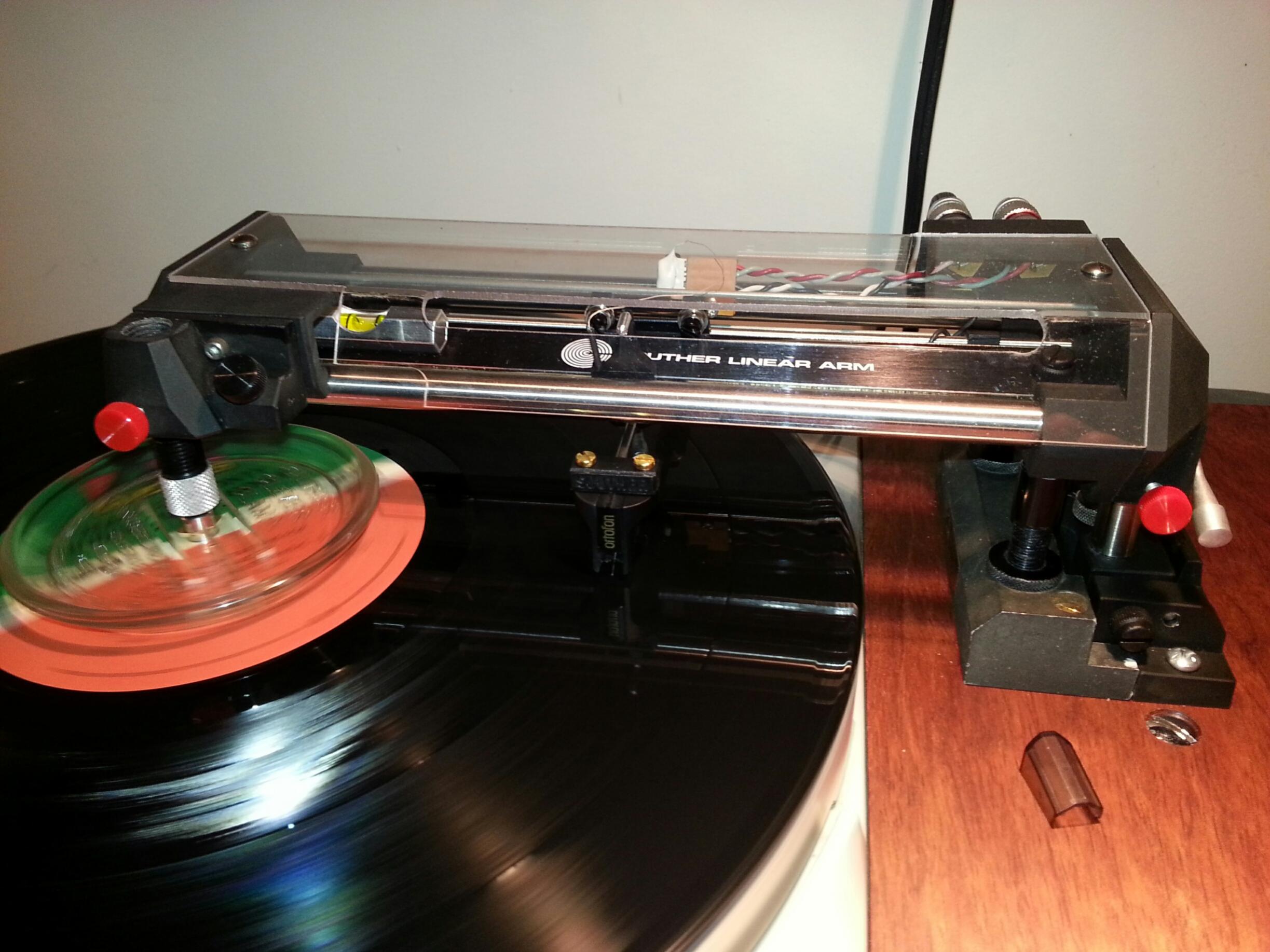

At CES in Jan. Clear audio had a spin off the Souther on there cheaper versions with added weight on the shaft and a considerable headschell mass that bolts to the cartridge directly.
Grabbing the headschell and checking how loose the 90 degree integrity to bearing wiggle was , I was rather alarmed at how sloppy it felt.
The added mass I concluded was to counteract this loose feel in operation.
The last thing you want is the pivot point of the cartridge,s shaft to wander with the tracking ability of the cartridge assembly platform while moving across the record
I will post a pic of the mass (probably seen it on their most expensive versions) added that must counteract what seems obvious from here
There exsists no perfect bearing that won,t add some low frequency component thru that rail system connected to the platter shaft-this must go asp!

The litz tonearm wiring is a bit longer than it appears, but would benefit from being a bit longer. Placement is critical, the way the wire is currently oriented results in the carriage travel twisting the wire near the connector block rather than pushing on the wire which so far has greatly reduced the skipping I initially experienced.. I hope eventually to find a good source for the right kind of wire and make some new longer tonearm cables.

I haven't seen the inexpensive CA arm at a show yet, hopefully I will get to check one out at Son et Image next month.

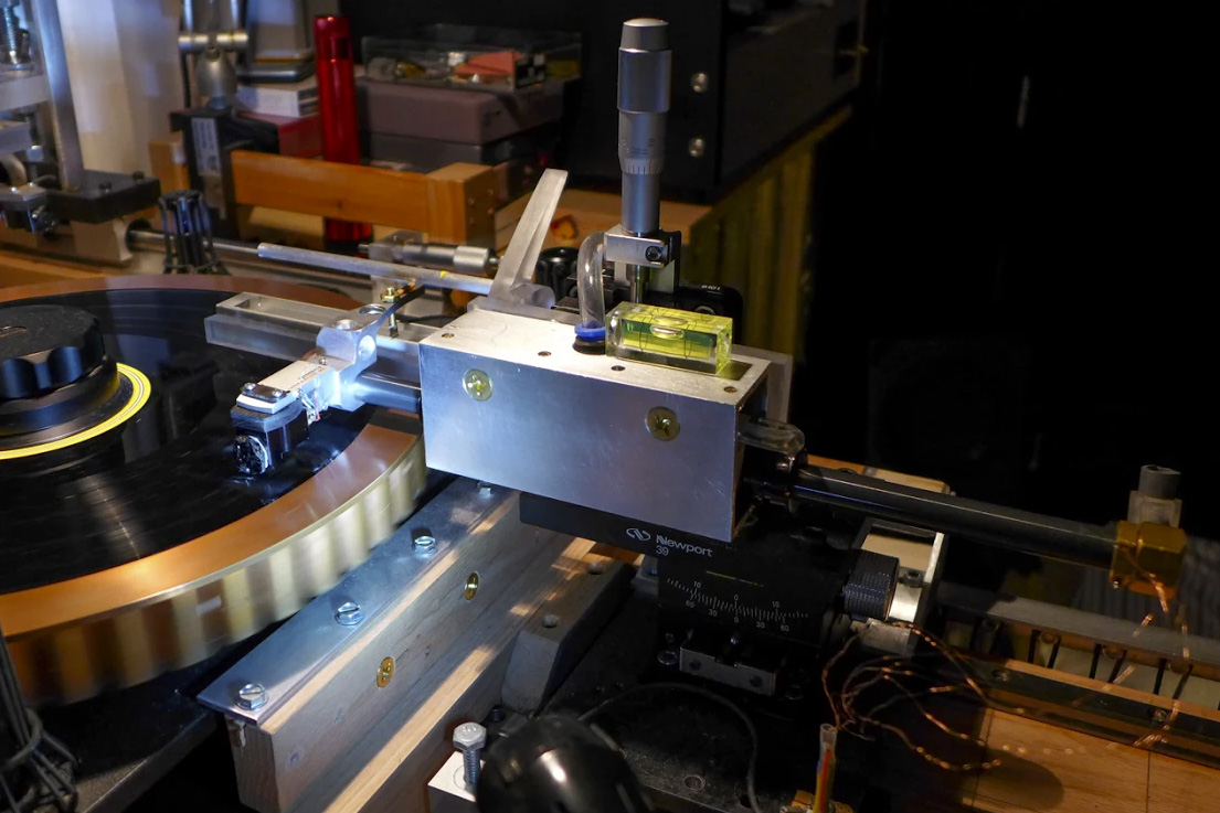

Nice arm Super! I will be experimenting with all sorts of things as I have time and get my hands on stuff.

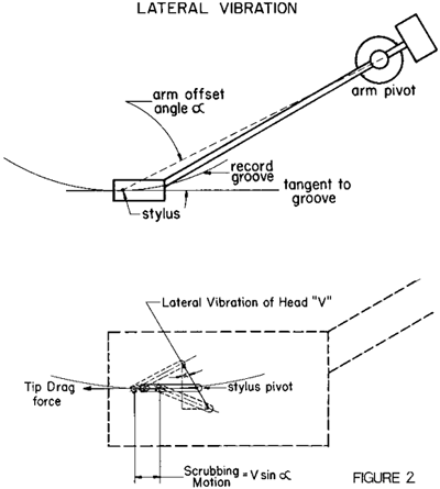

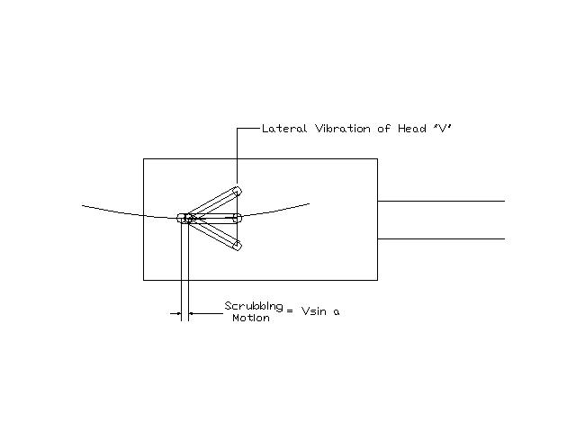

An advantage that the linear arm has is relative immunity from scrubbing along the groove during horizontal plane disturbances compared to an offset arm. Scrubbing is related to offset angle. A 12" arm is better than a 9" arm in this regard, and a linear arm fares best.

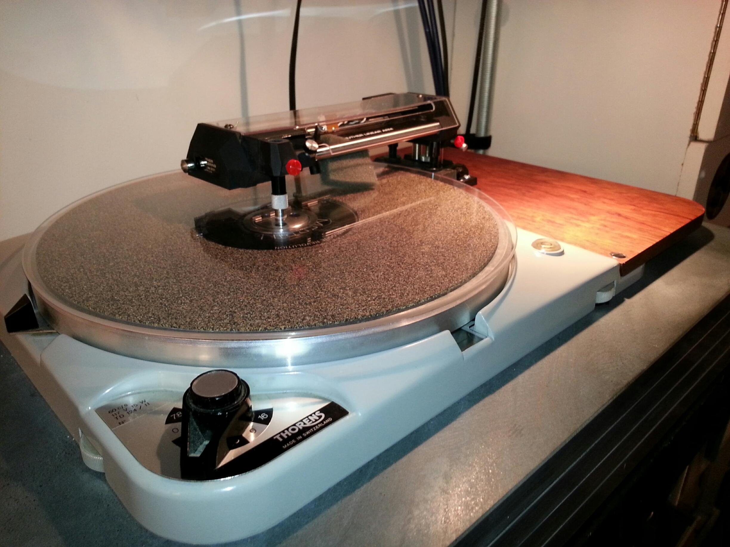

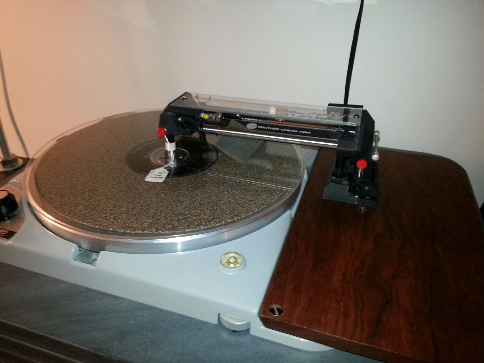

The oversized armboard arrived a few days ago at the same time as my newly acquired low hours Ortofon Windfeld. I hope to get things installed and set up over the next couple of days, in the mean time a picture...

The center rod is just to stiffen the plate.. The bearings are exactly as described in the patents and run on cylindrical quartz rods. The bearing outer races are flat, there is a flange at the rear of each bearing that keeps the carriage from running off the rods. The optics in my cell phone camera probably conspire against a better picture, but I will try. You can certainly see the effects of 30yrs+ of use on the rods and elsewhere. I try hard to keep the rods and races as clean as possible, wipe downs with swabs is frequent. I am at this point not having many issues with the arm, it works quite well in general, and I am rather pleased with the resulting sound. There are some issues still to address, the rubber washers used in place of the perished rubber pads perhaps need to be revisited.

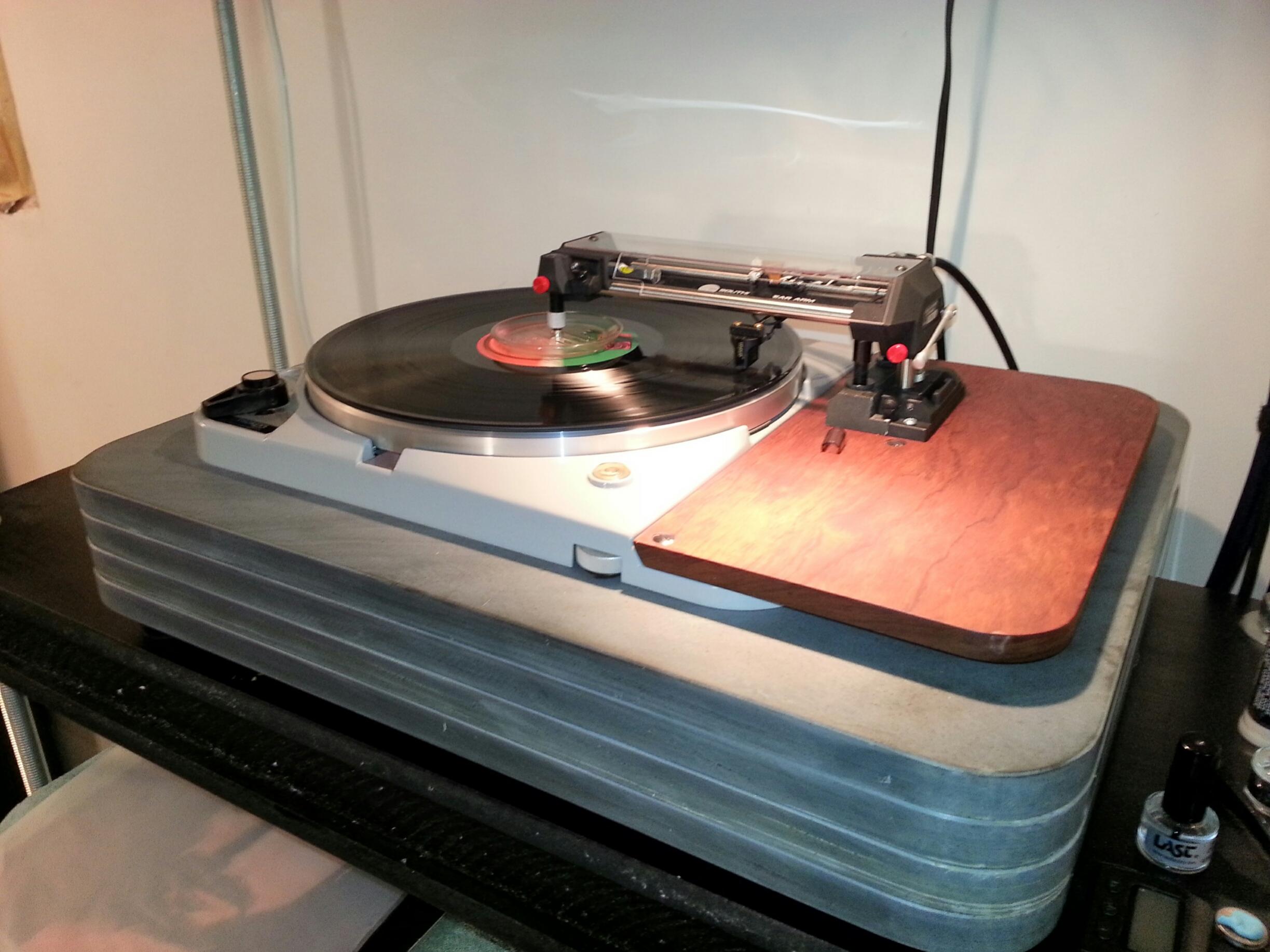

The new arm is mounted on the TD-124 MKII, I think the armboard is a bit ridiculous and I guess I could have used a standard sized one instead. Live and learn.
The arm is self supporting and despite appearances is not resting on the spindle.
I have some adjustments to make and then I will install the cartridge (a used windfeld) sometime later today or tomorrow.
The original cables are all in working order so I will use them initially with the arm completely stock.
