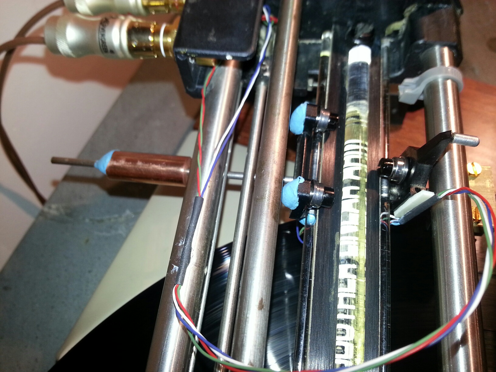

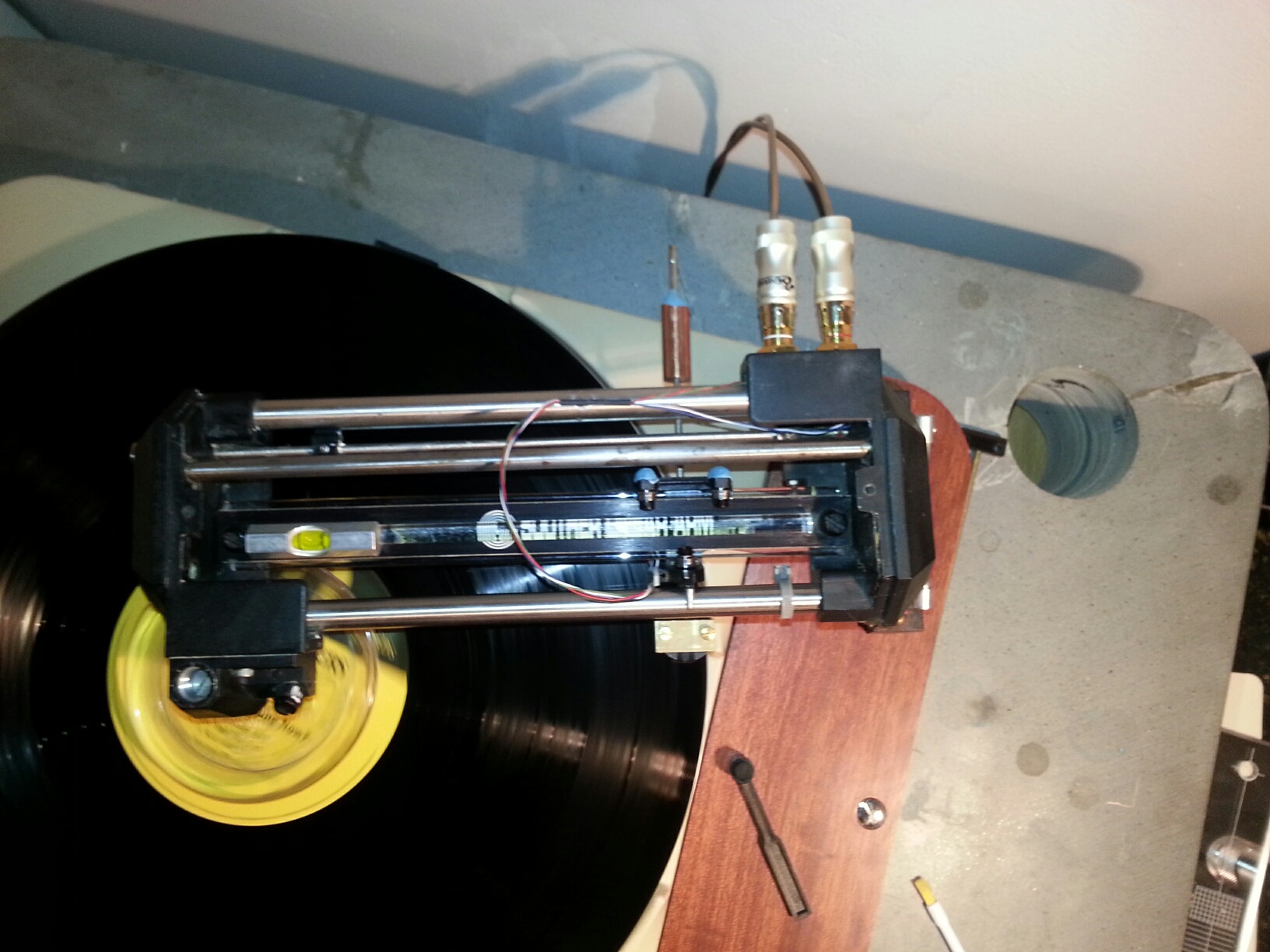

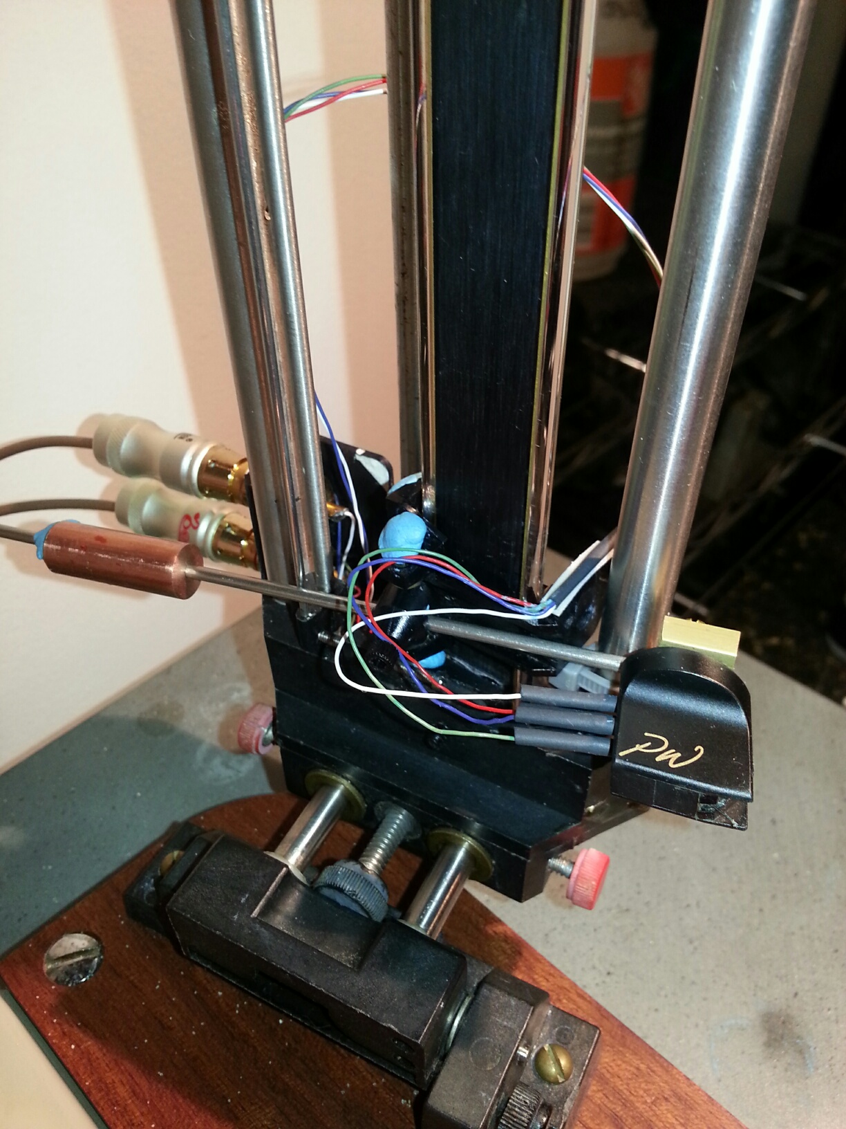

I attempted my first counter weight in tellurium copper tonight, things did not go according plan at all. I panicked our pet rabbits with machining noise, and to top it off the first weight was ruined by the bit breaking off due to my failure to clear the debris frequently enough when center drilling on the lathe. The second one was a success in that I drilled all the way through without breaking the bit, but this rank amateur machinist somehow drilled a hole that started at the center on one side and ended off center at the other - the hole is straight as an arrow, but I thought I had the work well centered in the chuck of the lathe. I am not sure how I did not break the second bit given the eccentricity.
The new weight is just a prototype, unlike the wand I don't consider this to be a quite good enough. I have not drilled it for a set screw as I figure this will result in another disaster.. LOL
It came in at 14.67gms which is within a reasonable distance of 14 - 15gms deemed reasonable. Total arm mass with cartridge and this counterweight is still around 43gms which seems to about the minimum the Windfeld will tolerate. I think there is some improvement over the stock collection of Souther weights, but it is subtle, I think a slight improvement in focus is how I would describe. The Windfeld remains extremely fussy, but is now sounding quite promising.

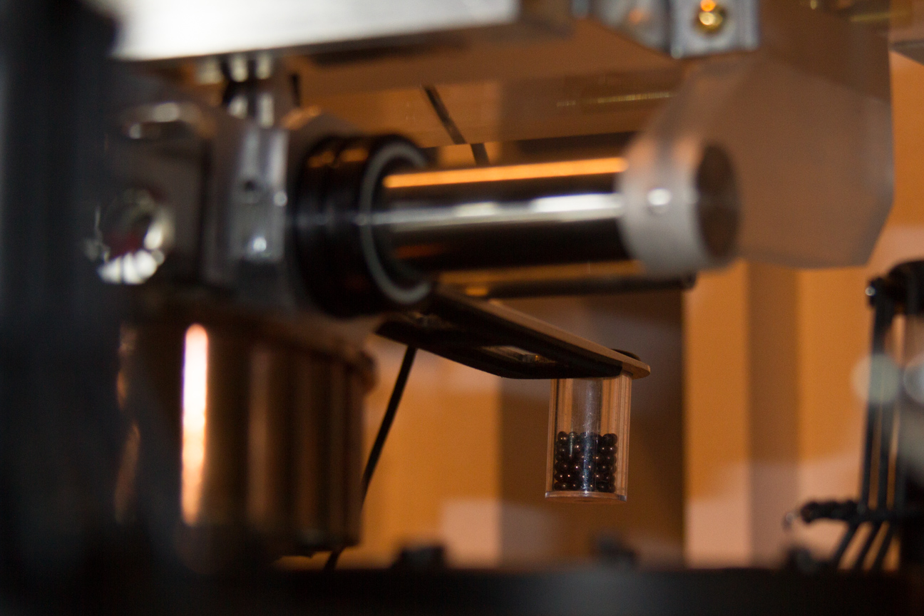

If you don't want extra weight which will add to total mass, you may make counter weight same as my air bearing arm's counter weight. Each lead shot is .5 g. I have way enough lead shots. If you want some, just drop me a note. I will be traveling tomorrow and will send to you once I get back. I would suggest that counter weight should be slightly lower than the record surface.

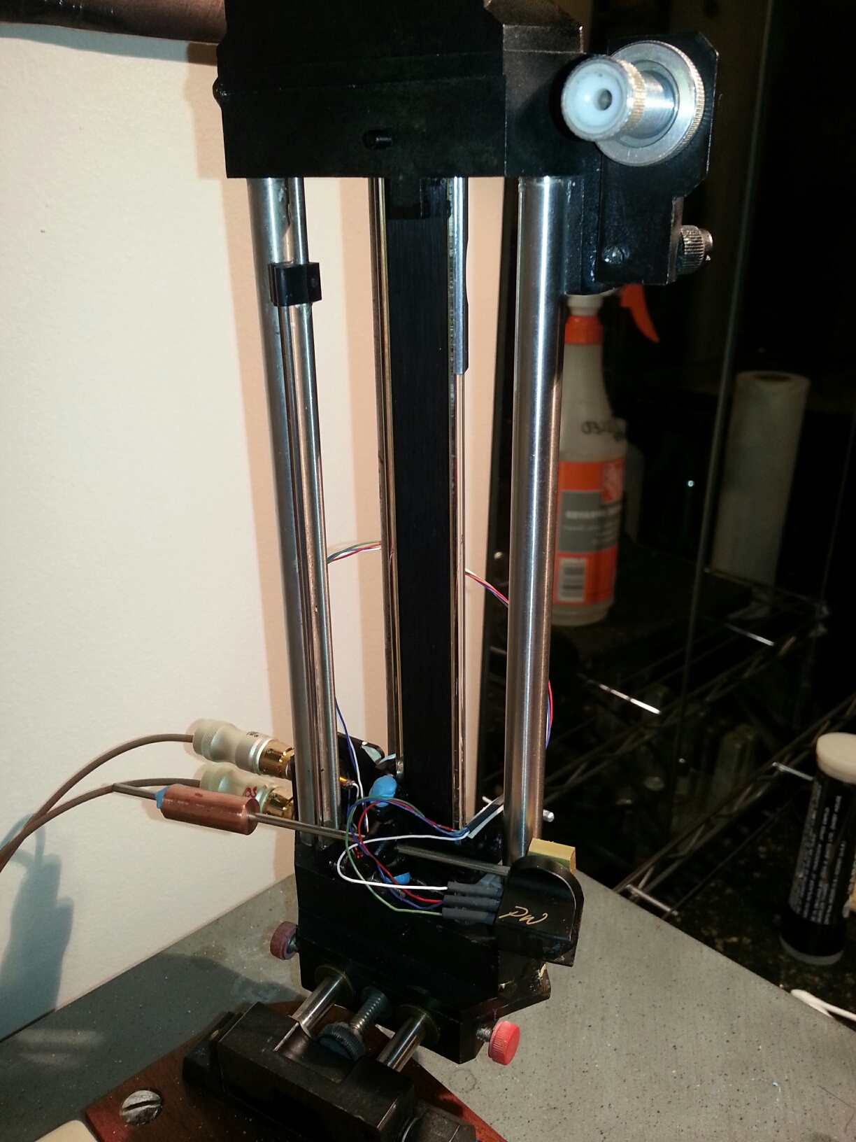

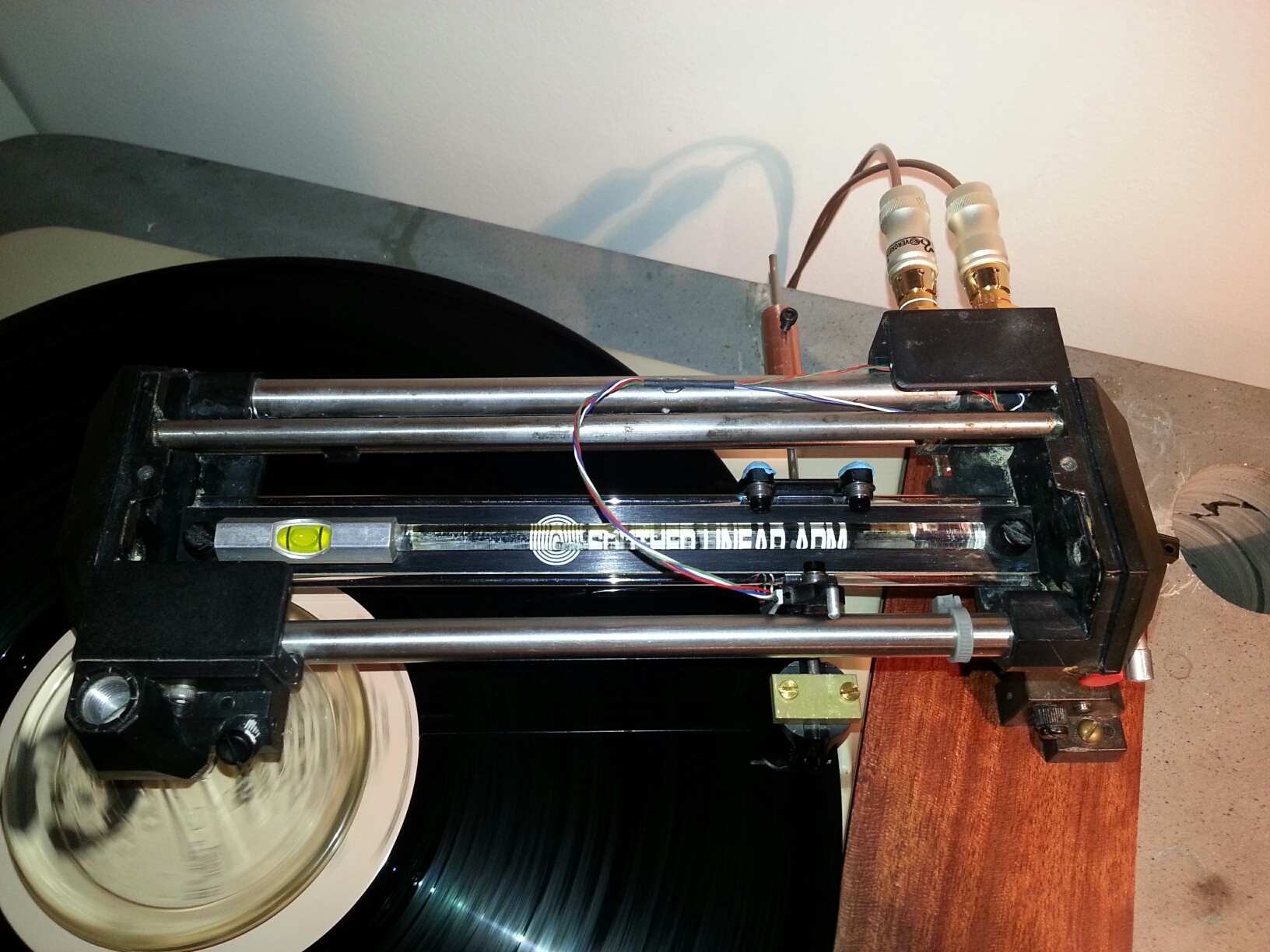

Something to bear in mind when I start to work on my own arm.. The counterweight spends most of its time over the record surface so although I have thought about placing the counter weight off center so that more of the mass is below the wand I have not attempted to make such a weight yet.
The total arm mass sans cartridge is under 15gms, the counter weights are 2, 4, 8 and 14 so far. I have determined that the ideal mass for the Windfeld is > 40gms and the heavier counter weight gets me into that range and also allows me to place it closer to the pivot to reduce inertia effects in the vertical plane.
The wand is about 6.25" long from forward end of shell to tail, most of the length is behind the vertical pivot, so completely backwards compared to pivoted arms and most air bearing and the newer CA LTA arms as well.
I made them because I have this compelling desire to make the Windfeld work on one of these arms.. 😱 I seem to be succeeding.

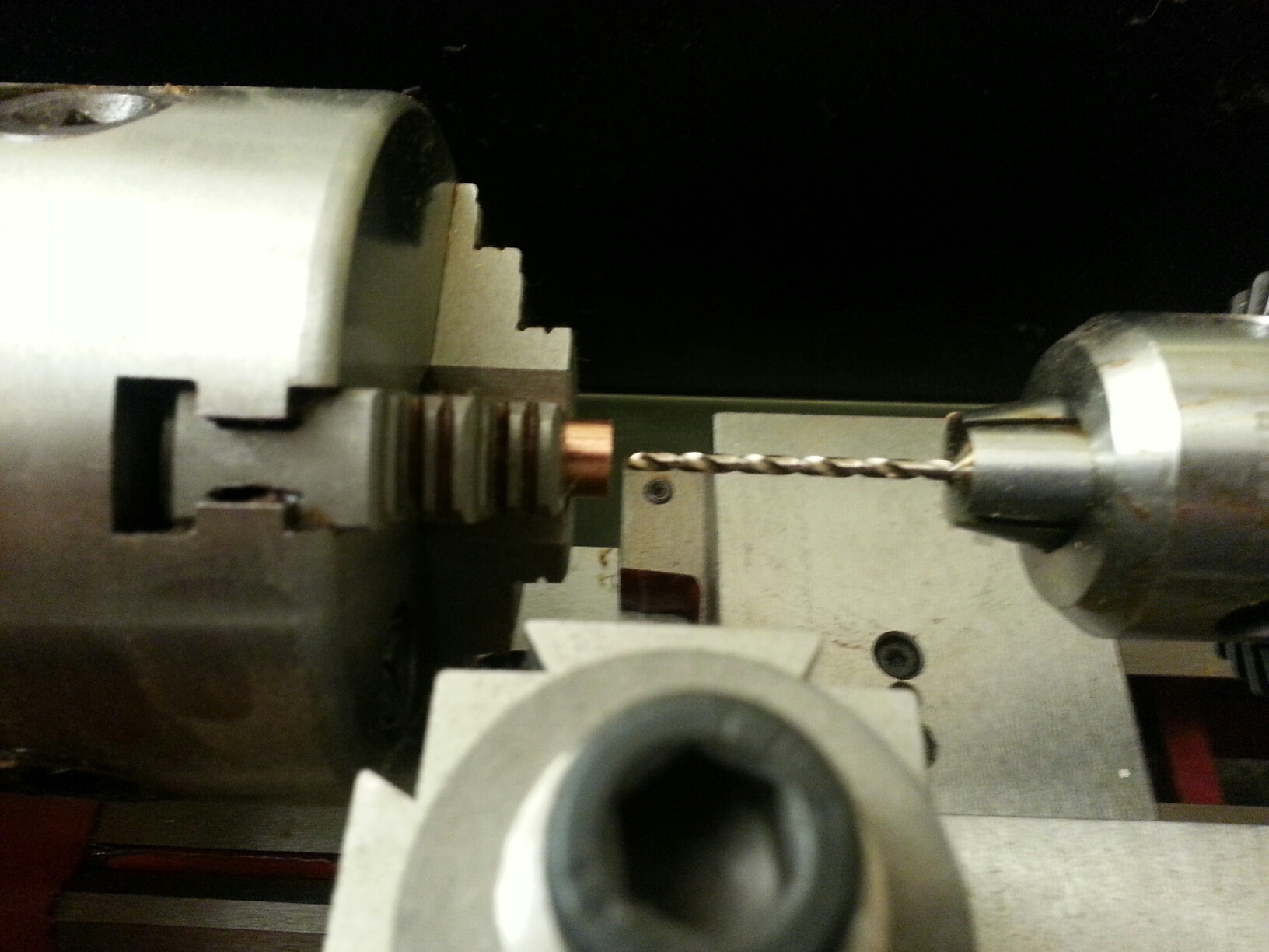

Hi Kevin.
I think I know why the hole you drilled went adrift and how to prevent it from doing so again. Did you use a centre drill before attempting to drill through the rod?
Without using one of these first the long drill bits tip will skate across the surface of the workpiece, flexing along its length, until it bites and starts drilling. The point where it starts drilling will not be perfectly centred causing the hole formed to slant. As you drill deeper the flexing becomes more severe which is why the first drill snapped. Just drill in a little way at a time then back of to clear the swarf. Use of a cutting lubricant also helps. One last thing to check, are the lathe chuck and tail stock chucks both perfectly aligned? If it's a budget minilathe you can be pretty sure that straight out of the box they won't be.
I hope this helps.
On the subject of where the counterweight should be relative to the record surface.
Ideally the vertical centre of mass of the whole arm, including cartridge and counterweight, should be about level with the vertical PIVOT, not the record surface. Locating the com here minimizes tracking force variations due to warps. The use of an underslung counterweight on a souther would pull the com way below the vertical pivot causing tracking force to increase whilst navigating a warps. Having the centre of mass just below the pivot can help arm stability. Looking at the souther it looks like the com will be about perfect with the counterweight you've made. Of course try an underslung counterweight as well and listen.
Ideally the vertical pivot should be level with the record surface in order to minimize warp wow.
The centre of mass should only be level with the record surface if the vertical pivot is also level with the record surface. Due to the shortness of the souther arm the pivot has to be above the record so the centre of mass has to be above the record also.
The sonic advantages of using a very short arm more than outweighs the disadvantage of not being able to have centre of mass, vertical pivot and record surface all on the same plane. These disadvantages can be reduced by the use of a well designed record clamp that flattens the record reducing warps and therefore reducing warp induced tracking force variations and warp wow.

Hi Niffy,
I didn't use a center drill, and will need to check to see if I have one in the right size range. (Didn't occur to me - the danger of being a newbie.. lol)
I did use cutting oil, and I quickly figured out to take my time and back the drill out and clear out the swarf every couple of seconds.
I was surprised how it started off quite well centered and ended up off center at the exit point on the work piece, but it works and reasonably well.
You've confirmed my suspicions about the location of the counter weight and filled in some gaps in my knowledge while doing it.. 😀 So thank you!

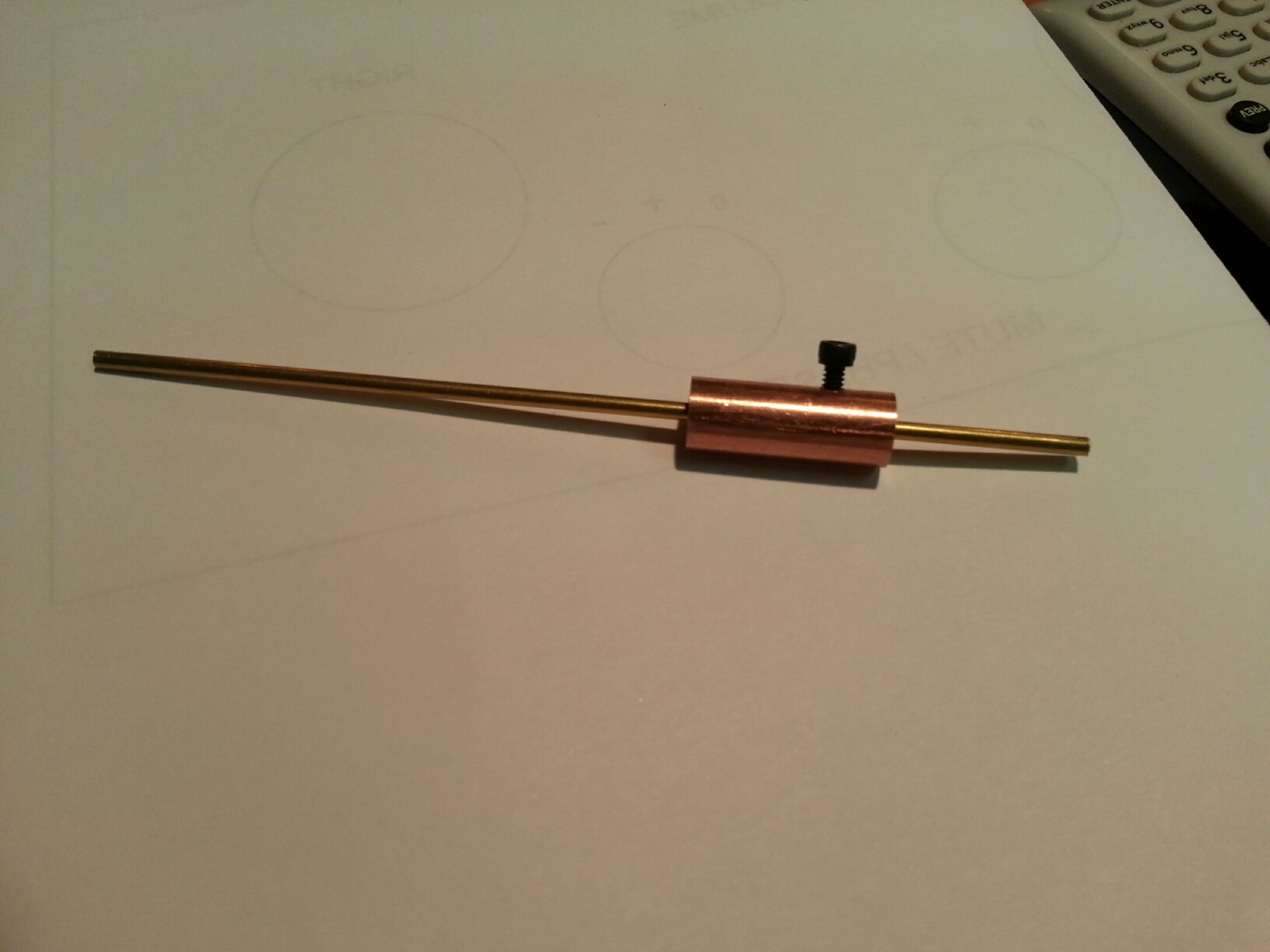

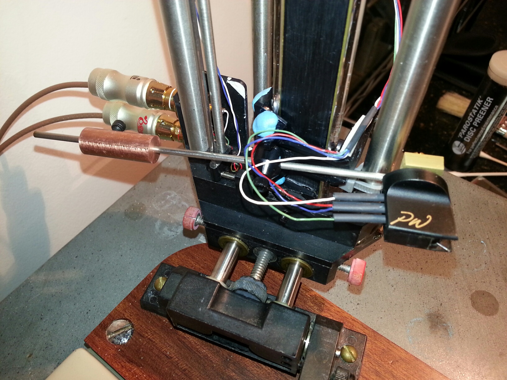

Counter Weight Success
Thanks to the input of several friends I successfully completed my first decent counter weight this afternoon. I'm pretty stoked.. LOL
For the many guys here who are crackerjack machinists feel free to laugh! I took all of the advice about dubbing bits, dimpled the work piece, and took my time drilling the center hole, backing out the bit every time I took a tiny cut of material. It went without incident. I then jigged the part in my milling vise and used the mill to drill a hole for the set screw, and then finished by tapping it.
Perhaps the biggest surprise to me is that I seem to have sufficient patience. I guess getting old does have some compensations. I might even be good at this some day.
These skills will come in handy over time.

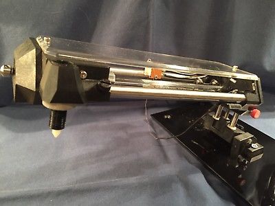

Hello Souther SLA-3 Linear Tracking Tonearm fans,
This Souther tri-quartz just sold for $717. I noticed that the spindle locator is different. Instead of a plastic cap that rides on top of the spindle this one is pointed. Has anyone had any experience using this type of locator?
David
PS Kevin, any updates on your Souther - Thorens 124 combo?
