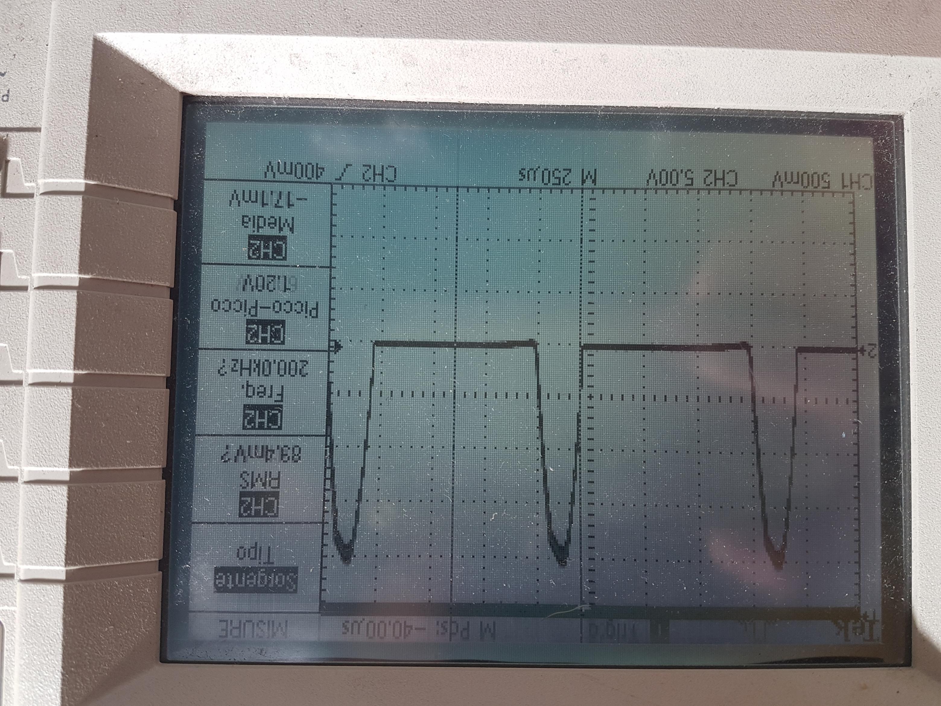

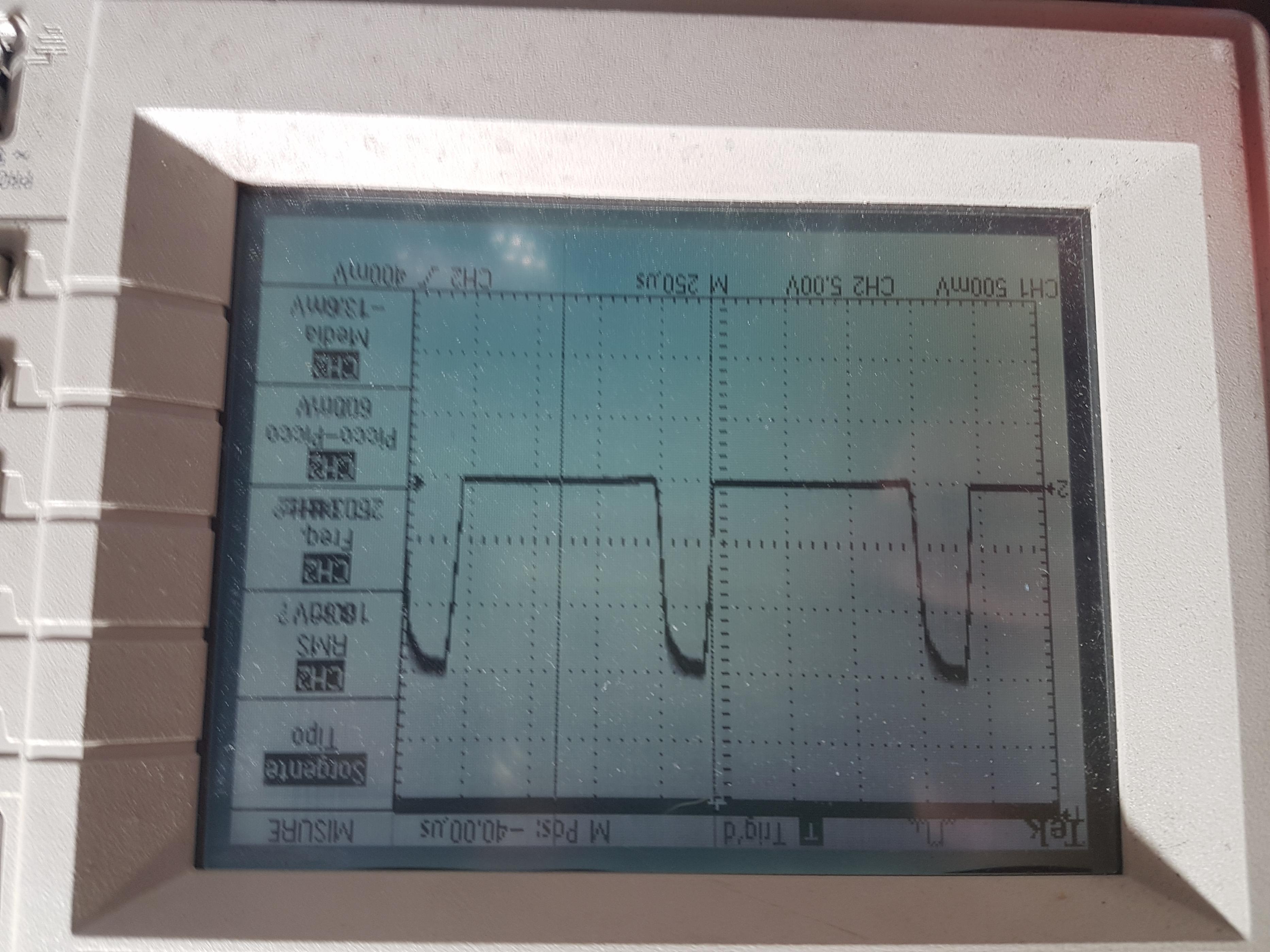

If you drive a strong signal into the amp, do the channels that pop mute to the same level (before end of mute delay) as the quiet channels?
This would best be done by monitoring with a scope with no load since a signal strong enough to be useful will likely drive the amp into hard clipping when the muting ends.
Without load? I have 4.4ohm resistive load, don't is better?
There is no need to load the outputs.
I have tryed.
With 3v input and ampli gain to max, on the "pop" channel i have 15V level output, on the good channel i have 20V level output
The output are semi-sine wave, positive

With 2.5v input, i have on the "pop" channel semi-sine wave with 2v level, on the good channel 0vIf you reduce the level, does the good channel always have more signal than the noisy channel?

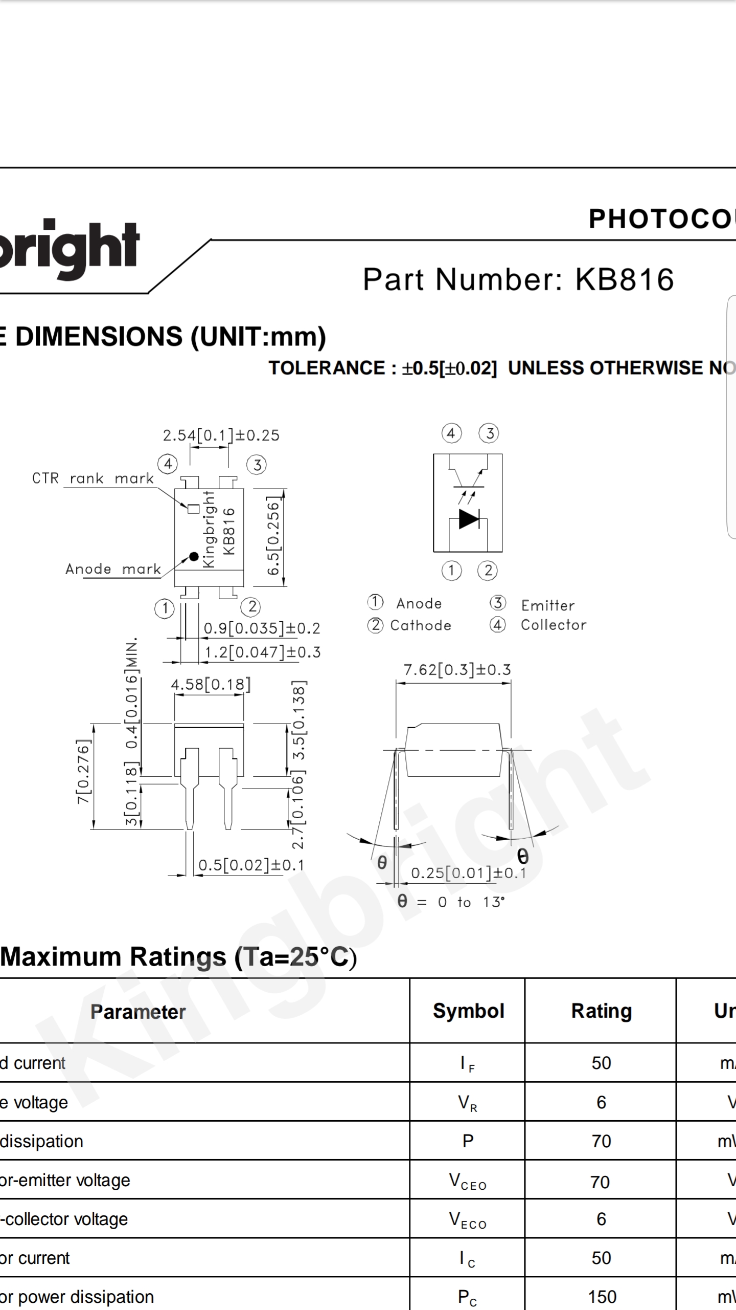

Short terminals 1 and 2 of the optocoupler. Leave the amp off 5-6 minutes (long enough for no pop).
With the optocoupler shorted, does any channel pop?

Terminal 1 and 2 or 3 and 4? Find optocoupler pinout in attached
i can lift pin 1 and 2 of optocoupler, it's the same?1 and 2 across the LED to prevent it from being switched on.
