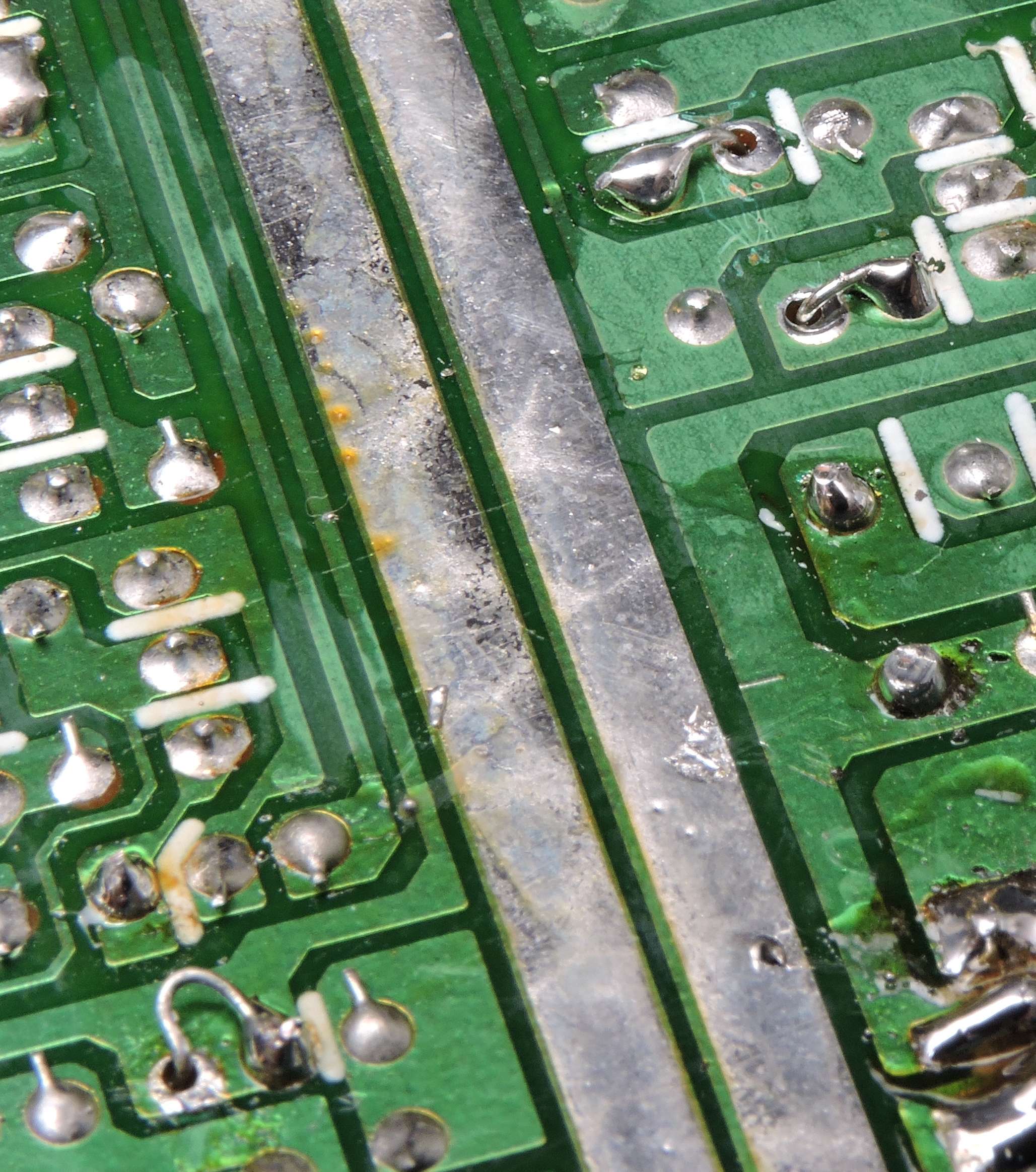

I have one soundstream 5 channel with a problem. First was in protection, the problem found on upper welding, now work, but on channel 1-2 have a power-on pop..
I have tried:
- isolated preamp= same pop
- exchanged with channel 3-4 all transistors and capacitors= same pop
This pop don't is always the same, sometimes is little, sometimes more bigger, not damage the speakers, but is udible.
What do you think?

OK. Thanks for the photo.
This appears to be one of the awful board designs. Is this a double-sided board with no vias?
yes, exactly..
i have soldered all vias on the top and the bottom, this has solved protection mode, but not the pop.
i have other lil wonder amplifier, 2 channel and 4 channel but without power on pop...
Soldering top and bottom is only a temporary solution, as it was from the factory.
To make it reliable, solder the top normally then use a short length of wire (or the leg from a new component that you install) to connect to a point on the bottom that's connected to the same trace. Do not solder the bottom pad where there is solder on top. See attached.

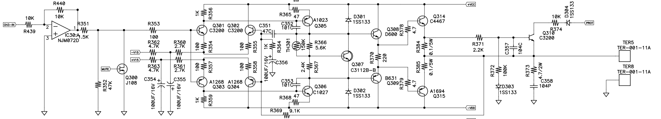

What are they using for muting?
Some of the older SS amps used a delay in the CCS of the differential amplifier of each channel.
Maybe... how can i check?
I found this (see attached). Does it have any J108 or J111 transistors?
If you can't find any jfets, we'll look into the CCS type muting circuit.
Exactly, i have find this muting jfet but no found.
Have you CCS type muting similar schematic for example?
Find the 4 differential amplifier transistors in each channel. They will have their emitters connected to 100 ohm resistors. Measure the DC voltage across those resistors before and after the mute delay. Does that voltage change.
Ok, i have found. I have measured voltage on this resistor. Is the same (approximatly) on all 4 channel. 0.01~0.09v without remote input, and when i turn on the amplifier, after 5sec i have 0.6v.
The drive circuit is the same for all channel (central optoisolator)
Are the op-amps in the amp or out of the amp, at this time?
Ah this time op-amp in the amp
