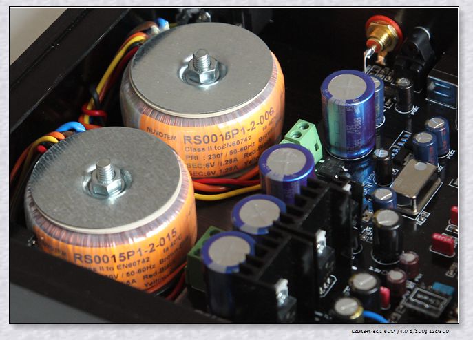

Ok, you eventually persuaded me. This isn't the exact model I had however the board looks quite similar --->
https://gd3.alicdn.com/imgextra/i3/13795664/T2svEFXQxXXXXXXXXX_!!13795664.jpg
The model I had is not listed there now, however it seems like the L9018A3 gold MCU软控 is their current best version of the 9018 ? --

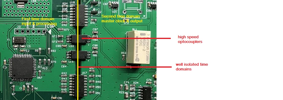

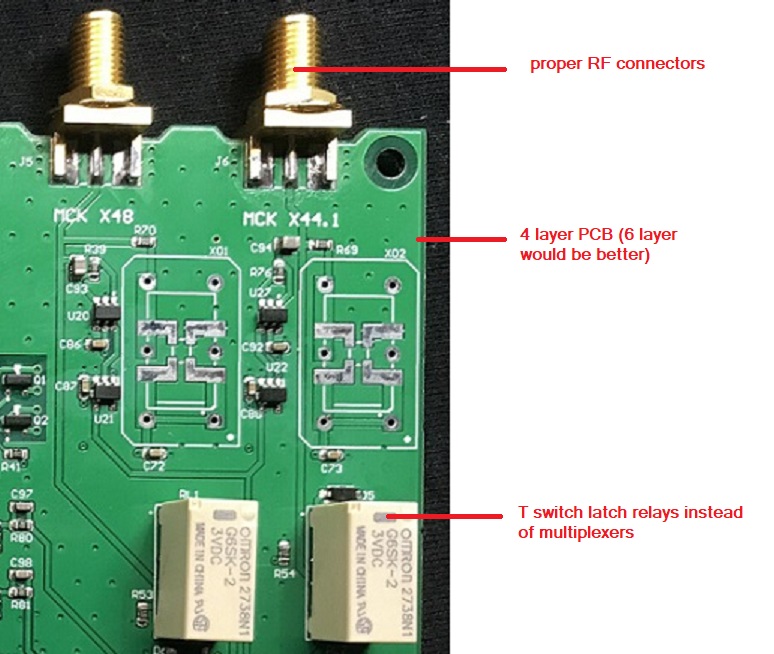

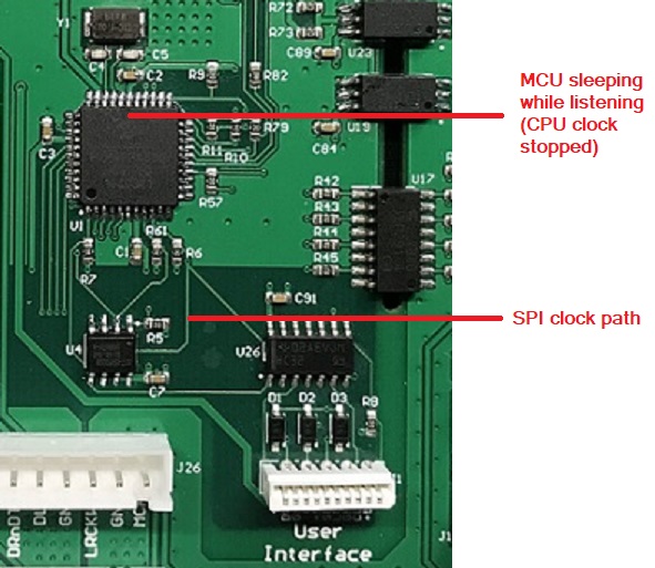

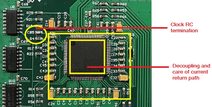

Just a few useful precautions.
And this is the Lite version, higher version will be 6 layers PCB and time domains isolated by optic fiber cables.
To complicate a little the RF scenario the design involves MCU, FPGA and Windows programming.
