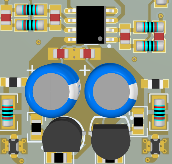

That depends: if the layout and decoupling are good, then the resulting performance will be a good representation of what the opamp can do, and I'm interested.
Otherwise, "how it sounds" is really "how it interacts with a particular non-optimum layout" so that provides little information about the opamp. If it sounds and measures good with a really bad layout, it can give information that the opamp is tolerant about these things, which is nice.
For example, here's an opamp layout that works:
- Both rails have 10µF MLCCs on the same side of the opamp connected to GND plane at the same point to avoid injecting distorted supply current into the ground plane through the caps
- Same for electrolytic caps
- Same for TL431's
- No ringing
On that board there was only one opamp, so it got its own personal power supply. But if there were a lot of them, I'd add a few resistors to dampen resonance between the decoupling MLCCs, that's all.

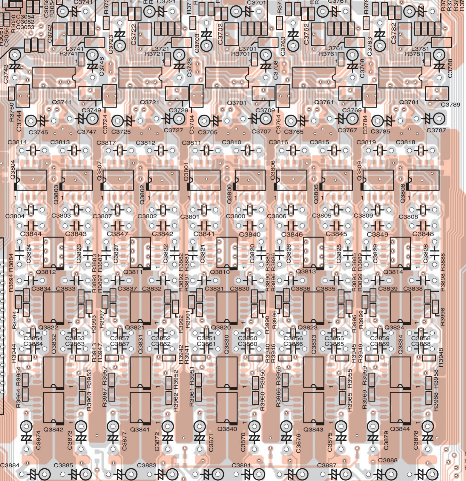

For example, if you listen to Onkyo TX-NR-905 which uses PCM1792:
You would conclude that it sucks. But that's not the fault of PCM1792, it's the board, the whole design is an abomination, everything is wrong from the SPDIF input connector to the output RCA.

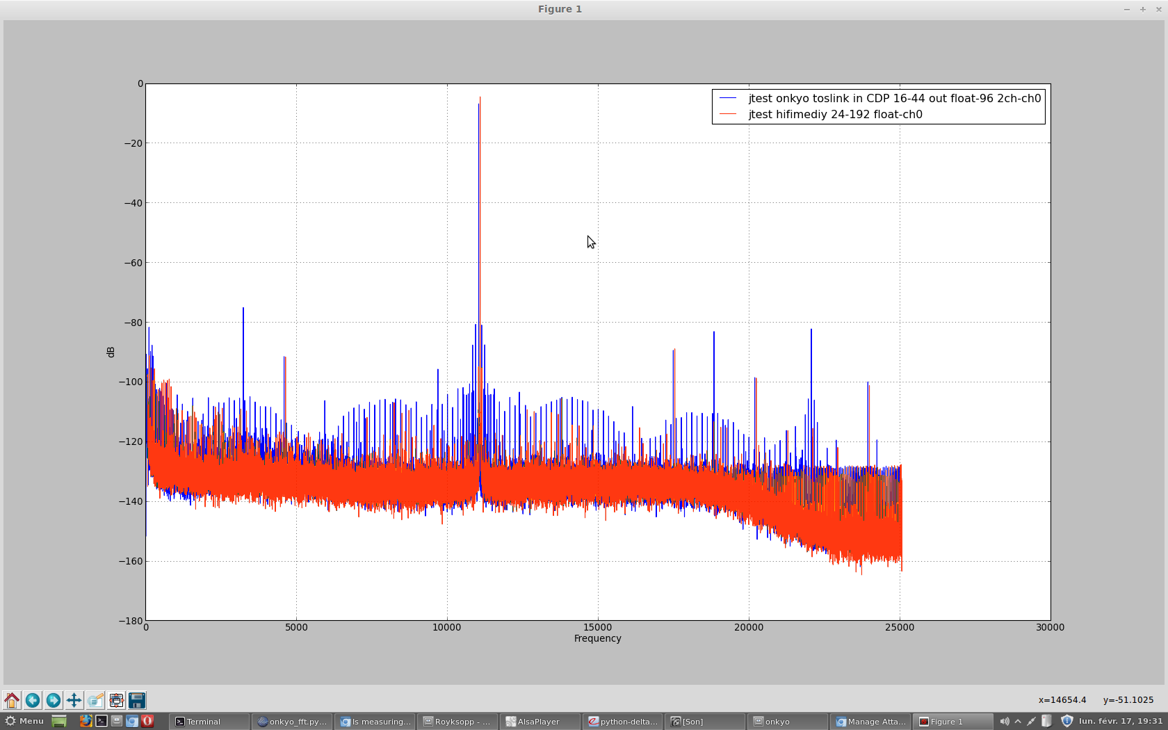

And since there is the word "measurement" in the topic...
I'm sure Andrea will like this jitter plot lol.

It's interesting the famous company Onkyo with high-tech designers can make such a terrible design of a DAC with terrible measurement as well, it just shows that these audio companies including Onkyo are just normal people like us =)
Yeah, I was surprised, it's the flagship model, expensive DAC chips, and there is no ground plane on this DAC board. 2 layers only. Tons of HF noise anywhere I stuck a scope probe.
