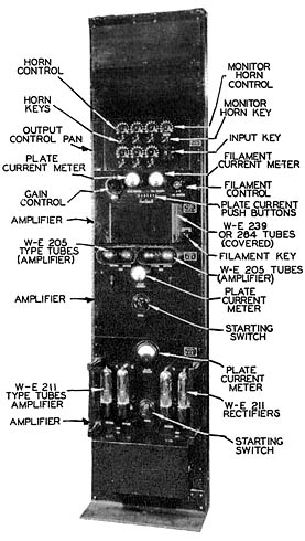

regarding WE amp on pic - there was that exact category from Yore - amps called ........ huh, can't recall :rofl:
anyway - booster amps, intended for augmenting Sissy one , but most of them had both current and voltage gain
so , F4 is modern Booster amp, original or crippled (that would be Front End-less) :rofl:
