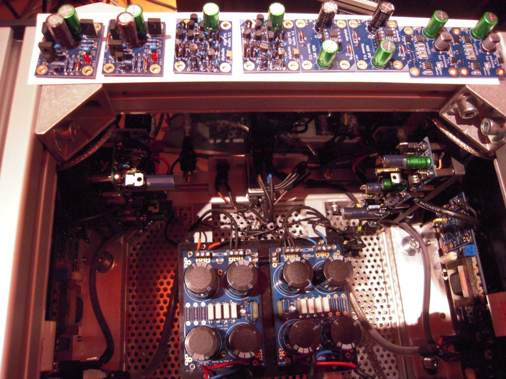

believe it or not, in this moment just 3 functional ones - Papa's Koan (F4), DEFiSIT (Papa's Koan xxx) and SissySIT
box full with finished channel pcbs removed from my T-Beds
not counting several pet amps (factory) on shelves
trying not to count few I must make, Kudos reasons; most important one Real McKay Singing Bush monoblocks
ZM Omnispoiled Omniungrateful Omnibrat
