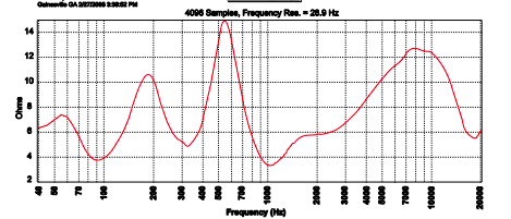

Hi folks -
I've posted this before, in the F7 thread and in another (non-Pass) forum, and it is the impedance plot of my speakers. They are identified as nominal 4-ohm speakers, with a sensitivity of 100db ("2.83 Volts into rated Z, at 1 meter"). I use these in a small room, and the next time I listen at 95db will also be the first time.
I've been casting about for an idea about appropriate amplifiers for these, and I'm wondering, is this a picture of what is referred to as a difficult load? Are there, given the sensitivity, both voltage and current demands that I should be paying attention to?
I'm using an M2X now, and have boards/parts on hand for the Aleph J, the F6, two versions of the F4, the original M2, the F7, the M25/SissySIT, the J2, and I have the Singing Bush on order from ZM. (I know, I know.)
Finally, the M2X is the only Pass amp that I've actually completed, and it's PP. Any SE amps that would be appropriate?
TIA - Pat
TIA - Pat

Thanks, Nelson. Maybe the Burning Amp in SE, or I'll try out this Aleph J that people seem to like. A lot.

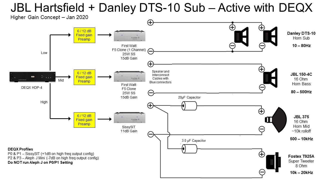

You guys are right about the crossover, however. Some day there'll be DSP solution, and I'll have to build three Pass amps to implement it.
Look at DEQX as a possibility for a DSP solution. It is simply amazing.

If a EQ gears want not to ruin what are injected in the sota class A amp, one should consider only EQ in the FIR domain, so between the streamer and the dac in digital domain. Take the best amp and a wasted source and the best amp will be wasted ressources.
