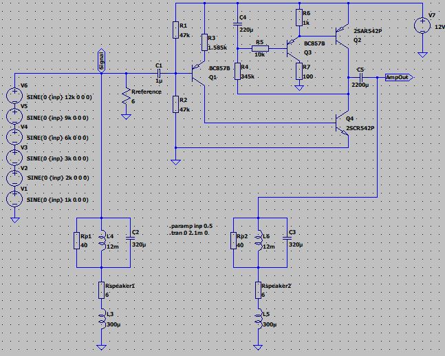

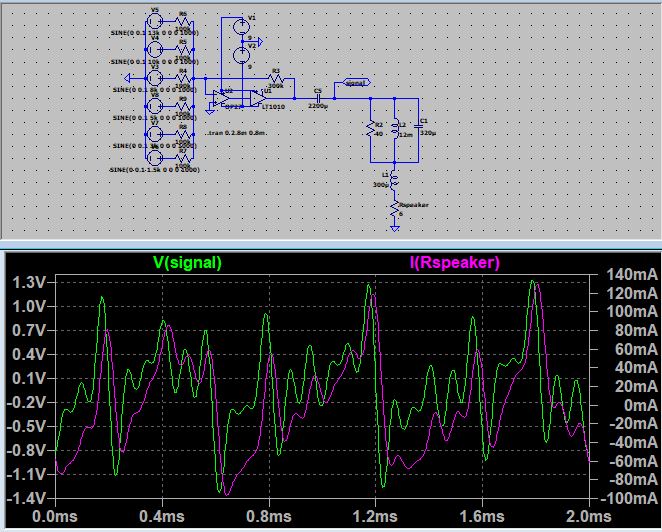

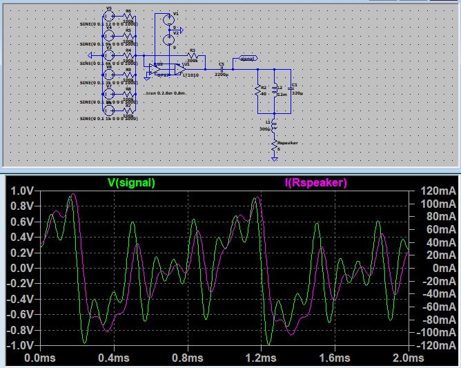

Just add the 2200uF cap at lt1010 output and simulate again ...Actually, this situation is understandable if you remember the relationship between voltage and current of inductance.
http://hyperphysics.phy-astr.gsu.edu/hbase/electric/indtra.html
At first quickly, but then more and more slowly, the current approaches its nominal value. If the voltage has changed before the current reaches its nominal value, it is then too late to reach that value. A new goal is set... which again is not achieved because the voltage changes again in the meantime etc. This is where the half-finished current flow comes from. This applies to all voltage amplifiers, regardless of whether they are called HiFi or High End.
By the way, you can still catch Make Magazin 4/2023 (until September 28, 2023). Take a photo of the circuit on page 91 and recreate it. The sound won't disappoint you 😉

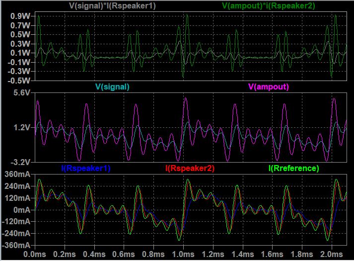

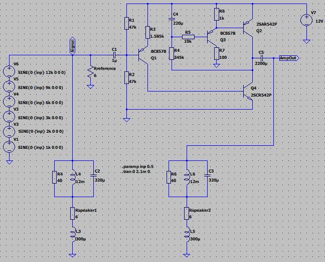

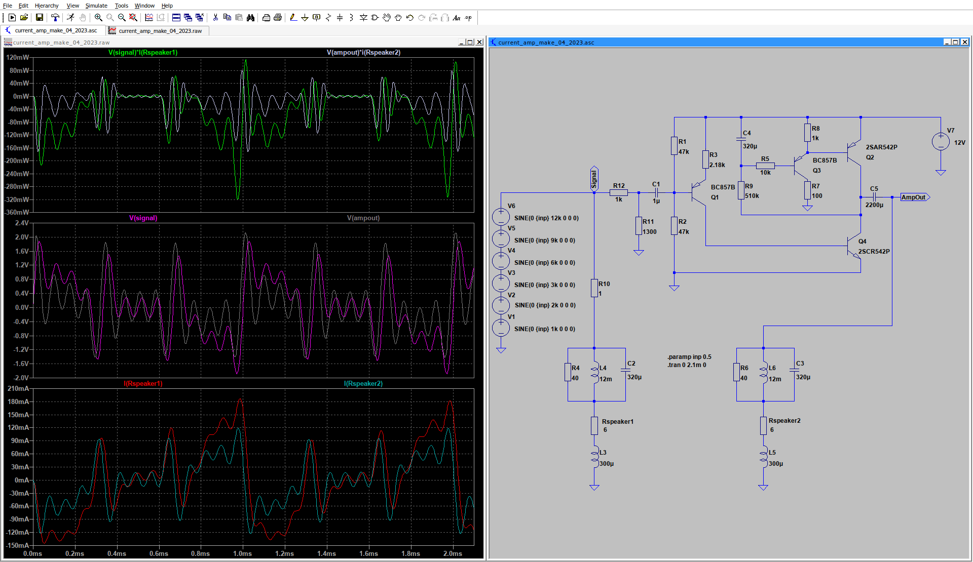

My initial quote was because the waveforms of post #117 2nd picture have looked too identically. Attached a simulation reduced to the max.
I've added also the power results of the voltage amplifier which shows also interesting data. The simulation starts at time 0 to see the initial transient response too
Have fun, Toni
Have fun, Toni
This is the phenomenon that blew me away right from the start when I tried out the circuit for the first time: at low powers the amplifier just sounds too perfect. You don't want to turn up the volume (good for the neighbors 😴).
It appears that the current amplifier heats up the speaker less.
Well, I can take that statement back. You have adjusted the output amplitudes of the voltage with the voltage divider R11/(R11+R12). Therefore, the absolute values of the power are no longer directly comparable.
I thought about how the adjustment of the simulated measurements should be done. So I introduced the "Rreference" resistor. The current through this resistor is supposed to indicate the target current. I also adjusted the amplifier for a 6 ohm load, new values: R3 = 1.585k, R4 = 345k.
