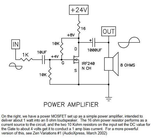

This is the basic building block. There are several of them in every NP amplifier. For example, instead of Rd, NP uses current sources that are basically constructed in the same way. Look here, pages 8 and 9: https://firstwatt.com/pdf/prod_f5_man.pdf

CCS makes all the differece. Simulating variants with Rd is misleading.This is the basic building block. There are several of them in every NP amplifier. For example, instead of Rd, NP uses current sources that are basically constructed in the same way. Look here, pages 8 and 9: https://firstwatt.com/pdf/prod_f5_man.pdf

The BJT amplifiers are more efficient. The saturation voltage is usually less than 2V. For positive and negative sides it is a total of 4V taken away from the AC output voltage. For linear operation of the MOSFETs, Vd must not be less than Vgs, and the latter is in the range of 4V to 7V. Doubled it is 8V to 14V, which should be taken away from the AC output voltage. Of course you can drive the MOSFETs to full power, but in this case you need a strong global negative feedback to keep THD small.
Even in NP circuit the difference between Vd = +8V and Vgs = +4V is 4V. And +/-4V is just 1 watt on 8 ohms.

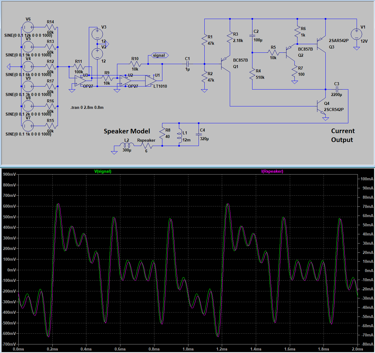

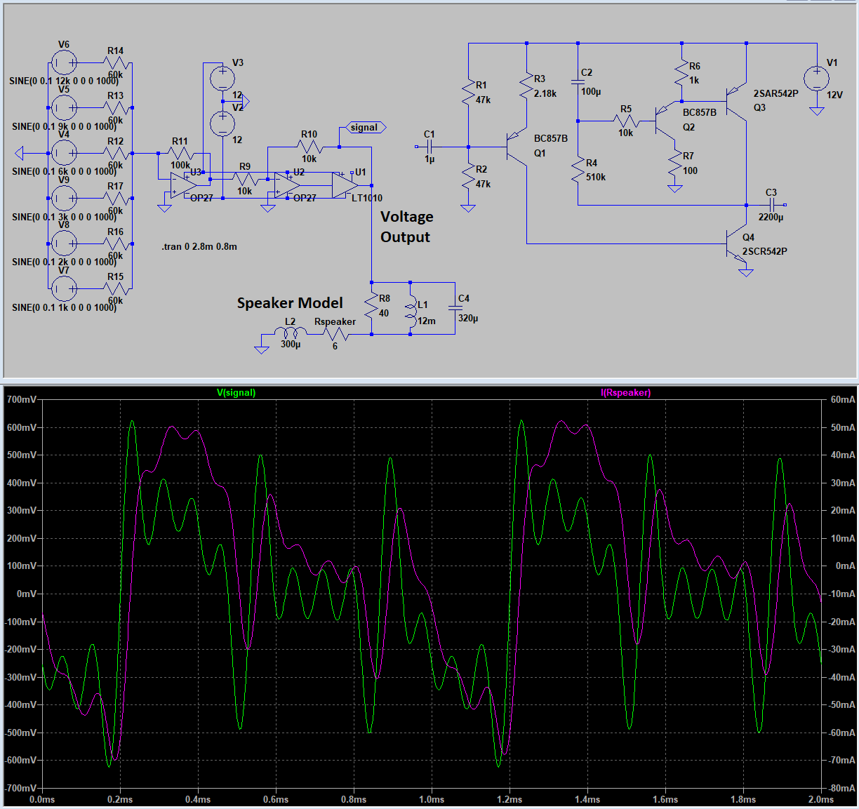

I'll try to show it with the simulations. Six sine signals with the same amplitude but with different frequencies (1kHz, 2kHz, 3kHz, 6kHz, 9kHz, 12kHz) are added and amplified. The simulation of the voltage amplifier together with the speaker model:
You can see the deformation of the current signal through the speaker. In my opinion, this is just as bad as the big THD. But tube amplifiers are only partly voltage amplifiers. They partly power the speakers with electricity. I don't do a simulation with the tube amp, but with my current amp to show the effect of driving with the current:

LT1010 isn't able to drive your simulated speakers low impedance. Maybe you see the current limiter in action.

According to the datasheet, LT1010 can deliver +/- 150 mA continuous. Meanwhile, the maximum current of 52 mA flows through the speaker. In addition, the voltage at the loaded output of LT1010 is measured. I see a nicely curved voltage curve. There are no flat areas. In this case LT1010 does its job perfectly.
Actually, this situation is understandable if you remember the relationship between voltage and current of inductance.
http://hyperphysics.phy-astr.gsu.edu/hbase/electric/indtra.html
At first quickly, but then more and more slowly, the current approaches its nominal value. If the voltage has changed before the current reaches its nominal value, it is then too late to reach that value. A new goal is set... which again is not achieved because the voltage changes again in the meantime etc. This is where the half-finished current flow comes from. This applies to all voltage amplifiers, regardless of whether they are called HiFi or High End.
